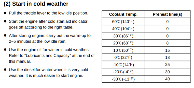

I am following this as I have an XR4150 and the light stays on longer if it is colder. Summer on a second or two. Yesterday, about 10 seconds. Hard to believe they would take that out of a newer tractor to save a few cents.
I think your seeing the difference between ECU controlled preheat and the older timer circuit on the MT225.
   / Cold Weather Pre-heat and other questions #12
@mred2, They haven't on my MT240, this is from the manual and seems accurate as far as I can tell with my moderate (30's F) temps.
Interesting little chart. Going to time my XR3135 to see if it works the same way.
   / Cold Weather Pre-heat and other questions #13
My 2013 pre-emission Engine , The plugs are on a timer, doesn't matter what the temperature is. I don't know how long, guess I should time it sometime! ;)

The ECU checks the engine temp before startup to determine how long to keep the glow plugs on for. The colder the engine, the longer the glow plugs need to stay on. The longer, obviously, the warmer. But how warm does it really need to be inside that combustion chamber? Not very, but warm enough. And the ECU expects that you will command the engine to start RIGHT as the glow plug light goes out.
I experienced a cold start recently (before the recent engine heater install). It was cold out, like 12*F. I turned the key warming the glow plugs, while I waited, I pushed in the clutch and locked it, and then realized I forgot a new roll of paper towels I use to check the engine oil. (I typically keep a roll of paper towels inside the cab for checking the oil). I ran into the garage and grabbed a roll, checked the oil, reached in and cranked the key. But by that time, the glow plugs shut off and the combustion chambers quickly cooled. When I started it up, it was rough! It took several seconds to smooth out and run normal. I should have let the glow plugs fire again.

In short, the ECU ensures the glow plugs only run for the correct amount of time assuming you start the tractor (as you should) as soon as the light on the dash goes out.

One issue I have found with these "smart" glow plugs or intake manifold heaters,
when you use a block heater or any type of heater that warms up the water the heaters do not run.
Case in point it wasn't that cold this morning (12F) but the tractor was plugged in for about 4 hours before I started it.
When my tractor is cold the controller will run the intake heater for several seconds before the light clears and you can start it,
it also keeps the heater turned on for several seconds as the tractor runs, it makes for a nice smooth start.
This morning with the water warm it didn't want to run the heater, I cycled the key several times (4 or 5) and she started right up,
but it wasn't the nice smooth run it was a rough run for about 5 seconds before she smoothed out.
I have been telling myself to buy another temp sensor and wire in a double pole switch so I could select the water jacket or ambient temp for the heater control.

So with that, and my going out just to check the speed of my pre heat ON-OFF cycle with 30 degree temps in the shop, I noticed that the pre heat coil did stay on longer, so the ECU temp sensor is controlling the glow plug as it should and that there is nothing wrong with my 2020 year model pre heat circuit. So, as the dealer said, for colder temps, just cycle the pre heat several times and she will light right up...like one or two seconds on the starter.
