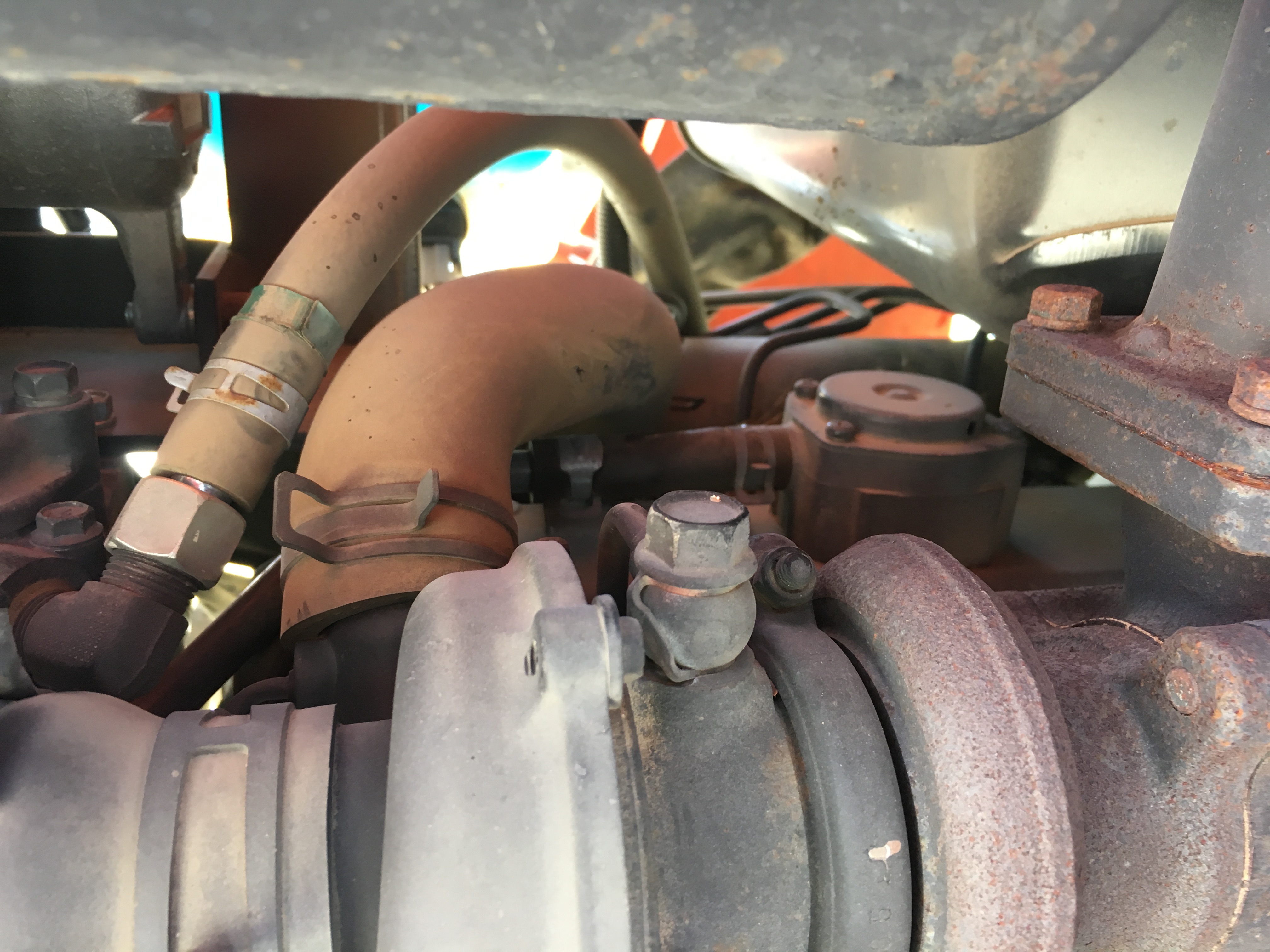

rScotty, I did have a chance to play around with my tractor. But I didn’t even go as far as removing the breather assembly and cleaning it out. Coming off of the breather, is about a three inch section of rubber hose. My hose was frozen solid. So instead of trying to gain access, I thought I might try and thaw it out first. I pulled the tractor outside, removed the oil fill cap to relieve any pressure (I did cover with a clean rag though) and started it up. I brought it up to about 3000 RPM, and let it sit outside for about 40 min. When I came back and checked on it, I had nothing sputtering out of the exhaust, and I even held a clean white rag up to it. I had no oil around the dipstick, and the rag that I covered the oil fill with was also pretty clean with just a few spatters. I checked the rubber hose coming off of the breather, and it was nice and pliable. I put the oil fill cap back in, and drove around for a bit, finally parking it over some white snow. I continued to let it run at an elevated RPM for another 10 min or so, and there was not one speck of oil on the snow. I will include a picture of that short rubber section of hose coming off of the breather. I will learn from this experience, and definitely run my engine at a high idle, if it has to sit for a bit in cold weather, and also, not run it for a short time in extreme cold weather, shut it off, and then try to run it again at idle. Maybe I will try a work around someday for freezing temps, that I can return to normal for above freezing temps the rest of the year.
