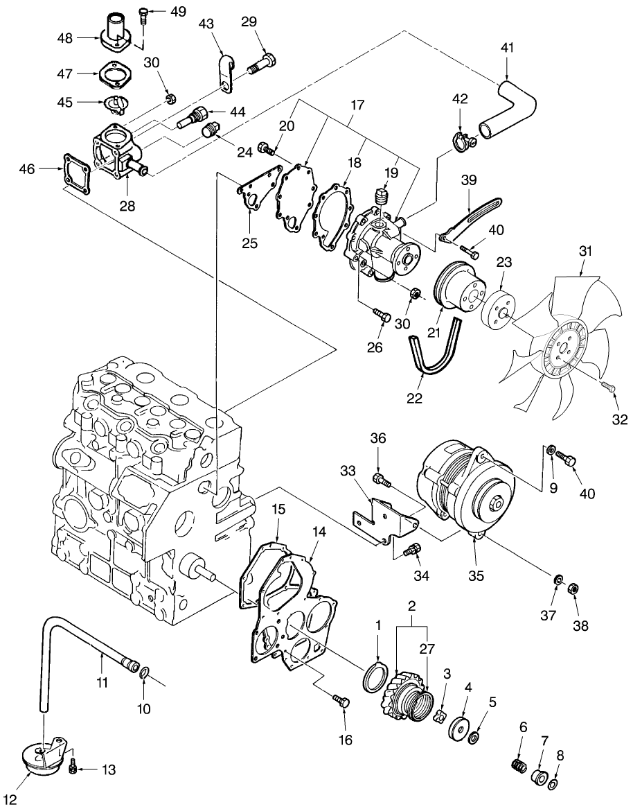

I've got a coolant leak which drips off of the oil pan. Checked hoses (ok). Can not see coolant coming from region of the water pump. The lower front corner of the block (right front) is wet. Stuck a endoscope camera in and around and can't tell where its coming from. Is there a freeze plug on the front of the block? And other ideas where the orgin may be
   / Collant dripping off oil pan 2008 TC30
#2
TC30 Engine exploded view.gif this is what I'm working from.
