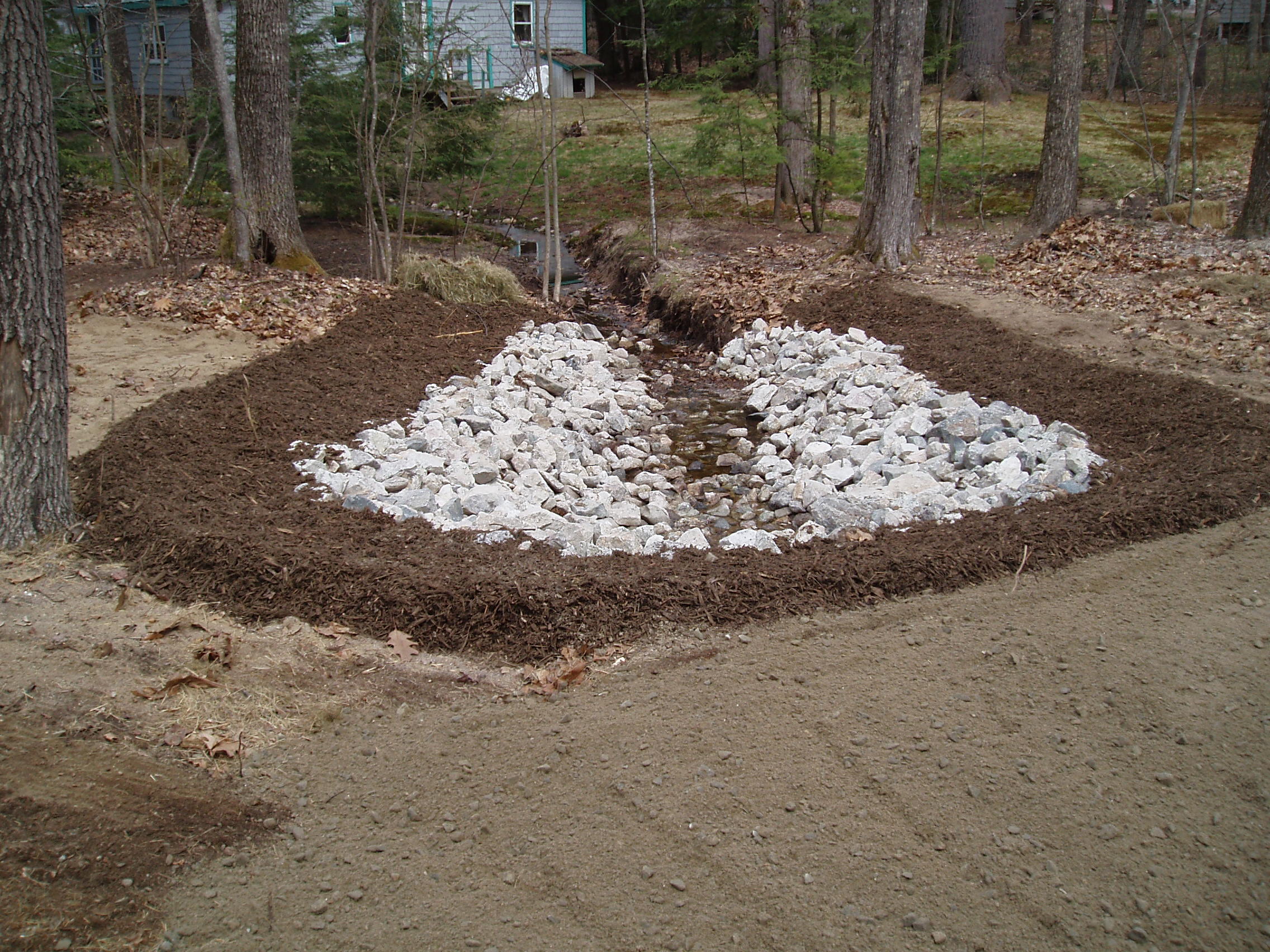

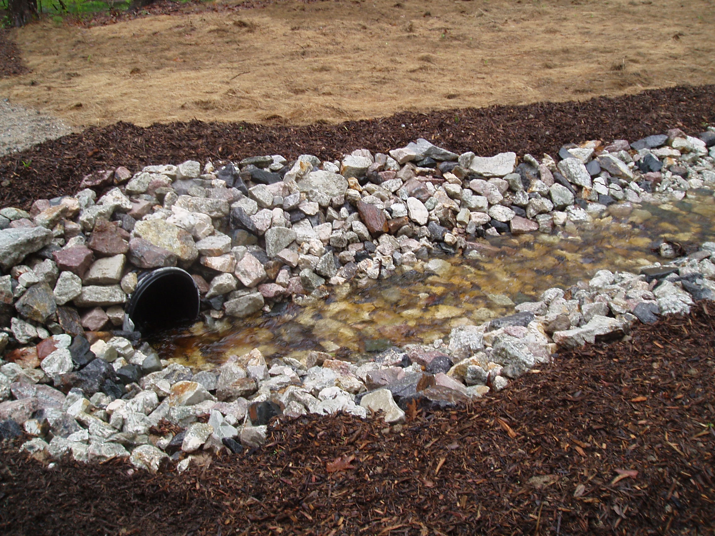

Be sure to create a catch basin on each end so that sediment settles out before entering the culvert. The more you can pool water and the less you let it run, the more infiltration you get and that will greatly reduce erosion.
overszd is right, dual wall culverts with smooth bore are the way to go. A smooth bore plastic will flow approximately 1/4-1/3 more water than a similar ribbed galvanized culvert.
Here's one I did but we couldn't get depth for a catch basin. Due to high flows, we rip-rapped heavily.

when you say creek, how big of a creek? does it flow all year or just in the wet seasons? How far is it from bank to bank? In my experience colverts are nothing but trouble especially when a creek is involved. Rip raf is good concrete is better for a head wall but even so it will haft to be rebuilt every so often.
