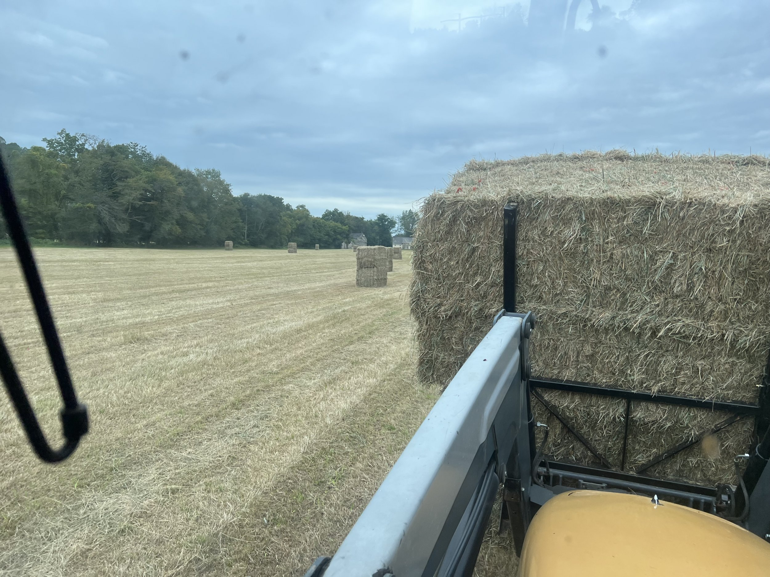

I can't envision the frustration a small rd hay baler operator would experience having to stop for wrapping every time a small bale is created. I get tired of stopping every time a 1000# bale needs wrapping/ejected from my rd baler
I got tired of the wrapping cycle altogether and switched to large square bales!
