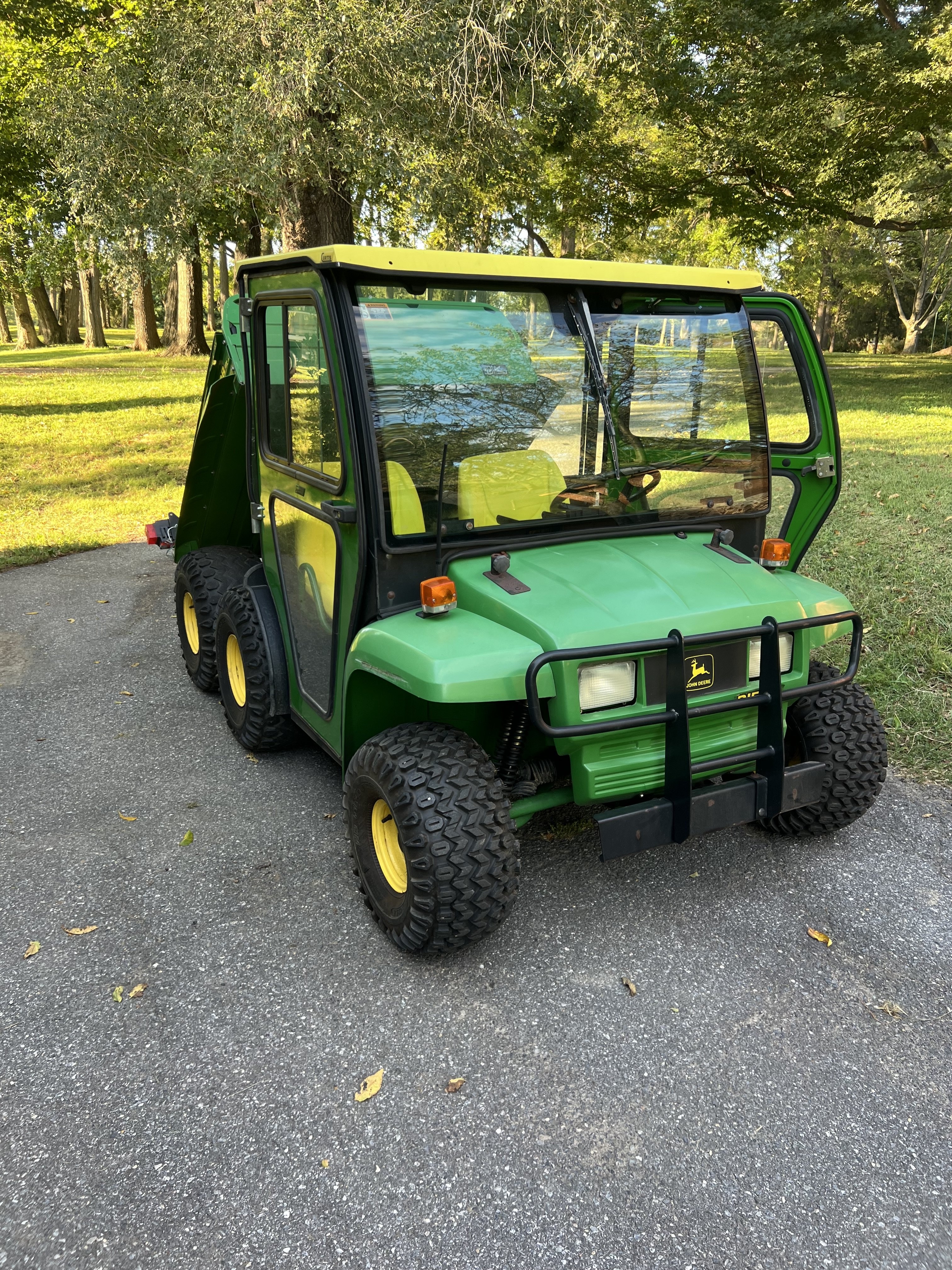

Some thoughts on your potential purchase. John Deere 6x4 gators are good simple Utiility vehicles that like anything has pros and cons. Yanmar Diesel is bulletproof. 6x4 will do well in most terrain but is limited by ground clearance and a drive belt that is not enclosed. Any water on that belt and you are getting another vehicle to tow it out of the puddle. Leg room is limited. Cabs are nice but amplifies the noise to a level you may not like after a few miles. They are also heavy increasing load/reducing top speed and limit the ability to perform service/ maintenance. 6x4’s are slow. Early ones did 16 MPH, newer ones got into the lower 20’s. Turning radius is terrible due to the 4 rear drive wheels. These are some initial thoughts. Understanding how you want to use the vehicle would allow me to provide feedback more specific.
Below is a link to the John Deere Gator Forum. A good resource for owners.
John Deere Gator Forums
Some feedback specific to your numbered items.
  • The brakes are internal wet disc and probably will not have to be replaced. Some units did have an issue with noise when stopping. (sounds like a sick whale) John Deere came out with an additive to reduce/eliminate this noise. Pour it into the transaxle.
  • Not certain about the heater. On my 6x4 L/C gas unit the radiator is under the front passenger seat. I do know that the diesels were very cold blooded so getting heat out of one will take allot of work/load.
  • Electrical problems need to be diagnosed per the circuit with the issue. Do be aware that the wiring harness runs through a channel in the frame so access can be challenging.
  • Rear Tires. Note that off road tires can be up to 20% plus or minus difference in diameter. Air up the tires to specification, measure the diameter and if 2 are smaller use them for the front set. The axle on the front set of rear tires is actually ½ “ higher than the rear axle. This is to improve the steering.
  • Rear diff lock is working and does demand more power as you are driving both sides..
  • Another diagnostic opportunity 😊
Yes, allot of electrical issues. DIY not too expensive. Having someone else do it could be costly. Source a Technical Manual so you have the electrical diagrams.
To me, $8K is high. $4-$5K maybe. Personally I would rather look at a 855D. 4WD, Yanmar diesel, fully enclosed clutches and belt. Slightly faster. Good ground clearance and suspension.
Hope this is of some value as you look at JD utility vehicles.

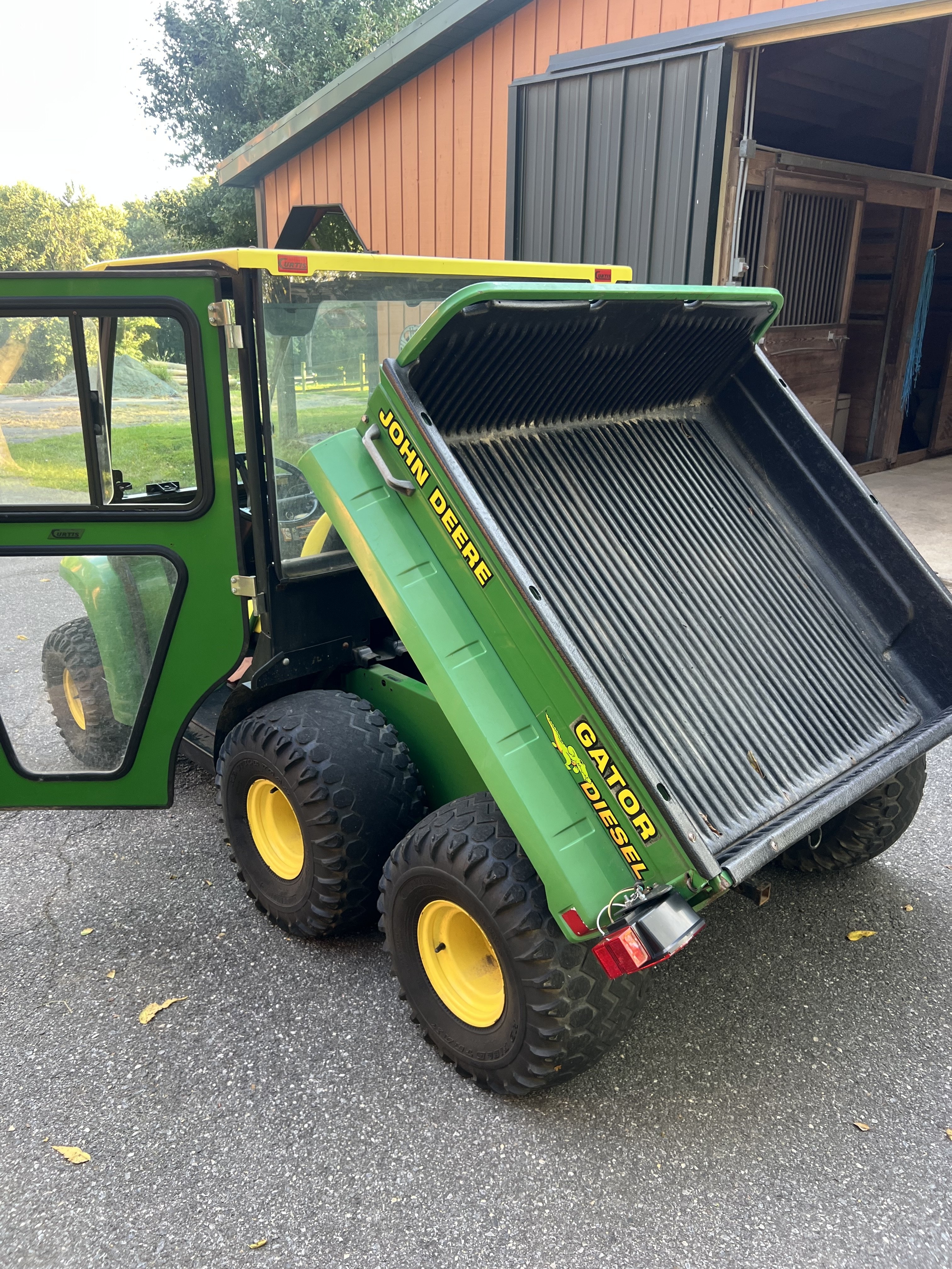

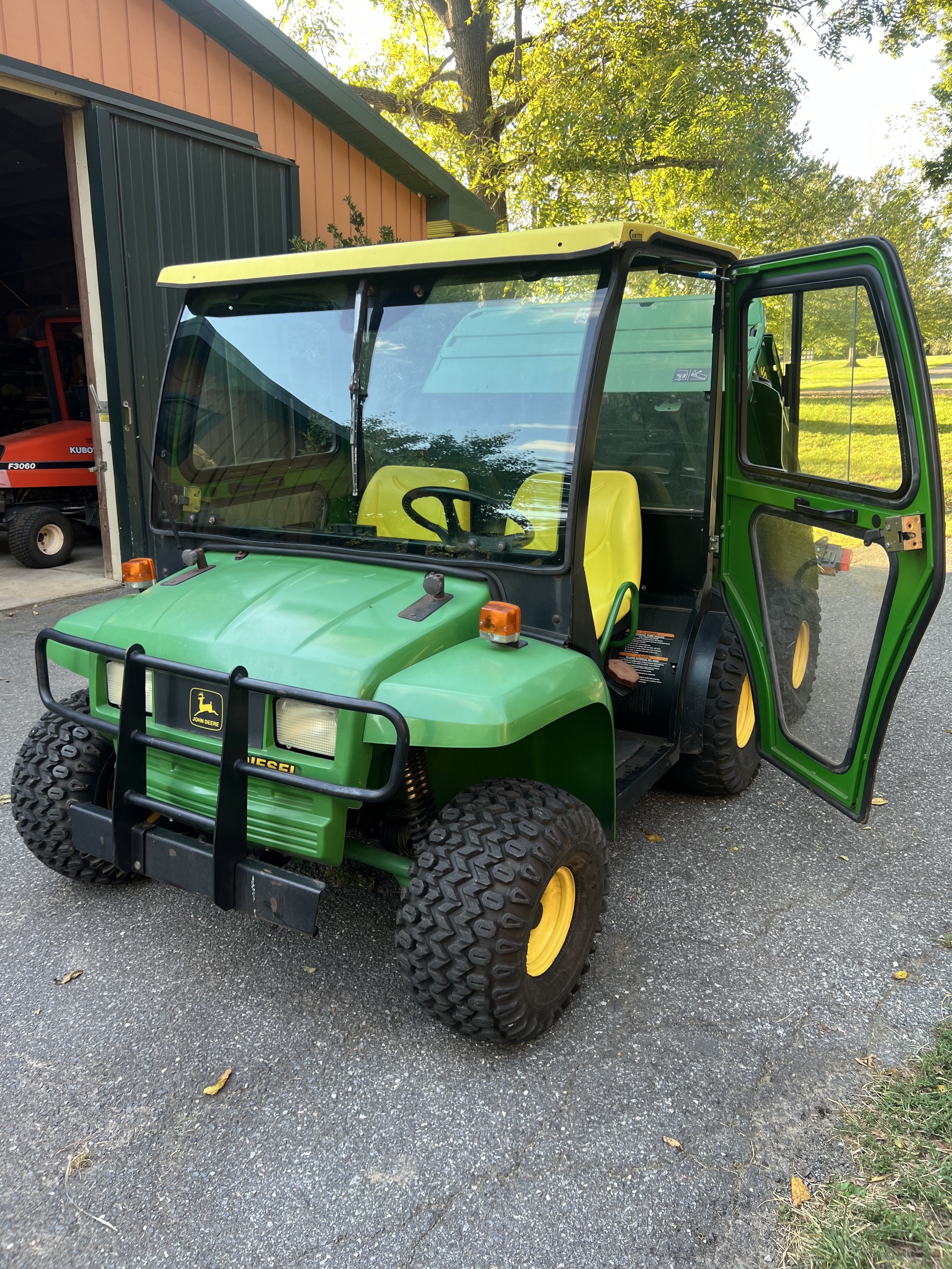

I’ve wanted (or thought I did) a John Deere Gator 6x4 with Curtis Cab for 10 years.
Finally, a local one came up for sale that I thought I’d take a look at.
This one is 25 years old with 1700 hours. Electric dump bed and curtis cab.
Used on a horse farm. It’s in excellent conditions. Original paint & plastics look great. The metal Curtis cab was excellent. Seats were perfect. Definitely stored inside.
I drove it around his property a bit. My impressions are that it seemed slower than I expected. Maybe this is just the way they are.
The drive belt was recently replaced. It started and idled perfect. It accelerated a little slowly, I guess you can’t expect speed form an 18HP Yanmar diesel trying to move such a heavy vehicle?
So here’s the problems I saw:
1. When I applied the brakes, they worked, but when the brakes were pushed harder, they made a groan/grinding sound. It stopped, but the sound didn’t seem normal. Any idea what this might be?
2. It has a factory heater under the seat. The switch didn’t turn the heater on. Owner claimed the fan quit, or possibly the fuse was blown.
3. It has factory turn signals. Fronts work, but not back lights. Probably wiring issues as evidenced by wires hanging loose. I definitely like the idea of lights for working alongside the road. Owner said taillights were replacements. OK, not a big issue.
4. Rear tires were low on tread. Pretty straightforward. But how much should a set of 4 “factory” rear tires cost including mounting?
5. When the rear diff was locked, it was noticeably slower and definitely more difficult to steer. I perceived this as a “good thing” meaning the diff lock was locked and working properly?
6. Cab is equipped with windshield wiper, but switch did not turn it on. Another wiring issue.
I have zero experience with them and didn’t know what to expect. So my questions are pretty basic. Seems like a lot of electrical repairs.
Seller asking $8,000 but said he would take $6,000. Knowing it needs 4 tires and a lot of wiring diagnosis/repairs- Is this a good deal? It seems like it based on others I have seen advertised with rust, higher hours, etc.
I have toyed with buying a new one and paying it off, but they are $20,000. Don’t know if the new ones are any better, but they look more plasticky.
