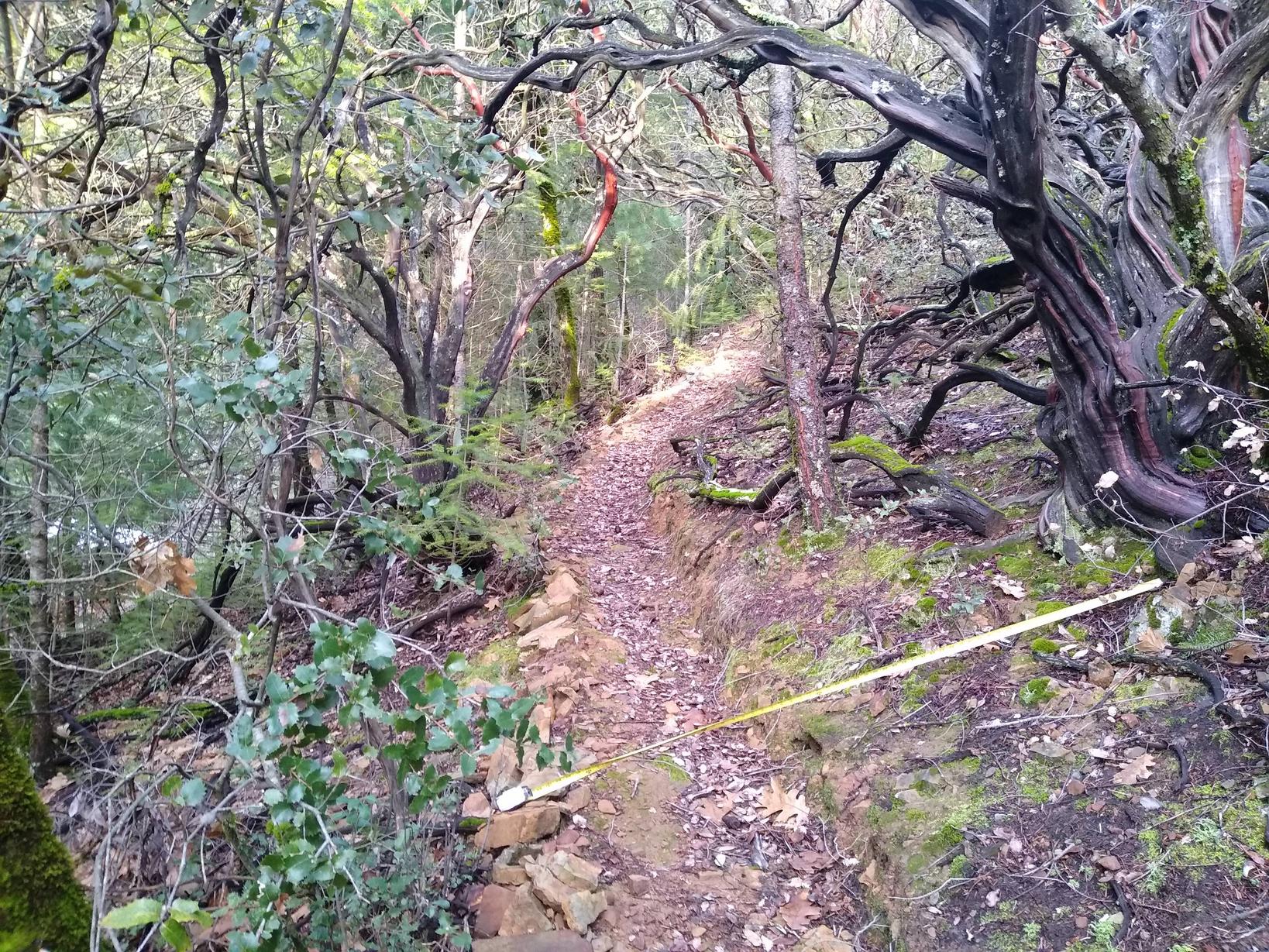

Here's a picture of what I'm dealing with. This is just about the steepest slope that I have. The tape measure on the ground is 66" long, for scale. As you can see, I really need to make this more accessible to clear this junk out.
This is in northern California, in the foothills.

Mine is probably one of the narrowest machines available and I need a width of 72" at least to be anything close to maneuverable.
Could I inch my up that trail, moving material from the right to the left? Maybe.
