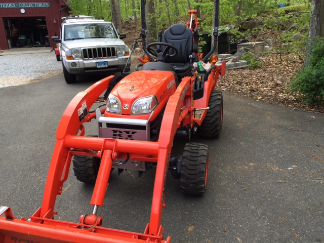

My lot is very uneven, wooded, rocky and full of hazards. Turns were the worst, always had that butt-clenching feeling when making a turn on a slight grade to get around an obstacle with a load in the bucket, or even without. I ordered a set of Bro-Tek Wheel spacers (there are several manufacturer's that make & offer them) and installed them this very afternoon in about an hour. Very happy with the results. Tractor feels 100% more stable. I put 1-1/4" spacers on the front and 3" on the back. World of difference. Easy install. Stress level is greatly reduced. If your land isn't perfectly level and open, wheel spacers are must-have safety gear. They are not cheap, but far less costly than what could happen if the tractor goes over. Not sure why some of the thumbnails are sideways, when you open the photo they appear to be right-side-up.
