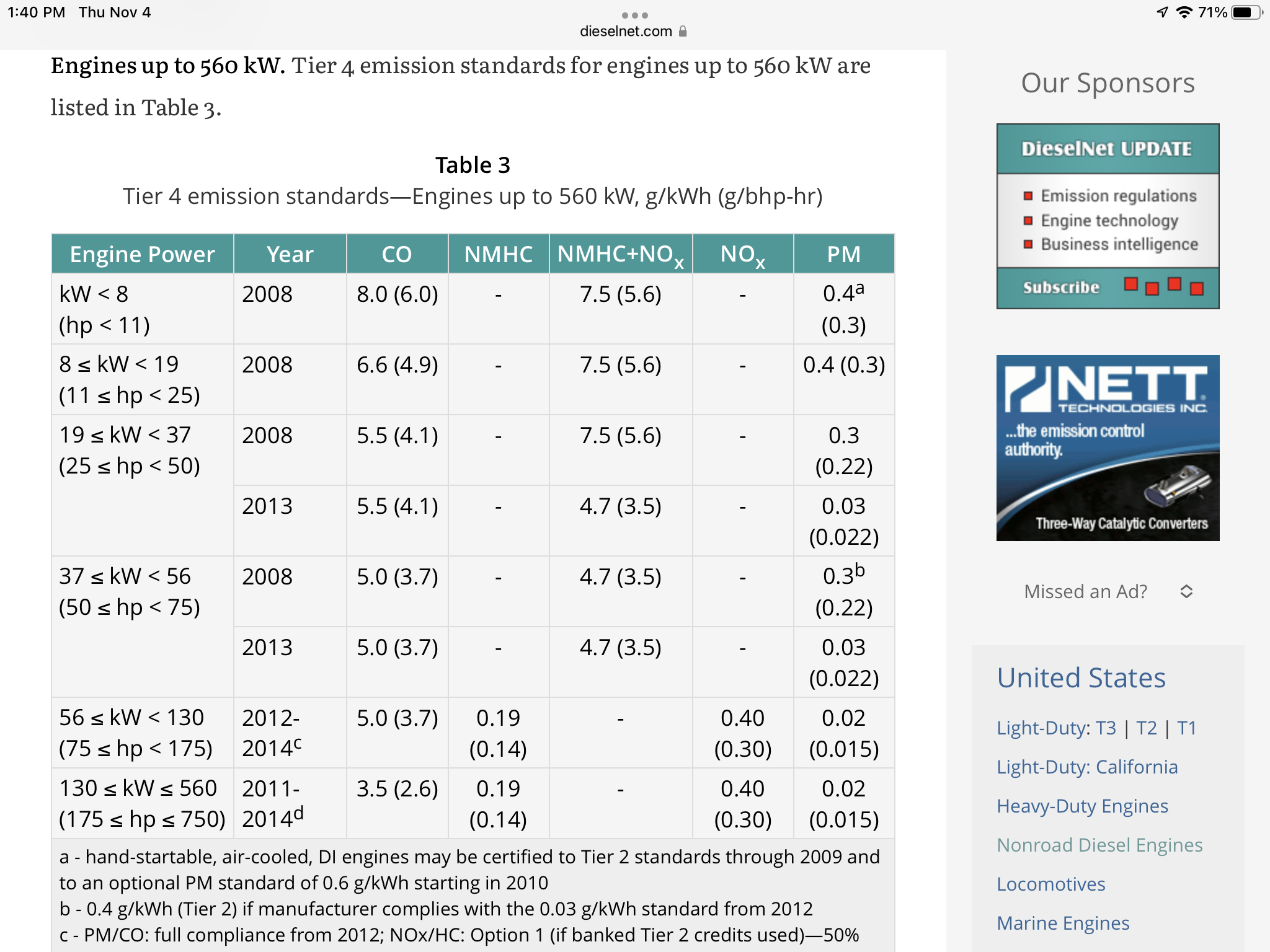

   / Compact Tractor Diesel Particulate Filters (DPF) Version 2.0 #160
Certainly both are Tier IV compliant.
Tier IV exempts tractors <25.4794 horsepower from Tier IV standards.
Every off-road Diesel engine has to meet the emissions limits for the horsepower range the engine occupies. None, including the engine fitted to the L2501, is exempt.
