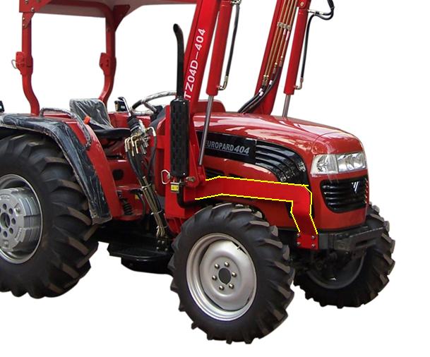

I agree with this for sure! The real axle beam will take care of impact loading but a loaded bucket would put a huge moment on the bell housing. I think all loaders have a brace that go to the front? Here is one i stole from the net, i put yellow on the bracket...
From the looks of your build you probably have it figured out - just a suggestion in case you hadn't thought of it.

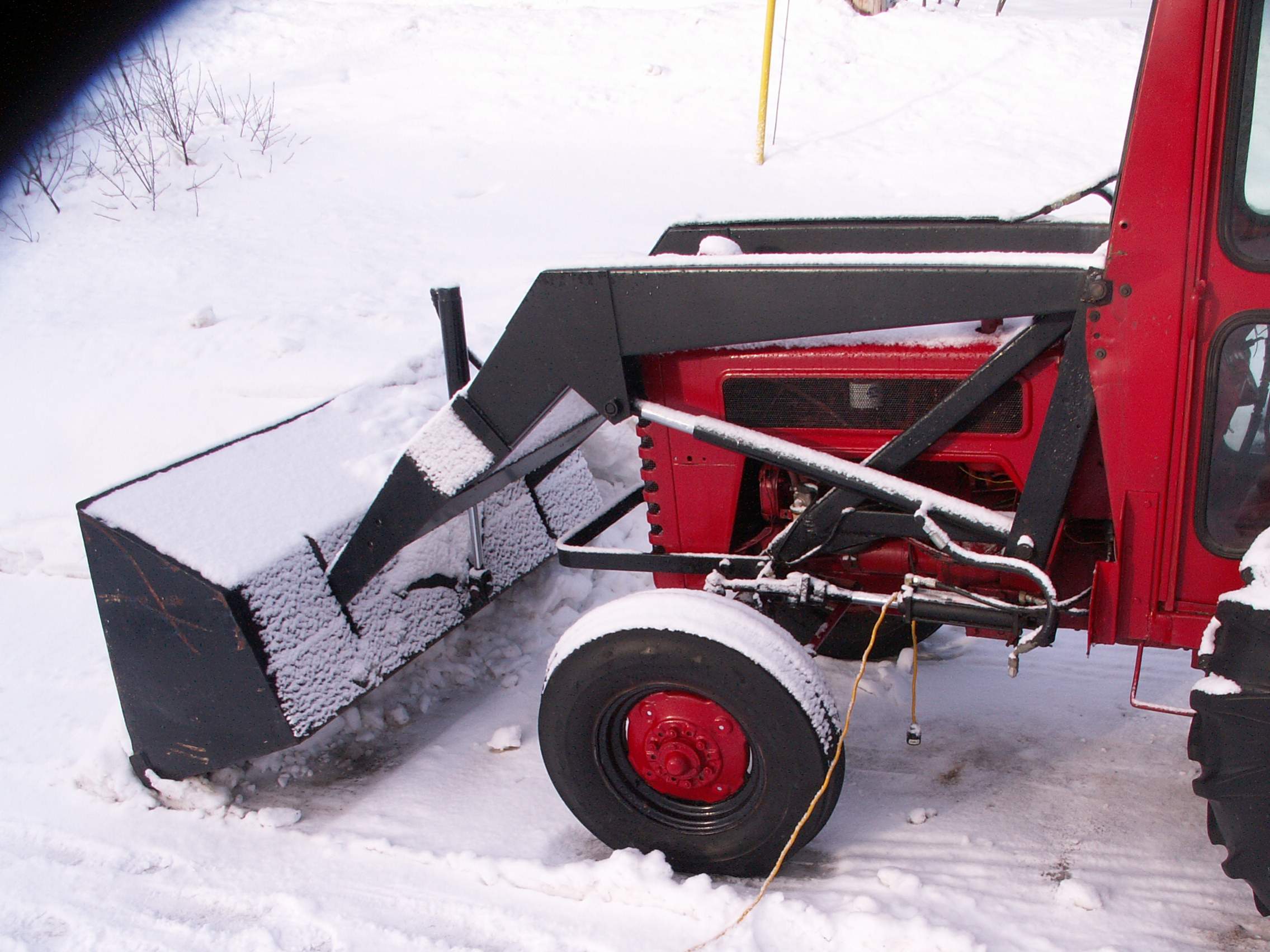

also you may need to add a cross link at the top, and cross bar to the front of the tractor frame, i will post my homemade loader. you will see what i mean
