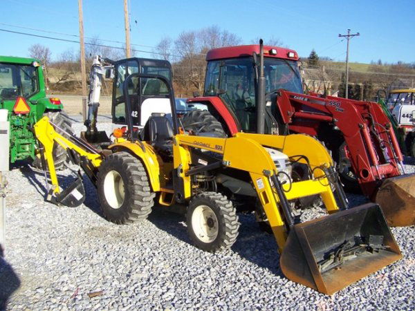

Was able to find that the Cub Cadet loader 833 was matched with the Cub Cadet 7532 tractor. That tractor is similar in size to the Yanmar YM 2402, so now to find someone to make brackets

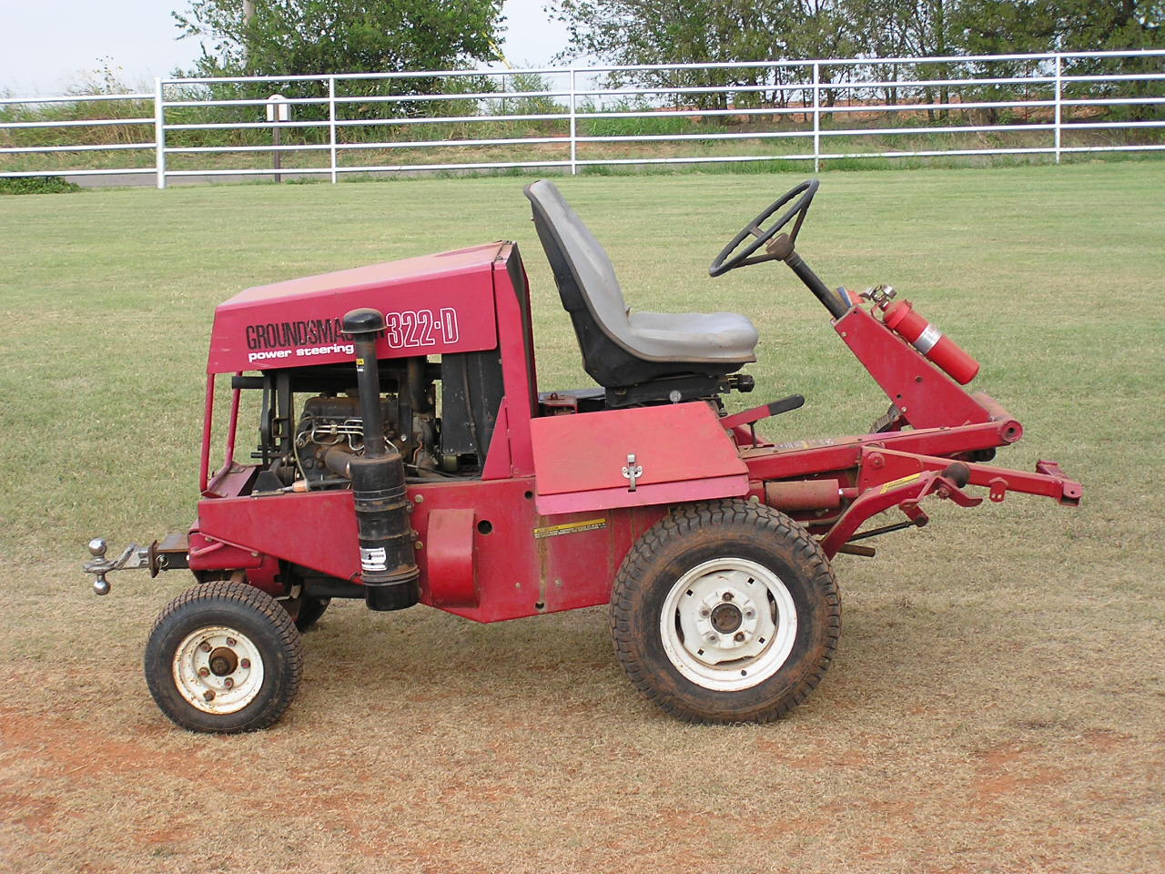

Trying to match a used loader to a different brand tractor is usually a very a poor idea.

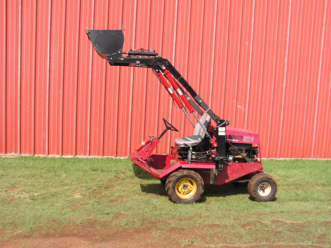

Worked great for me, but on a TORO, not a tractor:

Was able to find that the Cub Cadet loader 833 was matched with the Cub Cadet 7532 tractor. That tractor is similar in size to the Yanmar YM2402, so now to find someone to make brackets

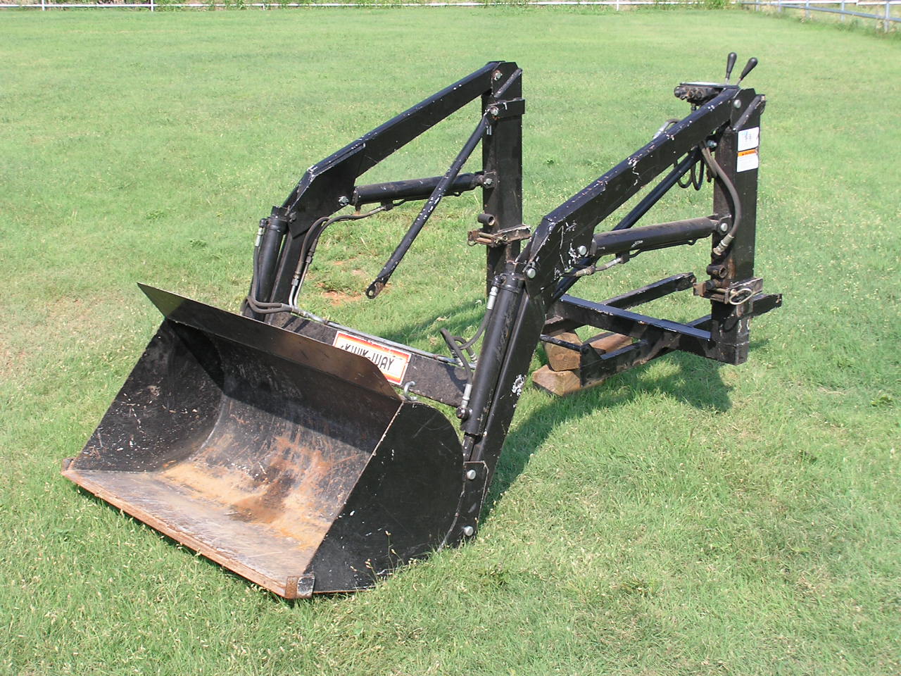

It does have a similar shape to the Koyer's for the YM series.
TractorData.com Cub Cadet 7532 tractor information
Shows that it was a Mitsubishi tractor made for CC. Actually, you should SELL the YM2402 and just BUY a CC7532 with the loader! That machine has the K3M turbo charger engine! :thumbsup: On the Mitsubishi forums, that is one great machine!
