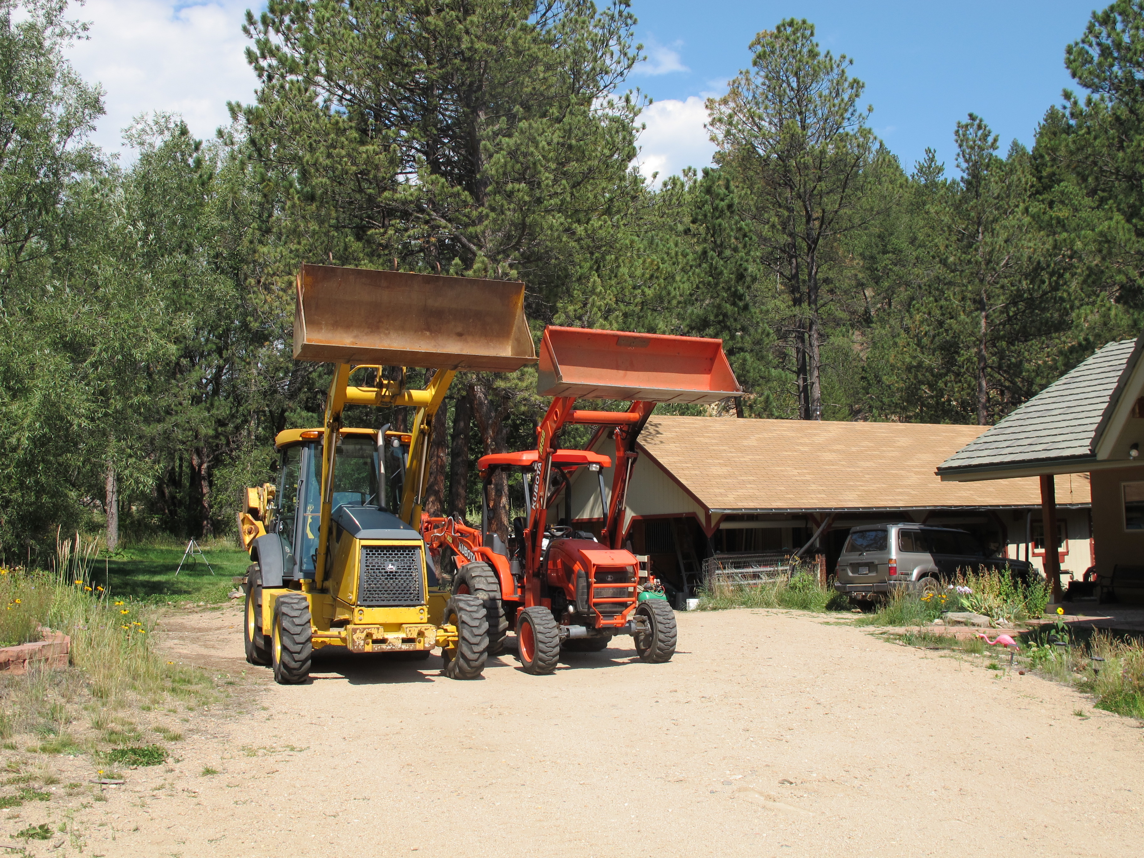

Marchanna,

Probably not. Here are some engineering shortcuts:
1 cubic yd is 27 cubic feet
1 cu yd of dense mulch weighs almost 1000 lbs, 1 cu yd soil weighs 2000 lbs.
1 cu yd of sand/gravel is 3000 lbs, concrete is 4000 lbs/cu yd.
Add 200 lbs/cu yd if the material is wet.
For tractor comparisons, the Kubota M59 below has a 1 cu yd bucket and can lift 4000 lbs to full height. The yellow JD has a special large 1.3 cu yd bucket and can handle over 7000 lbs. All lifting measurements are considered to be taken at the bucket pivot.
To handle that kind of weight, the JD bucket weighs 1500 lbs empty. This JD tractor is roughly twice the size and weight as the M59.
rScotty
