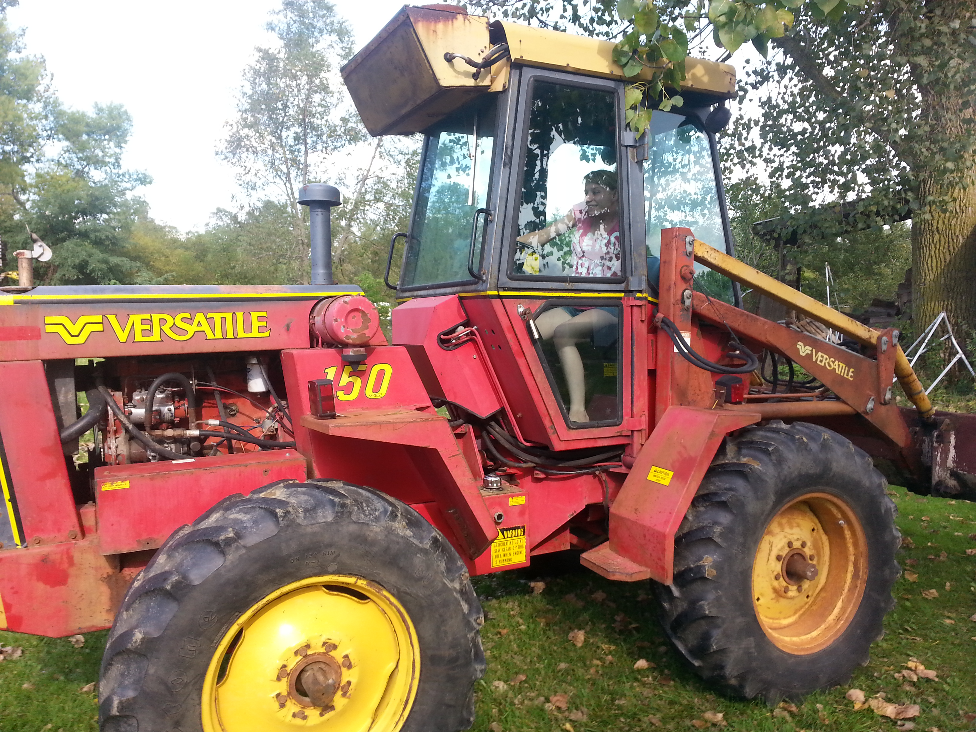

I hadn't seen this thread before either. I have to agree with you - conventional is not the way to go for a handy tractor which is why I bought the small Versatile Bi-directional (150 model) - it has most of the features you guys are mentioning. 70 hp, rotating seat and control panel to go either direction, hydrostatic, loader and 3 pt in full view, articulated steering, equal size tires, weighs only 7800 so it doesn't tear up the lawn, quicktach loader, lift height of about 10', etc.
This is a 1980 model so they have been around and probably where some of the concepts that Steiner and PT use came from.
the one thing I am not a fan of is that with the cab between the loader arms it is a little difficult for a big guy like myself to get in and out of.
The price of these is a about the same as a CUT of the same vintage as they are too small for most farmers these days.
Note the direction that she is driving it.
7,000+ may be "light" by ag standards... but it's nowhere near the compact utility class and will EASILY tear up turf. Lastly, the overall size of the unit makes it a no-go for low clearance tasks.
You are right CUTs are lighter and shorter but it all depends on what you are after. I wanted a good work platform 10' high and this is very light for something like that.
As for tearing up turf - yes you can or you can drive it right and there is little to no damage. I drive it across my lawn on a regular basis as long as it isn't too soft and it is not a problem. I do not carry a lot of weight on it and do that nor do I turn with it stopped. I keep the tires a little soft to spread the load better. I may change tires to one with a little more flotation and not ag tread.
