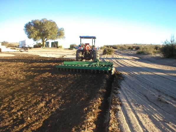

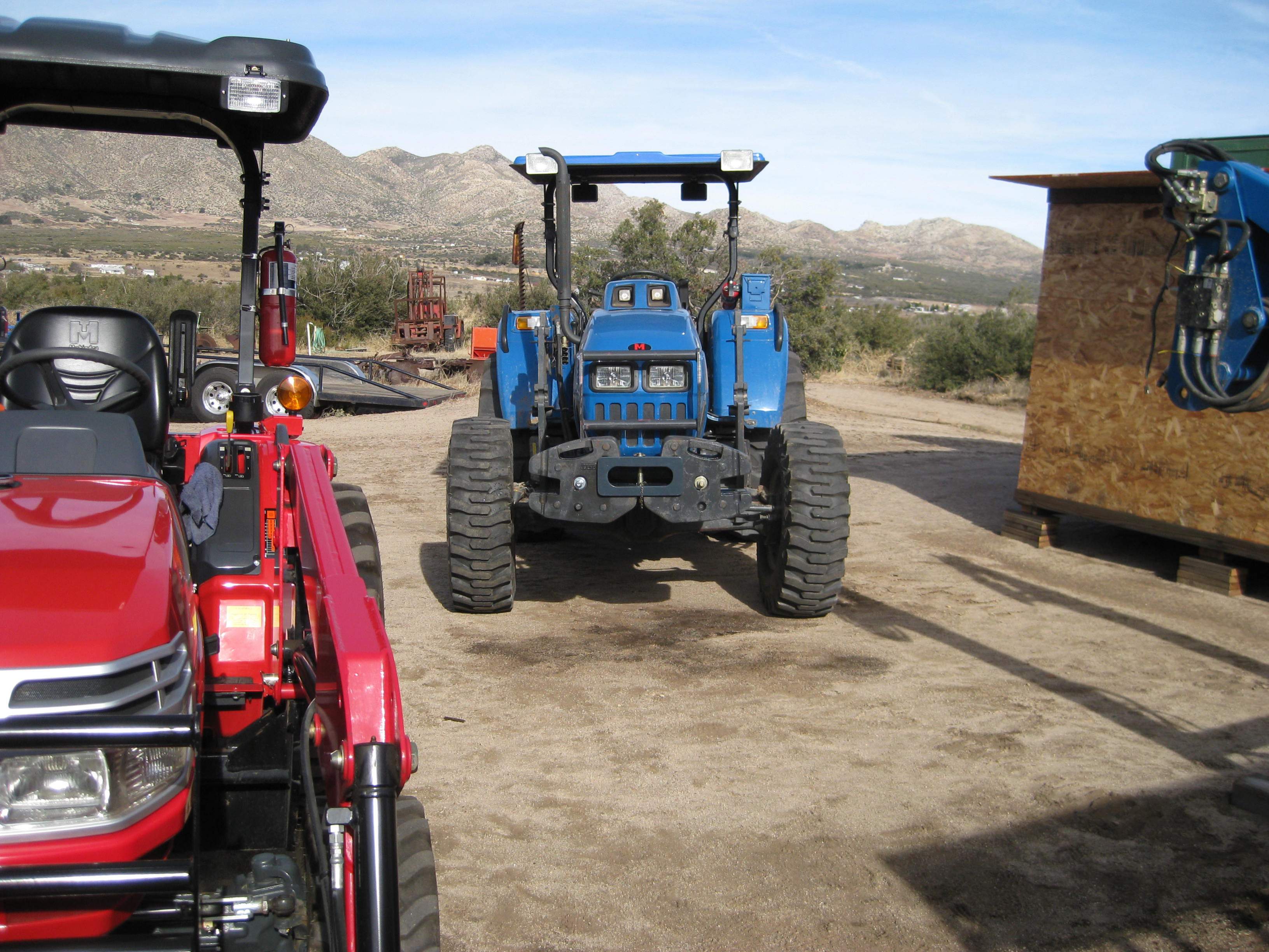

The weight of the machines is drastically different. Weight to the ground gets you traction to get work done. While they will both do the job, in my opinion, the Massey will do more work in X amount of time.
My 75hp tractor is ballasted to just over 13,000lbs with the loader and that is where I had to get it to get the best all around capabilities out of the machine. It is just under 11,000lbs with the loader off and front weights on. It acts like a sports car with the loader off. :rolleyes:;)
