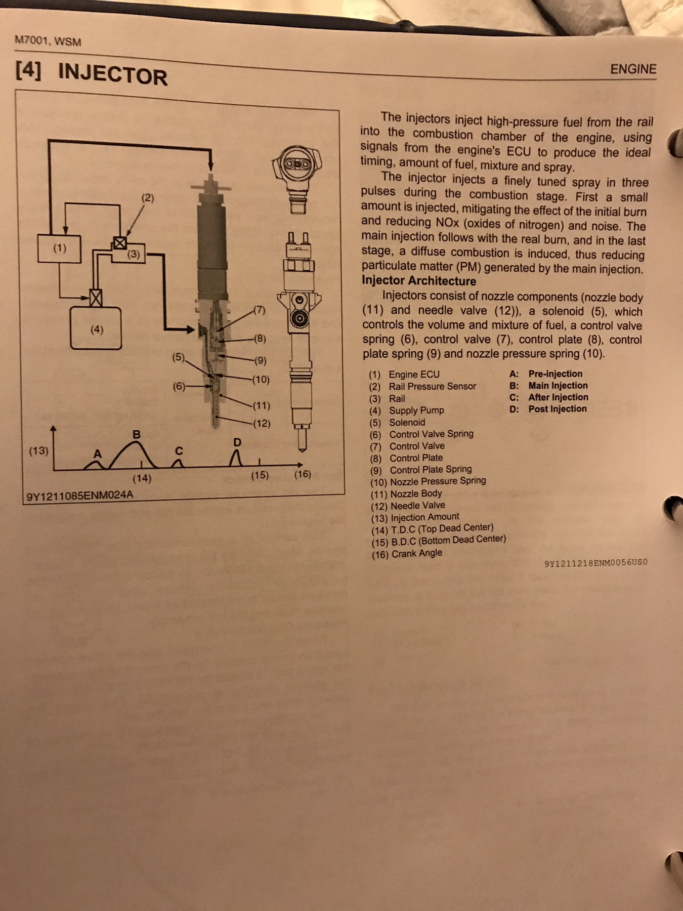

My M7-171 is in the next class, has EGR, SCF, and DPF. The DOC is at the inlet of the DPF and the SCR is after the DPF. Fuel to the DOC is the little burp shown at the end of the attached injection diagram - the post injection. Note post injection is before BDC so is still in the power stroke. There are temperature sensors at the inlet to the DOC, DPF, and outlet of the DPF. I don’t know which sensor provides the DPF temp on my panel but it runs between 1100 and 1200 in regen, about 1000 under a good load. Actually it has 2 EGR valves, one for high power high flow rate and one for low power, low flow rate.

...Fuel to the DOC is the little burp shown at the end of the attached injection diagram - the post injection. Note post injection is before BDC so is still in the power stroke...
That last injection event (D) occurs right at the end of the power stroke because it needs to happen just as the exhaust valves are opening so that the end-gases will be effectively pushed out. If the post-injection happened after the exhaust valves opened, the fuel would not effectively move nor would it be as hot.
The first injection event your manual describes is called pilot injection. The primary purpose is noise control, although it also prevents as rapid a rise in cylinder temps which helps reduce NOx.
To put into perspective, a modern diesel pickup has 7 or 8 injection events. The timing of injection pulses has become critical to fuel consumption, soot production, NOx production, power, and noise.
