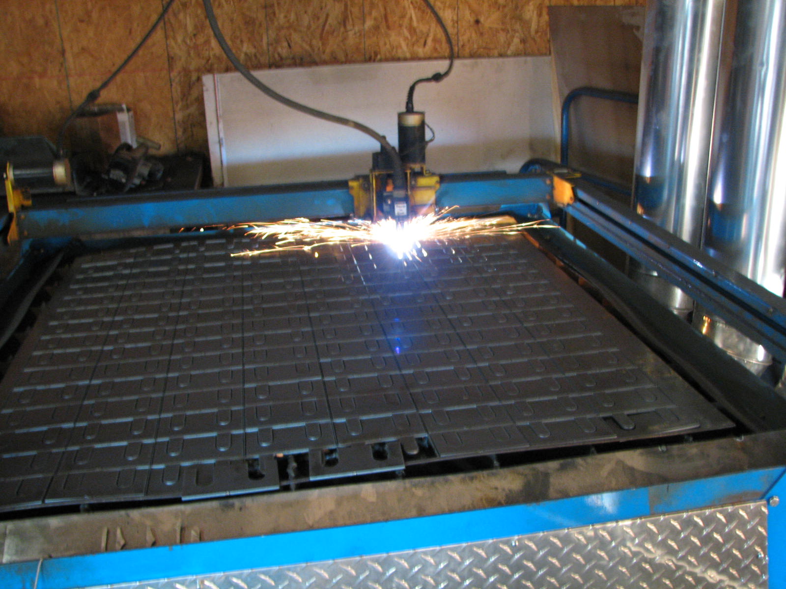

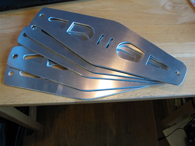

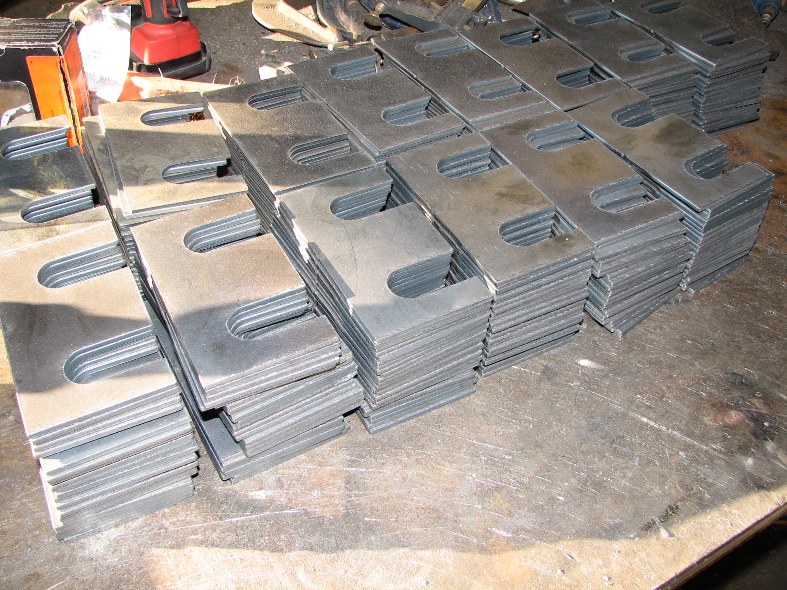

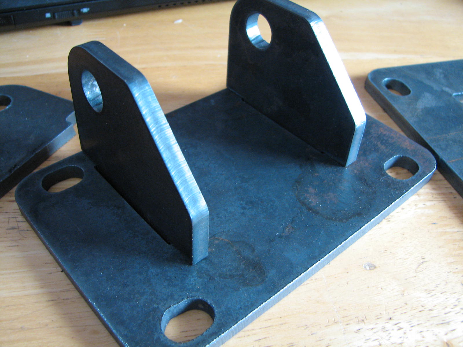

Attached pics are all cut with a major brand 85 amp plasma that can use either a hand torch or a machine torch (quick change, no tools required) so you can switch from mechanized cutting to hand cutting in seconds. The first two pics show 1/8" shims being cut (over 825 of them) ....the third pic is some 1/4" steel parts with tab and slot fitup, the last are some 3/16" aluminum. All of the parts were cut with a single set of 45 amp consumables...over 900 starts.....with plenty left to go!

That plasma table picture is impressive Jim.
