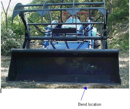

I noticed on your picture of attachable forks that the bucket on your TC has a thick and wide cutting edge.
Did that cutting edge come on your TC or did you put it on?
I got my TC45D in August and bent the bottom of the bucket within the first 2 hours of light loader work. My bucket has a 3/8" x 3.5" cutting edge. My bucket is a standard weight bucket. I ordered a heavy duty bucket, but NH screwed up and shipped the wrong one. It turns out the only difference between a standard bucket and heavy duty are vertical cutting edges and pre-drilled holes for a tooth bar(about 30lbs difference in shipping weight). NH buckets seem pretty weak if you ask me. I think they should have at least a 1/2" cutting edge to make the bottom of the bucket stronger.
I will be making attachable forks and putting on a thicker cutting edge soon. I think the forks would bend the bucket more with the current cutting edge.

Your grapple set up looks pretty interesting. Any chance of getting some information and photos?

Tim, the cutting edge is a NH option for the heavy duty bucket. I paid $175 for it. It really helps and adds strength to the front edge. It's also reversible (has two finished cutting edges). I've also been shown a supplier who makes a tooth bar which can be bolted on with the cutting edge in place. That's probably my next purchase.
