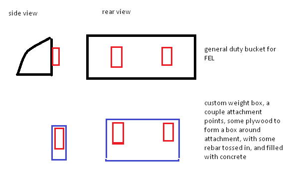

custom weight box, for FEL, remove general duty bucket, measure the brackets and hole locations, goto a local metal fab shop to get some brackets made up, and build a plywood box put in some rebar, and fill with concrete.
a reminder on grade school levers / fulcrums / a kids tetter totter... the further out the weight is in front, the more force it has to hold down the front wheels. 100lbs, 10 feet in front, vs 1000lbs 1 foot from front, type of thing.

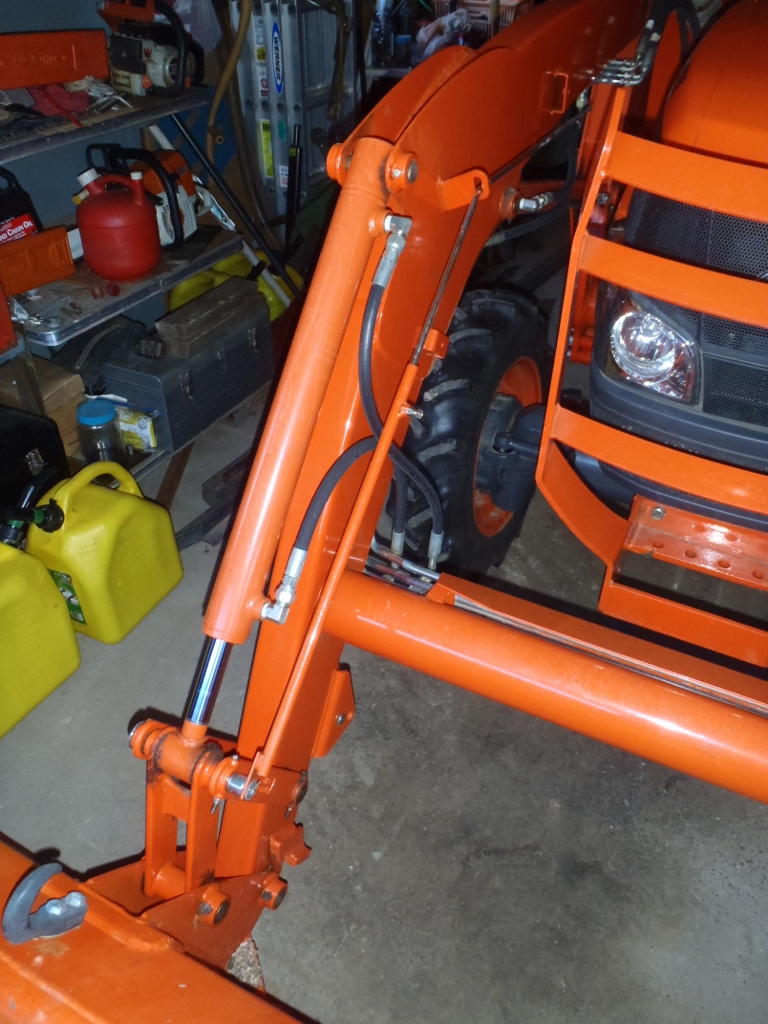

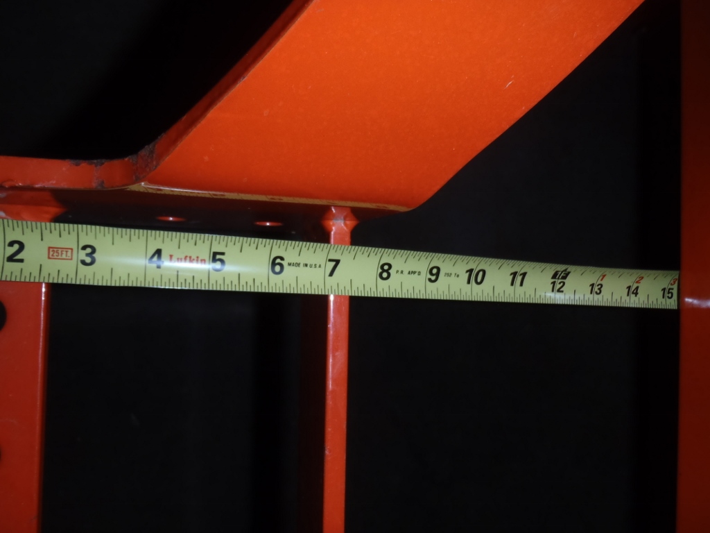

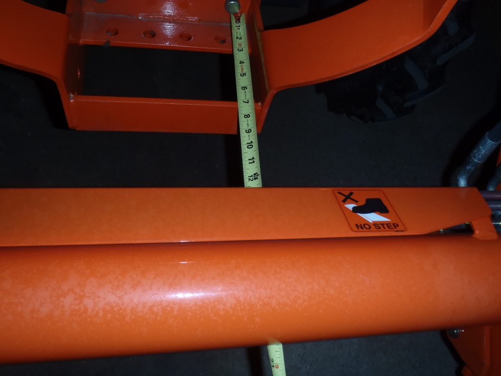

It sure looks like there's room for weights on the L3240's brush guard, even with the 724 FEL installed:
