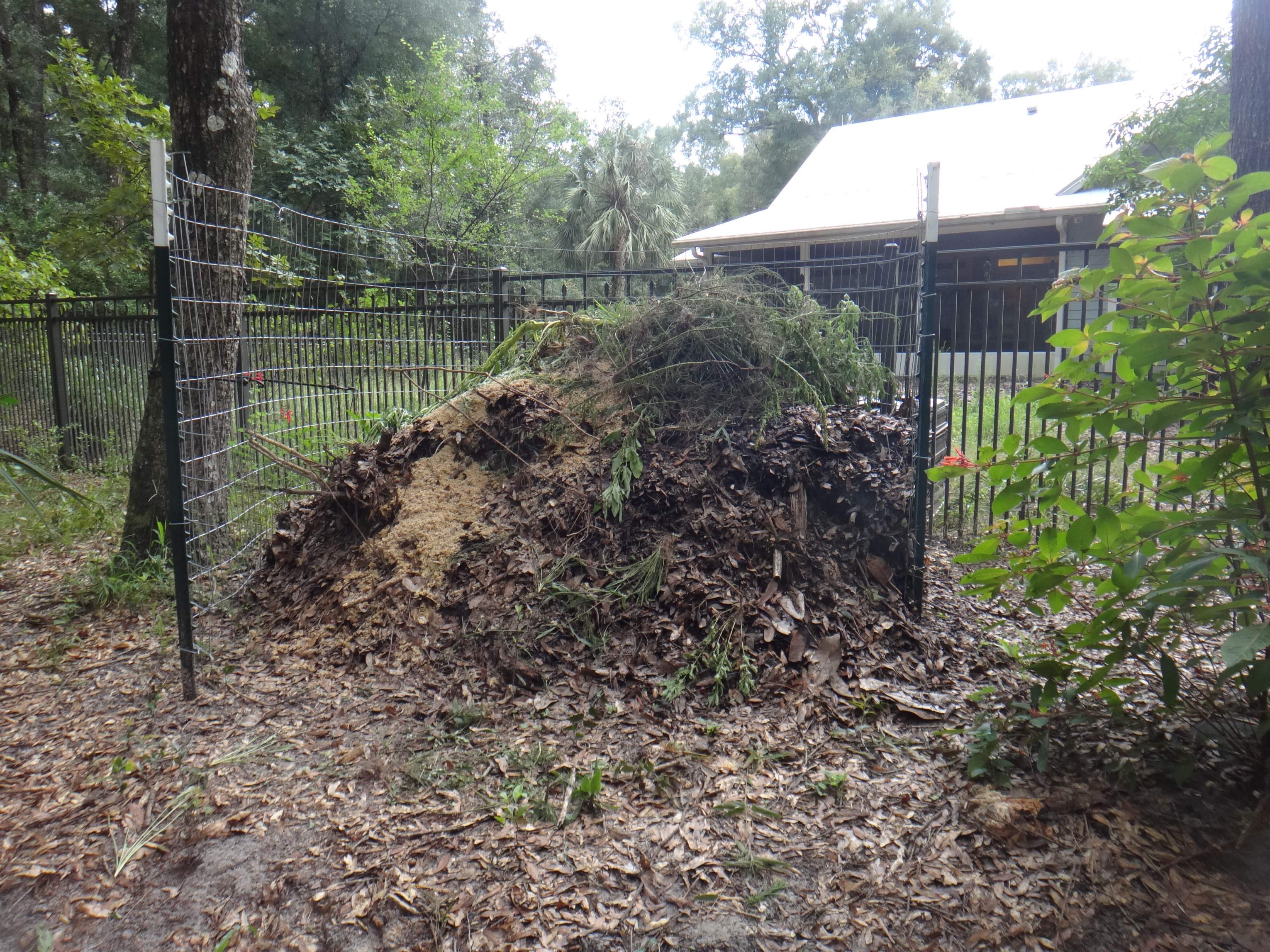

I am trending toward a 4' high, circular bin of heavy welded wire, with 1-2-3 T-posts, if necessary, to give the bin support. No top, no bottom, just a circle. With this design, changing volume will be easy.
I will research welded wire fencing material available to me at Ace Hardware, Tractor Supply Company and Southern States Co-op, locally and hope to find something satisfactory.

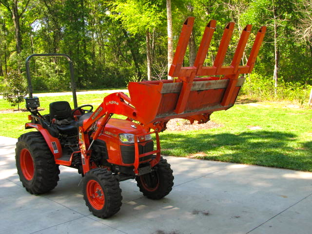

Ace Hardware has Redbrand 12 Gauge Welded Wire Fencing 48" X 50' (2" x 4" mesh) @ $79.99. Not much more money than more readily available 14 Gauge fence rolls and probably considerably sturdier. I am thinking 12 gauge fencing may be sufficiently self-supporting that I can leave a gap wide enough to push in 58" Debris Forks attached to 72" bucket on tractor.
If I decide to use T-posts is there dedicated steel hardware of some sort to attach fence to T-posts securely?
   / Compost Bin, For Secondary Aging of Compost #18
I use 7 pallets attanged in a modified T. One section for raw. Second stage. And finished compost. Not pretty but cheap and effective. Dad used these brackets from Lee valley and 1x6 cedar for slats. His is a lot fancier and looms better. Composter Bracket Set - Lee Valley Tools
#19
Here is the result. I used two 6'-6" T-posts pounded 20" into the soil to support the enclosure opening. It is simple to fork compost over the aluminum fence in either direction, or into the 72" bucket on my tractor. Bin used about 1/3 of the 50' roll of 12 gauge welded fencing.
I expect my finished compost output to triple. Finished compost will be used to level my lawn.
Two modular plastic compost containers within fence will consolidate to one.
Thanks, EVERYONE, for your input.
