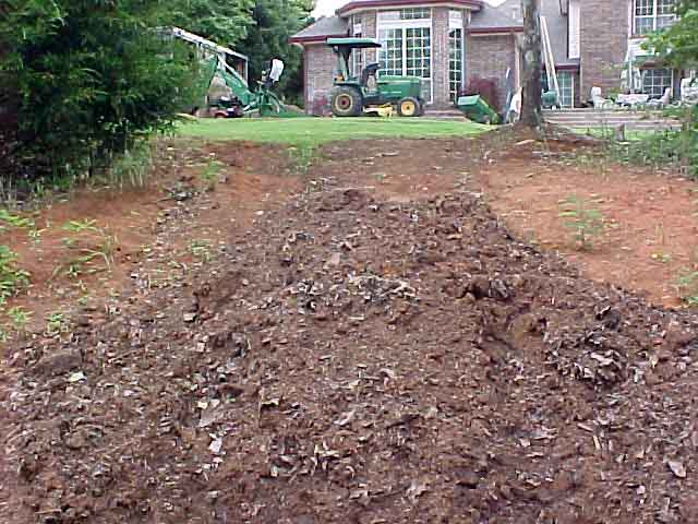

All this was done last Fall. I've been turning it with the FEL every few weeks and adding kitchen scraps (mostly peelings) and leaves, all the time.
My "compost" is not black, as you see. Probably because the composting process is not done and because of the dirt I added to begin with. It's encouraging that earthworms have come from nowhere and are plump and happy.
Our garden is mostly clay. It was reasonably productive last year, but I've about given up on trying any further conditioning of the clay. This Fall, after harvest, I plan to dig out the clay about a foot deep and replace it with my homebrewed compost and a load of topsoil (?) to make up the volume. The garden is only about 15' by 30', so I think it's doable.
Anyway, there's my simple, cheap compost "bin". It may be obvious this is my first attempt at composting and my bin is quite flawed, based on many of the good comments here in this thread. I just hope it yields some positive results. Once the Summer sun is through cooking, I'll post another picture if there's anything worth looking at. /forums/images/graemlins/confused.gif

Thanks for your observations and pictures. I'm taking in all ideas at this point. By the way, beautiful place you've got there. Thanks also for the link - I've actually read that article already. /forums/images/graemlins/laugh.gif I'm flying off to sunny Florida tonight for a nice week of golf and leisure. I'll be sure and revisit my composting dilemma as soon as I return. /forums/images/graemlins/cool.gif

Making a pile on the ground works great. In fact you need soil contact for the bacteria, worms and moisture to have access to the pile even if you use bins. You can make fast (hot) compost by using the correct blend of materials and turning often. Or use the slow method and just make a pile. Over time the material will break down and you will have great compost that way too. The compost is "done" when you start to see threads of mycelium appearing in the pile. At that point you have potting soil. You can use the materials much sooner if you wish.
Clay soils have great water holding capacities and with the amendment of organic materials will make great garden soil. I'd also consider growing a cover crop. Cut the tall material off and add it to the compost pile and till the rest in a couple of weeks before planting your seeds. There is also nothing wrong with using topsoil and your own compost to replace some of the clay soil if you want to. A couple of things to keep in mind though. Don't get a 3 way or 5 way mix that has a bunch of fresh sawdust or chips in it. That material will rob the nitrogen from your garden plants and will not improve your crop for this year. Compost is the greatest thing you can do for your soil, but is not fertilizer, you have to add that too. Be sure to incorporate the new materials into the existing soil of your garden or you may end up with a stratified layer that will not drain and that the plants may not grow into...
Good luck!

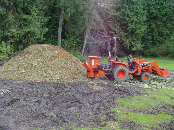

I started out thinking that I needed bins. I am going to be composting fairly large quantities of mulch, so the bins would have to be fairly large. After considerable research and a little experience I came to the following conclusions:
1. The best way to compost large quantities is in open piles or windrows. When it is open on all sides the oxygen is more plentiful and that is a critical component for the composting process.
2. I found that even when being careful, I would always manage to hit the sides of any bin I tried to construct and my little tractor could easily destroy a side with very little effort on my part. (Maybe it's the driver thats the problem)
3. When I found out that dirt was a critical component to compost, it became clear that I didn't have to keep it contained to a small area.
4. When I turn the mulch, I am not restricted by exactly where to put it. I move the pile around wherever it makes sense.
5. To remove it from view, we are planting a hedge around my "work area". Now I can have piles of mulch, compost, sand, topsoil, etc. and it will be out of view from the house.
I have attached a picture of one of my mulch piles.

Like DavidB has said, don't give up on that clay. Our garden is about half clay, but it has been worked for a number of years and the soil is almost black. Clay holds water very well and has minerals that sand doesn't.
My suggestion would be to just keep dumping the compost and organic matter on it and plow it in.

My Bearcat cost a little over $2000. I have been very pleased with it. I had a small Sears unit before that was more work than it was worth. With this unit, all you have to do is get the debris to it. Once it's in the chute, it's gone. The chips are very small and compost quickly. I have done a couple of piles like the one in the picture, so far. The chipper blade is just now in need of sharpening. The blades are reversible, so all I have to do is turn them over and I'm good for a couple more piles, I guess, before I have to send them out to be sharpened. The blades themselves are very expensive ($165 a set), so I am going to have them professionally sharpened when the time comes. My salesperson recommended the model without the blower. They have had problems with clogging on that model. For my use, with a FEL, I really have no use for the blower anyway.

Thankyou both for your input. You have raised my opinion of having clay in the garden and have convinced me to continue working the clay after all. I am new at gardening and know little about desireable qualities for garden soil, but I feel like I'm learning. /forums/images/graemlins/smirk.gif
