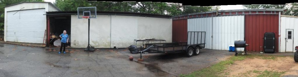

The place I bought has airlines running along the walls of 3 of the 4 shops put in by a prior owner.
attachment.php
It's all black iron pipe about 3/4". Must be almost 200 linear feet of pipe, joints, etc. It's hooked to a 120 or 200 gallon tank with a 5HP compressor. Unfortunately the pump sounds like it blew a valve or something so it needs replacing and is moderately low on my to do list.
