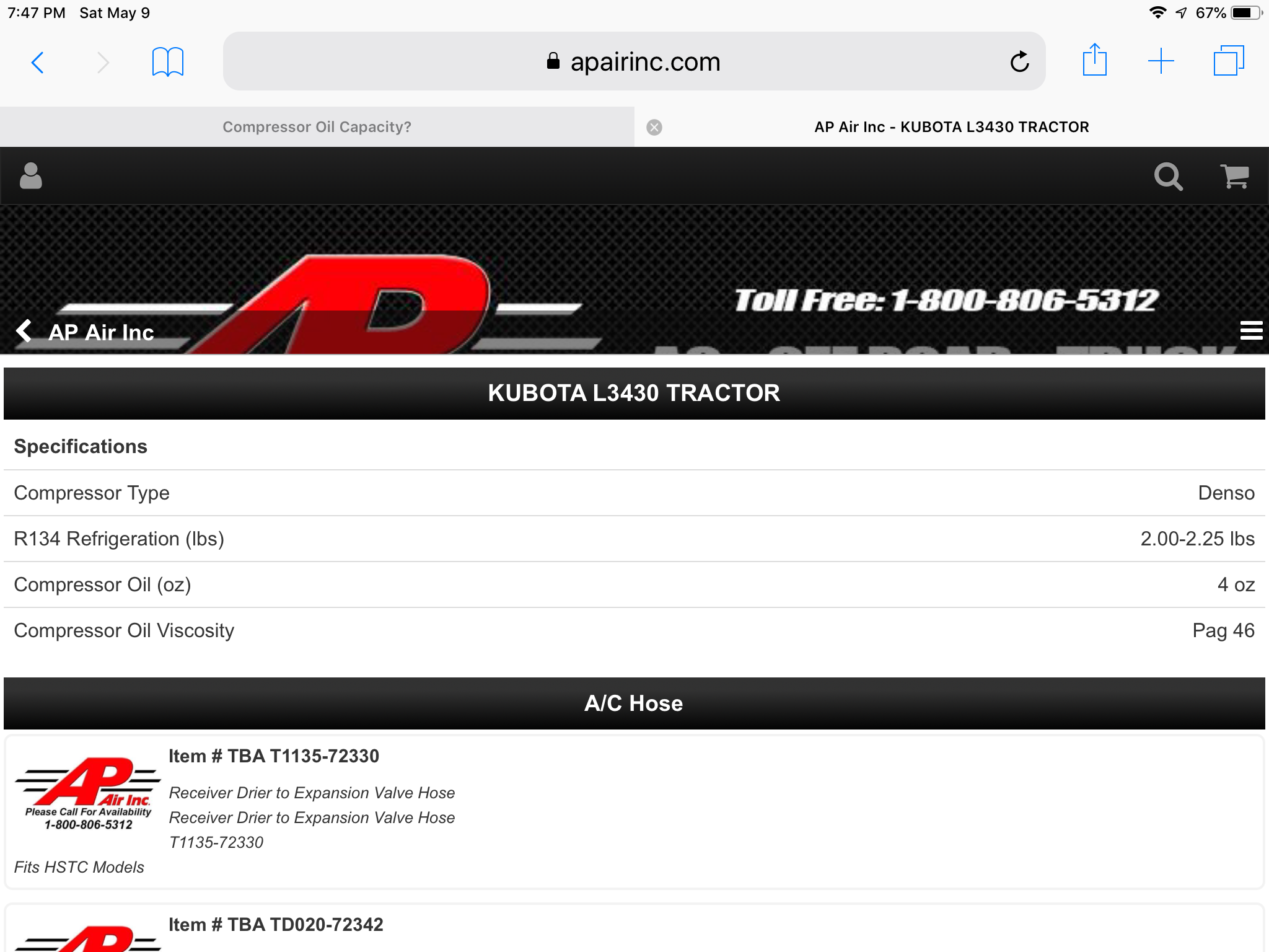

Replacing my "squealing" AC Compressor (6A671-97110 or 6A671- 97114) and flushing out the system on a Kubota Tractor L3430 HSTC Closed Cab 2004. Specifications with this model compressor sold on line have shown both 2.5 and 5.0 OZ PAG 46 OIL I suspect that is a general spec. most say refer to the individual operators manual. Does anyone have access to the Bigger Kubota Repair Manual for the L3430 and / or know what the total system requires for 46 PAG oil?

Screenshot from AP Air, the premier off-road AC replacement parts supplier.

Thanks Will try 4.0 Oz for whole system.
