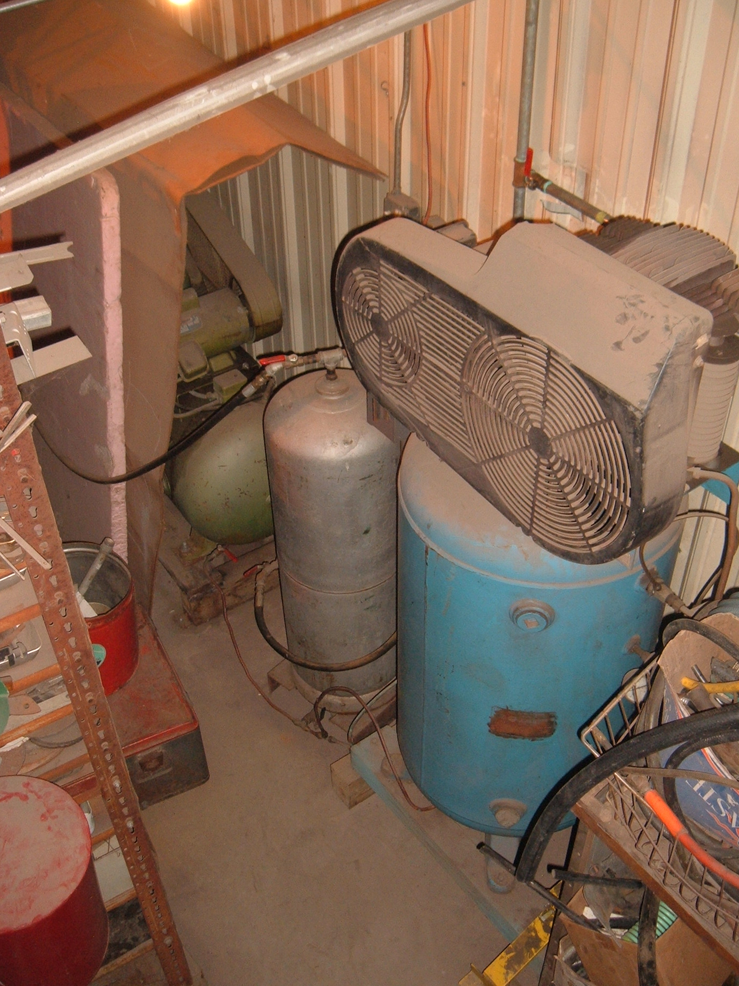

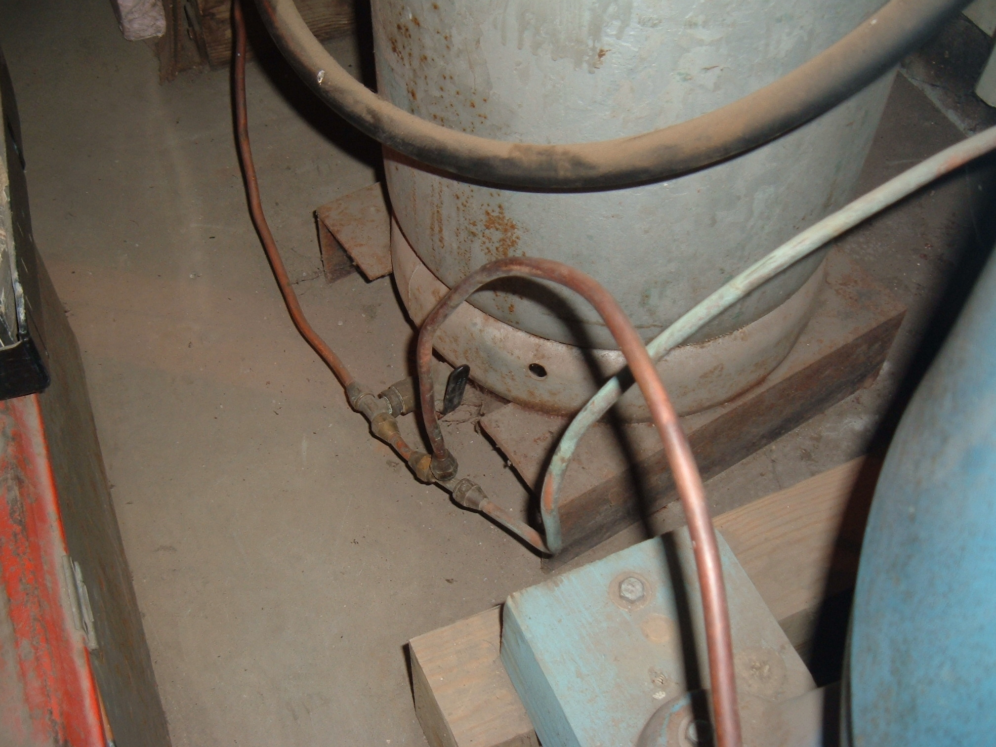

I have 3 vessels. A valve on each and plumbed to a common line thru the wall If I am running the snot out of it kick them a crack when I real a compressor thread somewhere.

The factory water drains are designed for use in cold weather. There is no sump for water to accumulate to bust. In the end shell or tank bottom water can simply sit till it warms up enough to drain. Most modifications are designed for a heated garage. The green one under the cardboard is a 3 hp and the master and the big blue a 5 and breaker off with tank part of the system. I gotta really work or sandblast to outrun the 3 with that much storage.
They sit on wood skids designed so can be moved with pallet jack. The blue is a demand and a backup. All valve isolated. Air on 24/7 to hi pressure main with service valves and point of use regulation on most of it. No hose moving in this scheme, all fixxed to the hydrants and the QC at the tool.

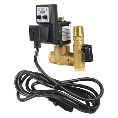

I have a 5 hp Quincy with an automatic timer to blow the condensate 4 times a day for the last few years. There is no "spot" on the floor.
