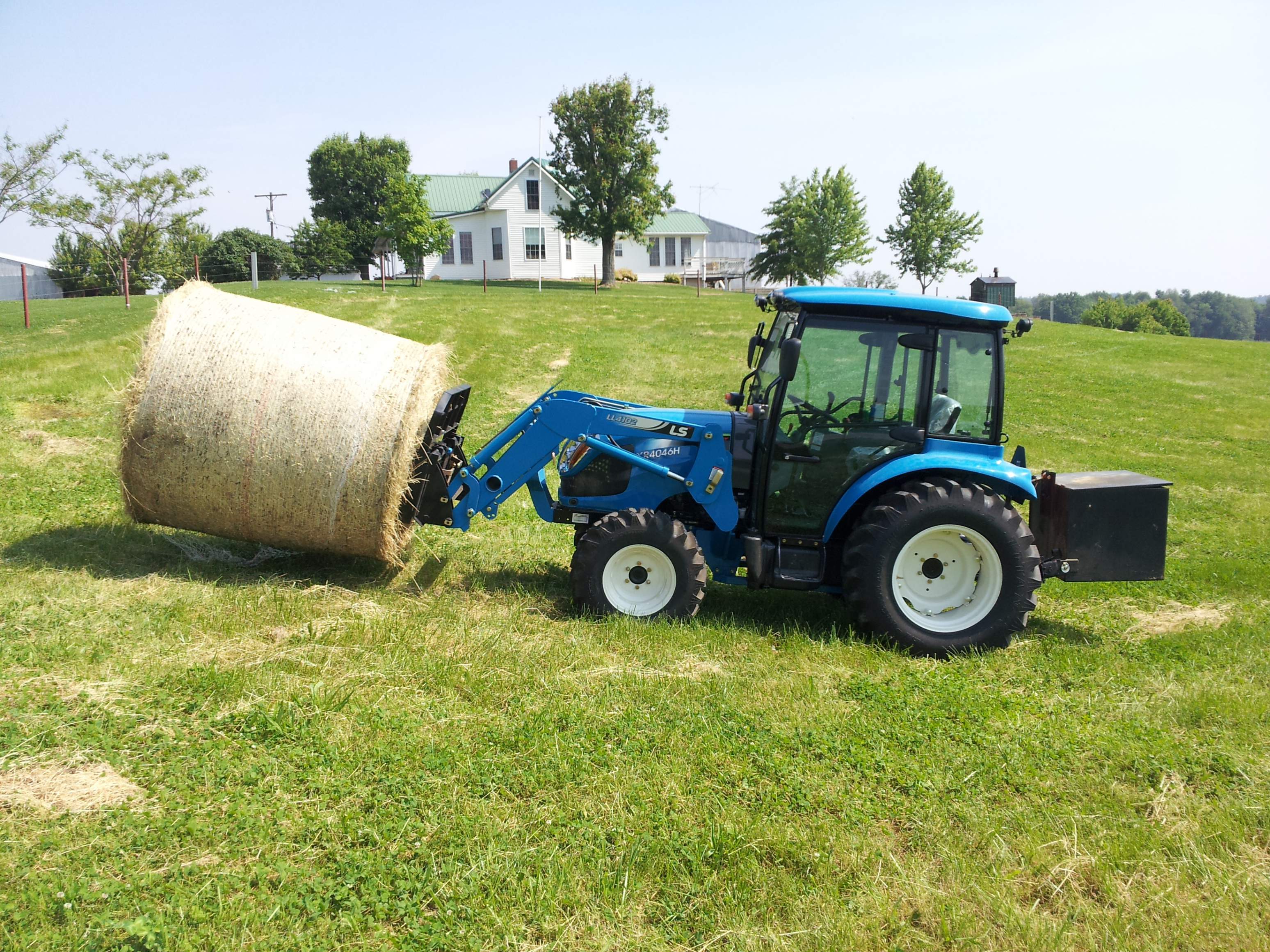

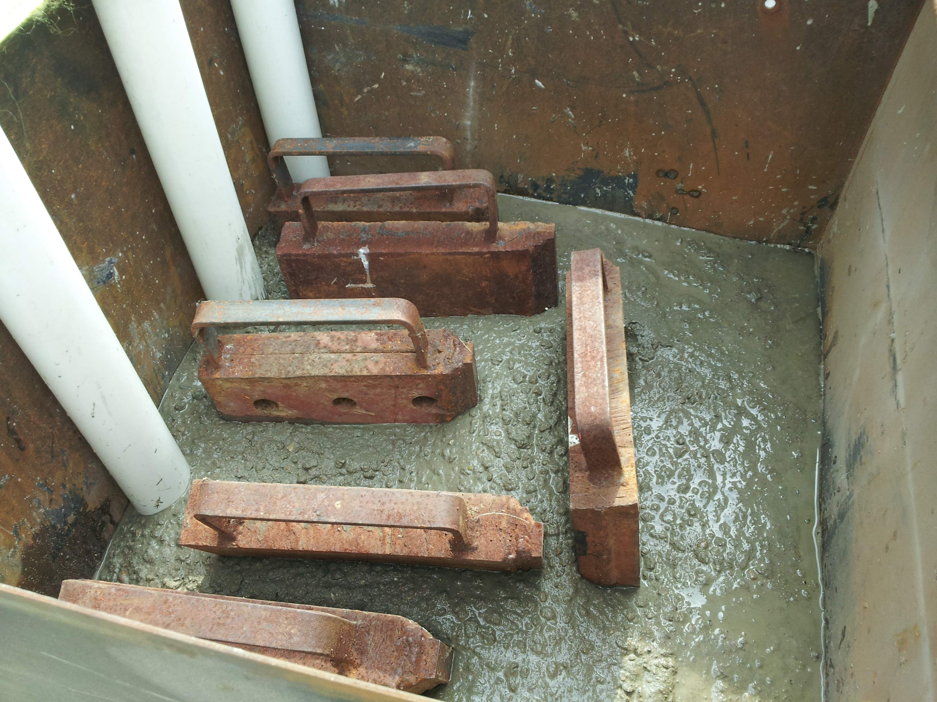

I did like most above and added pvc. Even though I keep it parked under a roof, I did drill drain holes in the bottom of each for "just in case". Rather than a barrel, I was very lucky to find an actual ballast box for next to nothing. With the steel inside the concrete, mine weighs around 1500 pounds.
I love your post,.And back ground. Thanks for posting,..Eric
