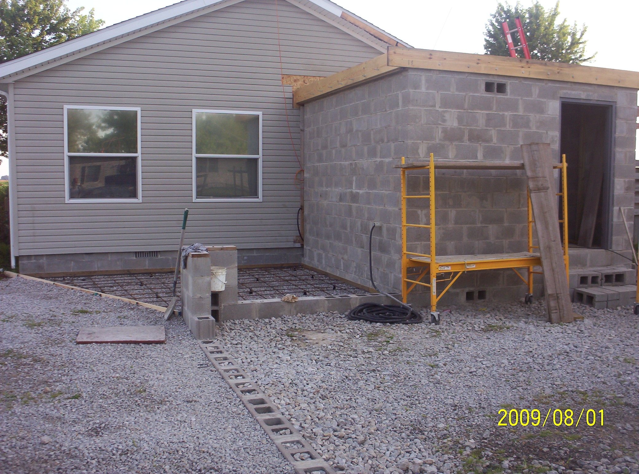

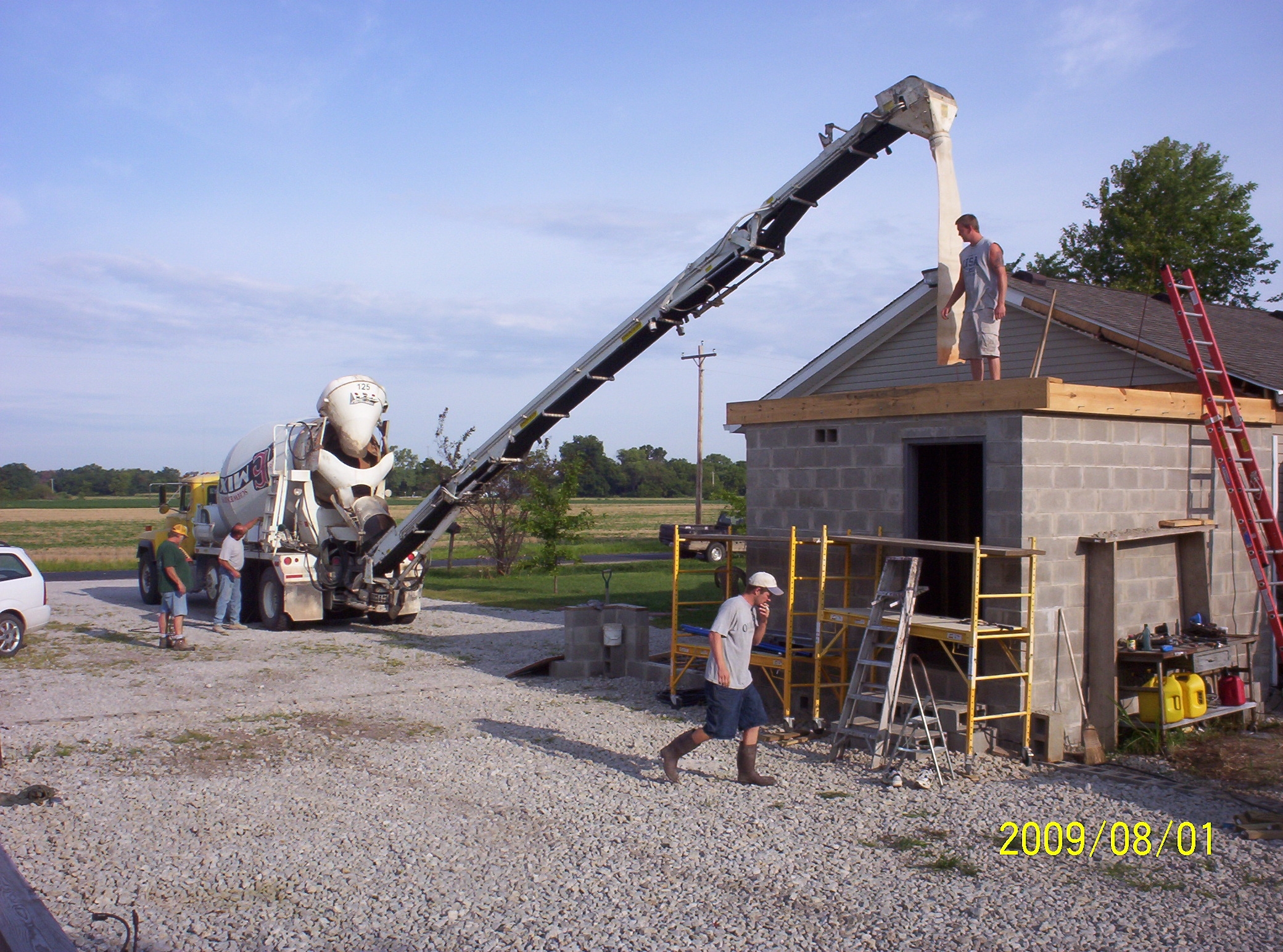

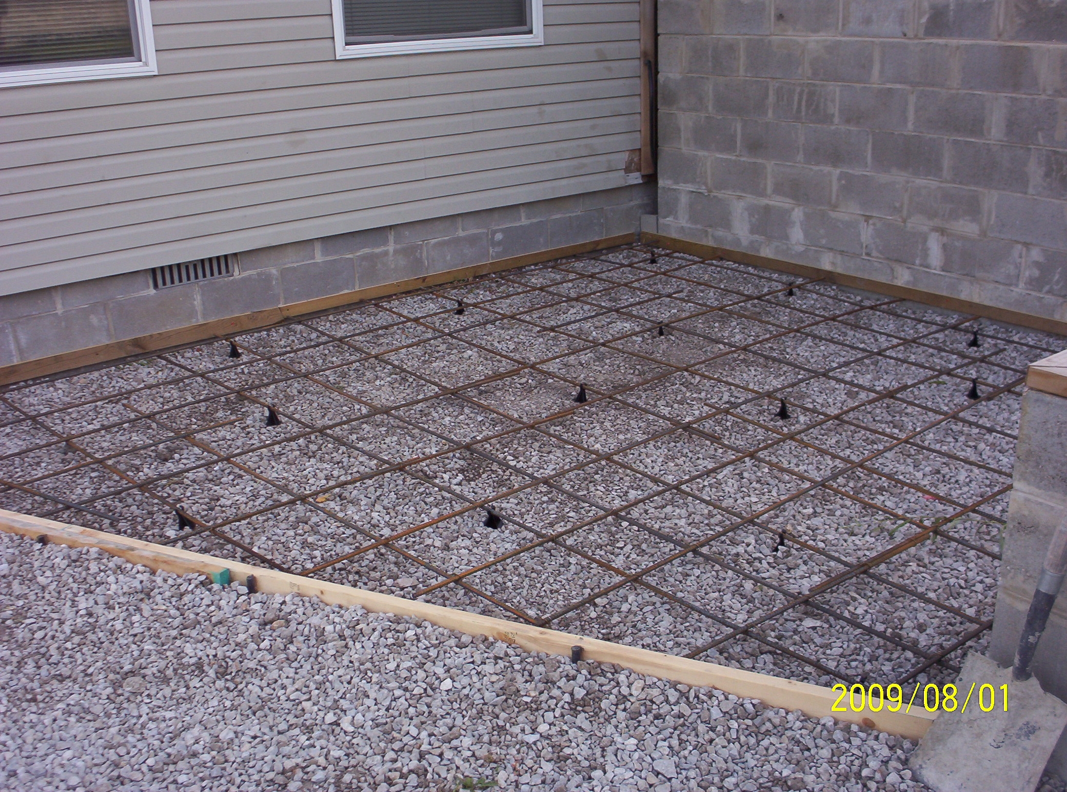

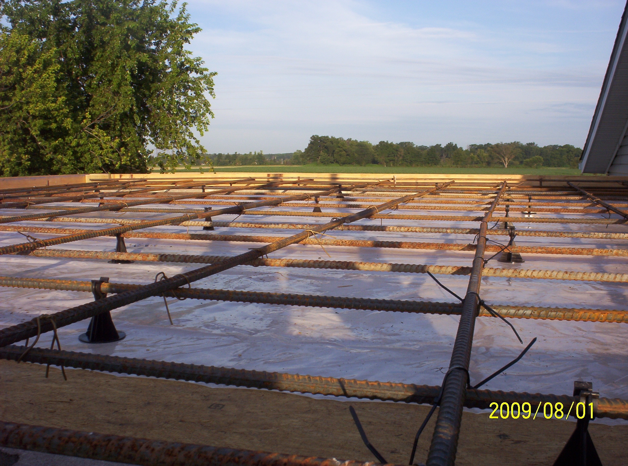

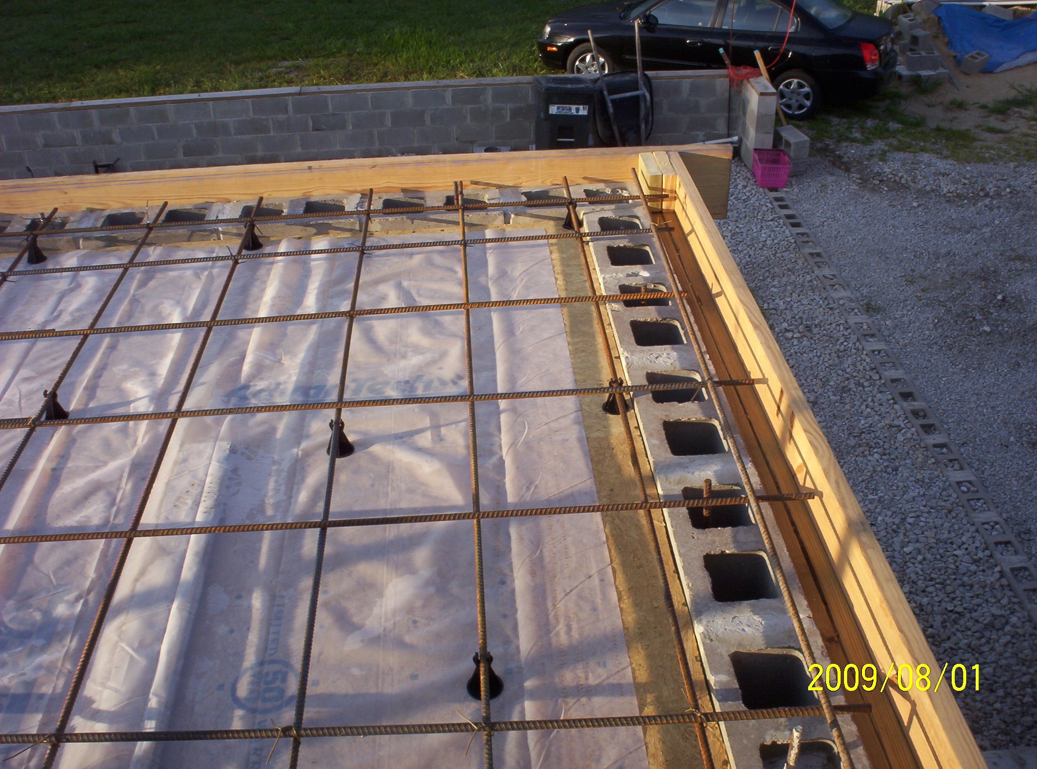

This is what an homeowner can do, by following Eddie's advise.
Side note what motivated me to build this a few years ago - an above ground storm shelter with a 4 car garage was all of Mr. Walker's posting. Building the lake and all of his challenges like the dozer fixes.
Can't find the garage floor photos - 2" 4x8 foam boards, rebar on plastic chairs sitting on form board 600 feet of 1/2 pex tubing attached to rebar on 3 loops for a 28X40 5 inch pour.
