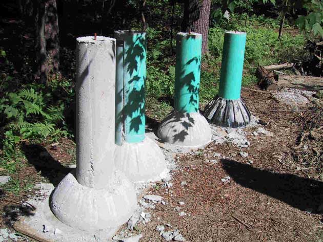

   / Concrete columns #16
similar concept used for our porch, not home-made. see attached picture...
   / Concrete columns #17
oops, wrong picture, sorry....
   / Concrete columns
#18
Those look great. I see you are using the bigfoots. Those cost around $20.00 a piece where I live.

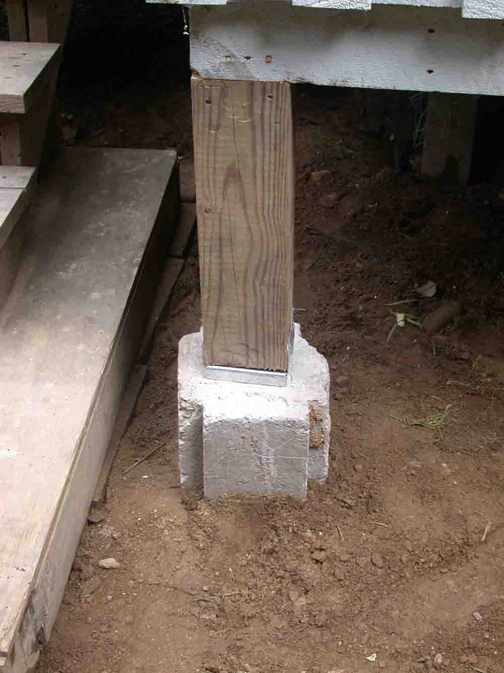

Hi All,
We were able to get all the exterior columns put in this summer. See photos. The problem we have now is getting the ones under the camp replaced. We have an approximate 2-foot crawl space under the camp. The floor joists run over three main runners (2x12’s). We replaced all of the three main runners with the concrete columns, however, we still have nine telephone poles under the camp which need to be replaced. I am looking for a way to replace the columns underneath the camp. Any Ideas?? /forums/images/graemlins/confused.gif
