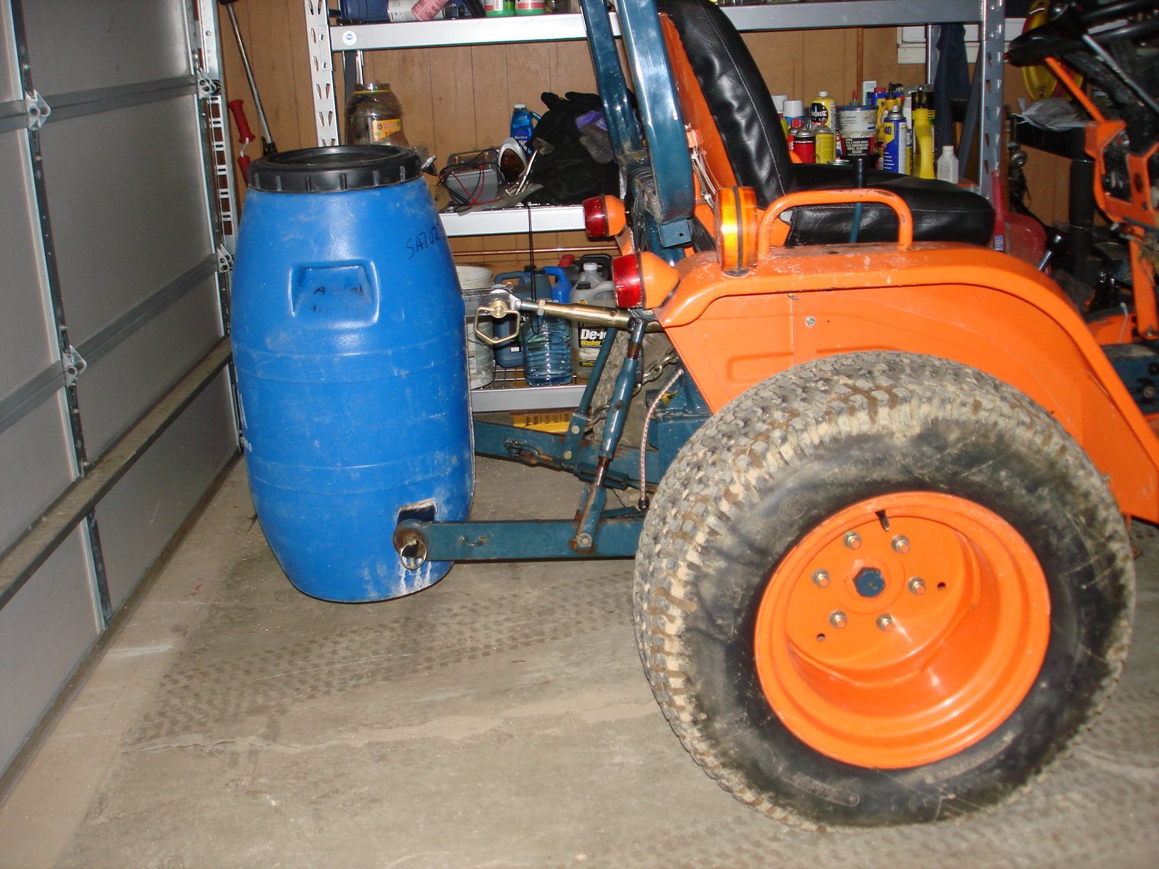

I read the Quickcrete 5000 bag today, and it said it reached 2500psi in 3 days, 3500psi in 7 days, and 500psi in 28 days in a full cure. Well I felt assured, and put it on and worked with it toay, and see no signs of issues. I'm impatient, always was....:eek:
