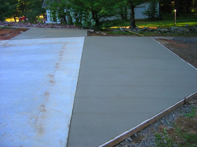

I completed a patio in pavers. It seems in the heavy frost country the move up and down and the faces of some just flake off. I don't care for the color fade or the maintenance.
I'm doing the drive in cement. At a hundred bucks a yard it isn't cheap but it will be there for the next twenty five years. It keeps the granite rocks and clay out of the house also. Good luck with your project.
