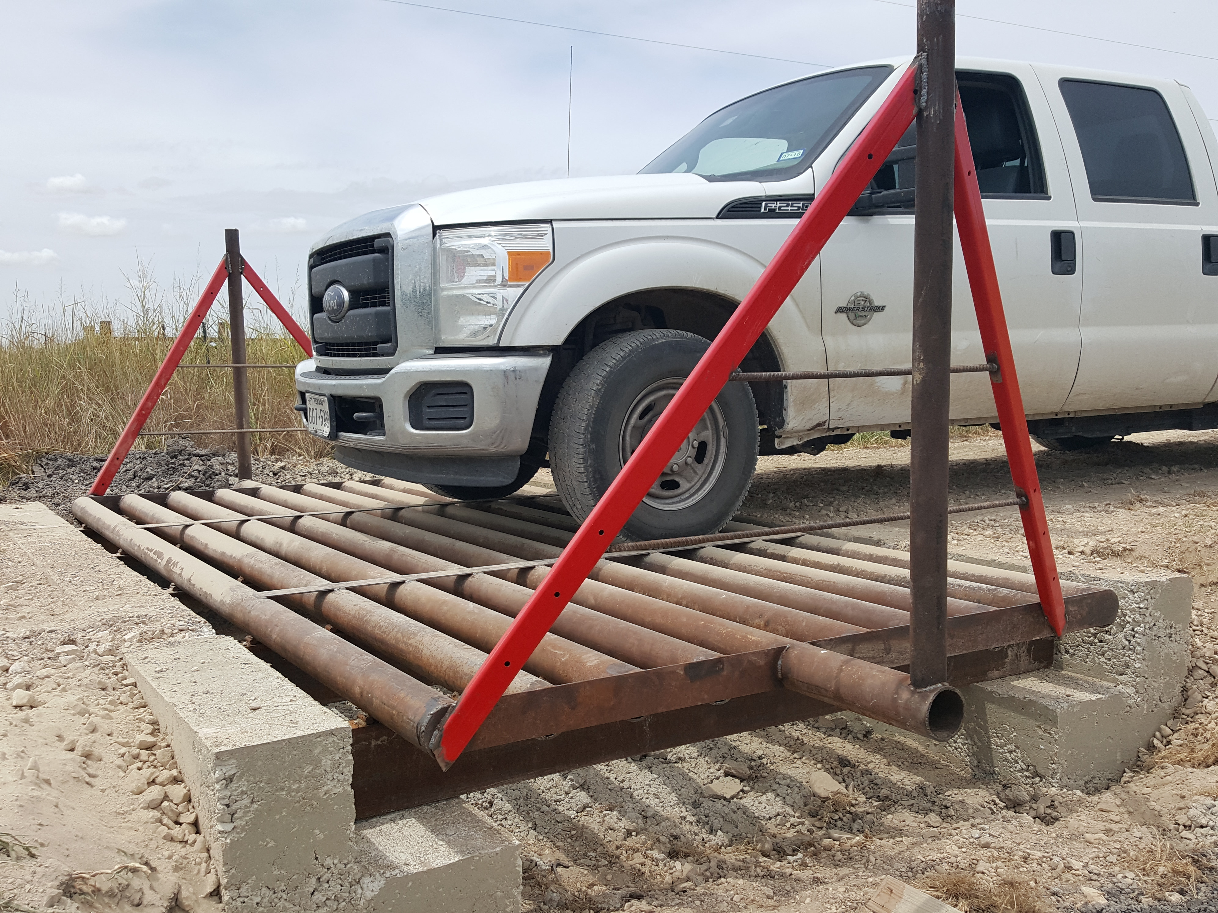

Not perfect but will do the job i think. I learned a lot about concrete, including 3 yards is a lot of work by yourself when its 102F
When did you pour that? I wouldn’t put the load of a vehicle going over the cattle guard, or even really the guard itself for a week.
Concrete reaches design strength in 28 days and continues to get stronger after that. A general rule of thumb is for non structural things seven days is adequate to put it in use like driving on a driveway, building a house on a slab, etc.
Maybe time flew by and it cured long enough but it seemed just a few days ago there was discussions on how to do it.
Maybe time flew by and it cured long .
Its only been 5 days. I had to get the guard in because rain was coming (hopefully) and i'd wouldnt be able to get to my place. I drove across it a couple times and now it will have time to cure for at least 5 more days.
