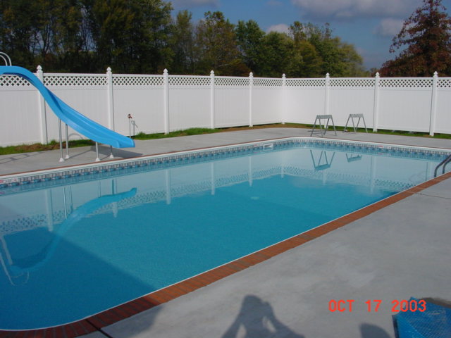

I did several hundred feet of 7' tall privacy fencing around my pool and, even though it was a workout, I mixed all the concrete in a wheelbarrow by hand. For a 7' tall fence all of my posts were 10' vinyl posts. Per the manufacturer, as I bought directly from them to save money, I used five 80 pound bags of concrete per post. If I remember correctly, and I may have it backwards, it took 2 bags outside the post and 3 bags inside the posts. Each post also got two half inch rebar rods inside them that were 10' in length to make the concrete posts stronger. I literally had to climb a ladder and 'spoon' trowels full of concrete inside the posts until I had them within 1" of the top.
It was a major PIA, but now I'm glad I took the time to do it right. We've had several storms with winds in excess of 70 mph and the worst I've had was one section between posts blow out. All I had to do was go fetch all the pieces and put them back together using a stiff scraper. My posts are extremely solid and will not move. As harv said, unmixed bags of concrete bust up really easily and the posts can be lifted out.
I took all of the "bad" bags Lowes had. You know, the ones they had stored outside and had hardened. All I had to do was whack the bags a few times with a dead blow hammer and they were back to a dry mix. Not once did this not work. They all felt like yellow 80 pound bricks when I picked them up but each one easily broke up into the original powder mix with little effort. I definitely didn't want my fence to be set that way.
Attached is a picture of the fencing I put up this way.
Nice Fence.....beautiful work! I've got a couple of vinyl gates where I filled the posts with rebar and concrete. Unfortunately it's only a 10' gate because I was told that was the limit. I've hit it a few times hauling equipment through there and have destroyed the post on the latch side. I only bent the hinge on the side filled wth concrete. It's solid as a rock. I'm going to put in another concrete filled one and hang another gate for a 20' opening. It's amazing how strong they are when filled with concrete.
