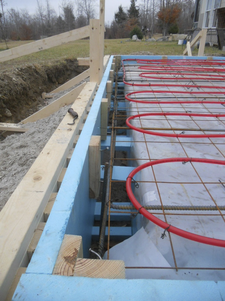

Any concrete work I do for myself has lot's of bar in it. This is a little frost protected shallow slab with a 2' "turndown" @ the edge, there's 2 rows of horiz bar just in that.

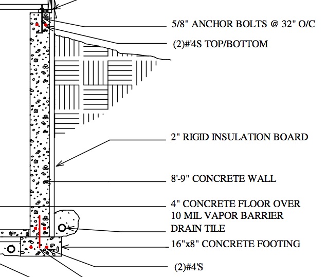

OP: what do the approved plans call for?
The only mention of rebar is in the wall section view (see attached for an excerpt of that). It is:
2 #4 at the top of the wall, 2 #4 at the bottom of the wall, 2 #4 in the footing.
This is less than I wanted and is this way because the draftsperson couldn't manage to copy my plan correctly which called for:
2 #4 at the top of the wall, 2 #4 in the middle of the wall, 2 #4 in the bottom of the wall, otherwise, code compliant.
There is 1 #4 at the top of the wall. The rest isn't there.
If this is the design given to the contractor and he was to build to this spec you are hosed. A 9' wall, even with the best soil (non expansive), needs to be thicker than the 8" depicted and contain more rebar- both vertical and horizontal.
Edit- Sorry I didn't see your post with your replied above. I took the time to look at your other post with photos. The concrete job isn't the best. I see several issues in the photos.
If the contractor was also the drafter you are back in the clear. The contractor's design and workmanship are substandard IMHO.
