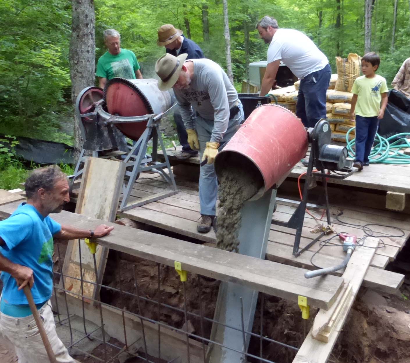

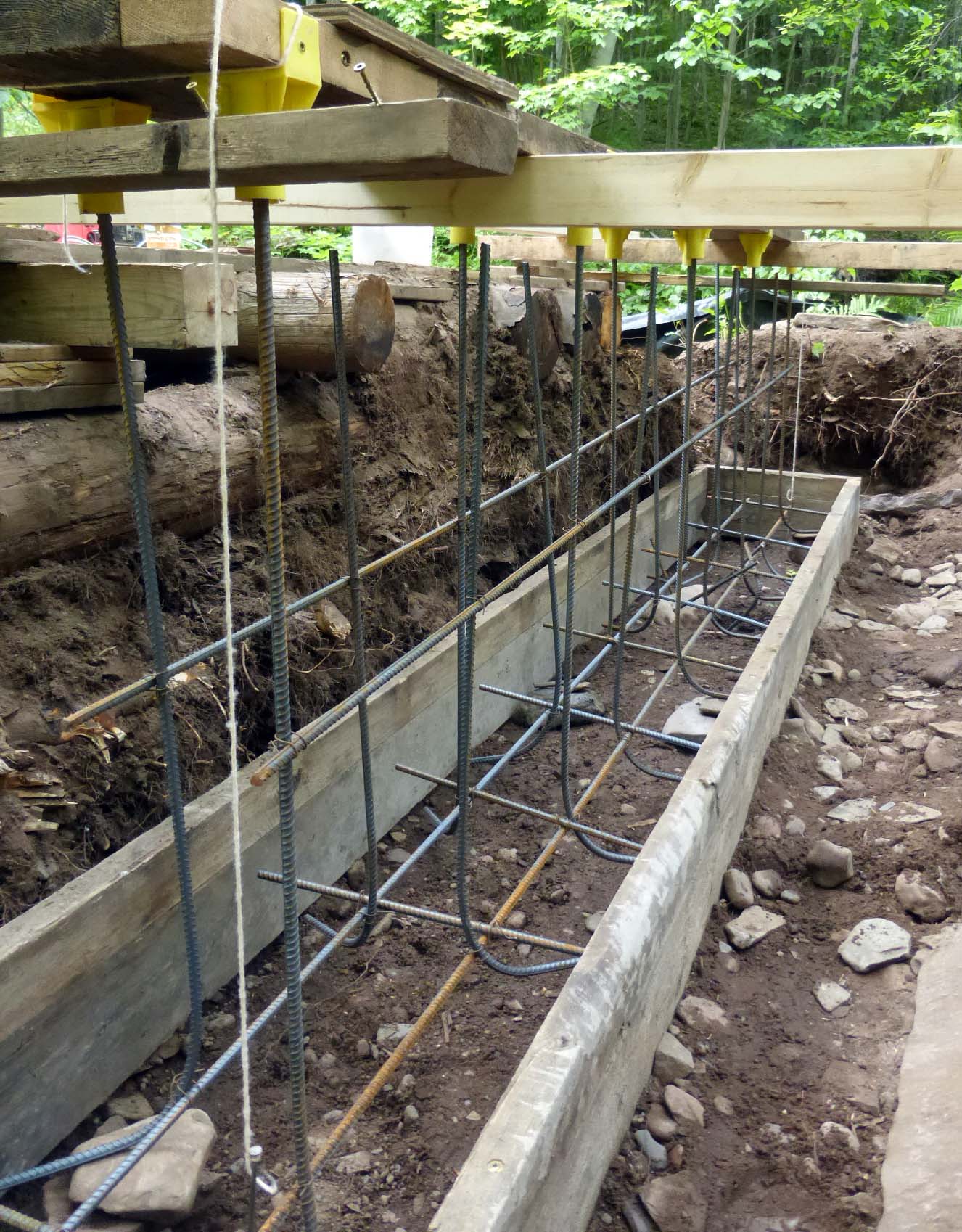

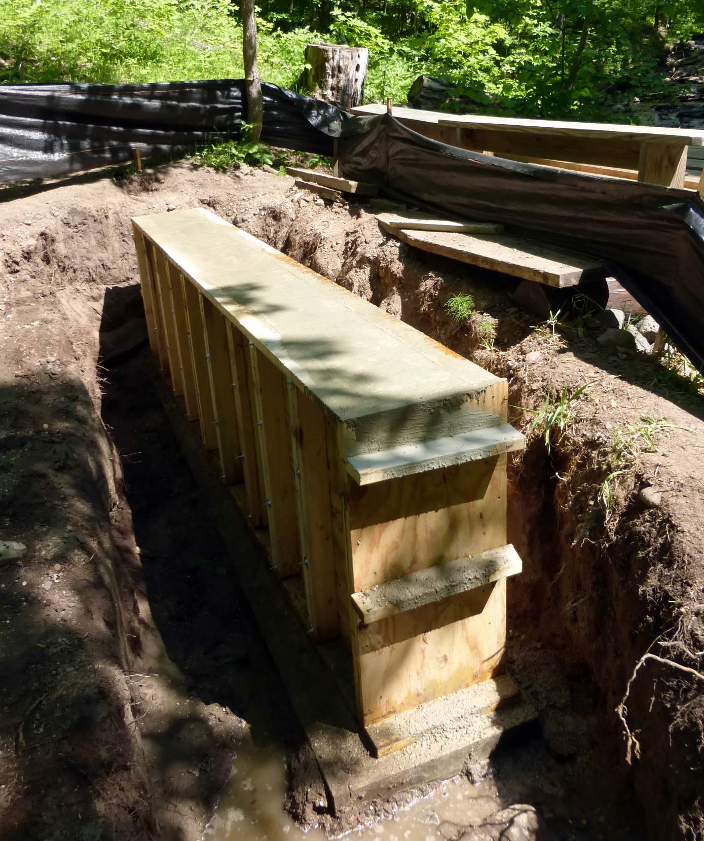

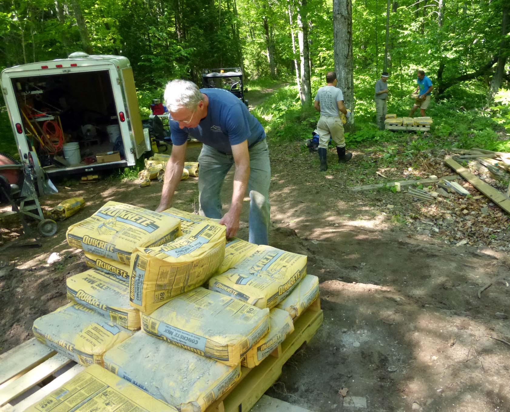

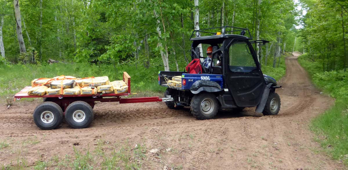

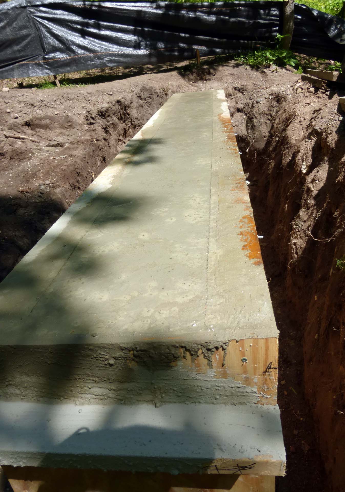

We had a bridge to do where we moved in 100 bags of premix to and poured two bridge abutments. We could not get a cement truck to this job. Each of the abutments took 2 pours and we moved the premix in via UTV trailer. The footings were 2ft wide and 12ft long. Each pour took about 4 hours to mix. Does that help?
