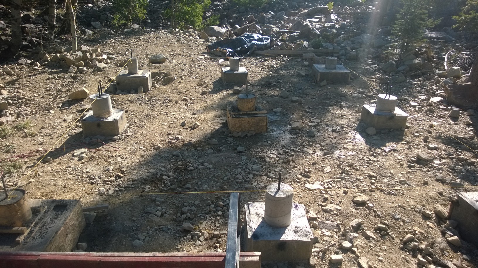

   / Concrete foundation without a cement truck #12
Two summers ago I started my cabin, it too was where no cement trucks could get to. We had an electric cement mixer and 250, 80lbs bags of concrete. We planned to spend 1 entire summer just on the pylons. We hauled 1 pallet of concrete at a time, 50 bags, and were able to get 1-2 pylons a weekend. It was some of the hardest work I've ever done. The result was rewarding.
Just jump in and get it down. That's what I did...

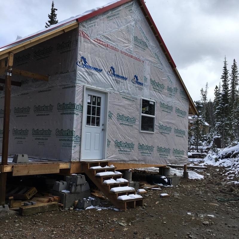

   / Concrete foundation without a cement truck #13
Here's another angle and right before the snow started...

Those are some pretty skookum looking piers Snobdds! Making me re-think the pier vs. poured foundation question.
Pylons are the way to go for a cabin. That way you don't have to do the entire pour at once and it can be broken up into pieces. If you have any deep snows in your area, it helps to get the cabin off the ground. We get 10+ feet of snow, so being 4 feet off the ground helps so much with snow depths.
