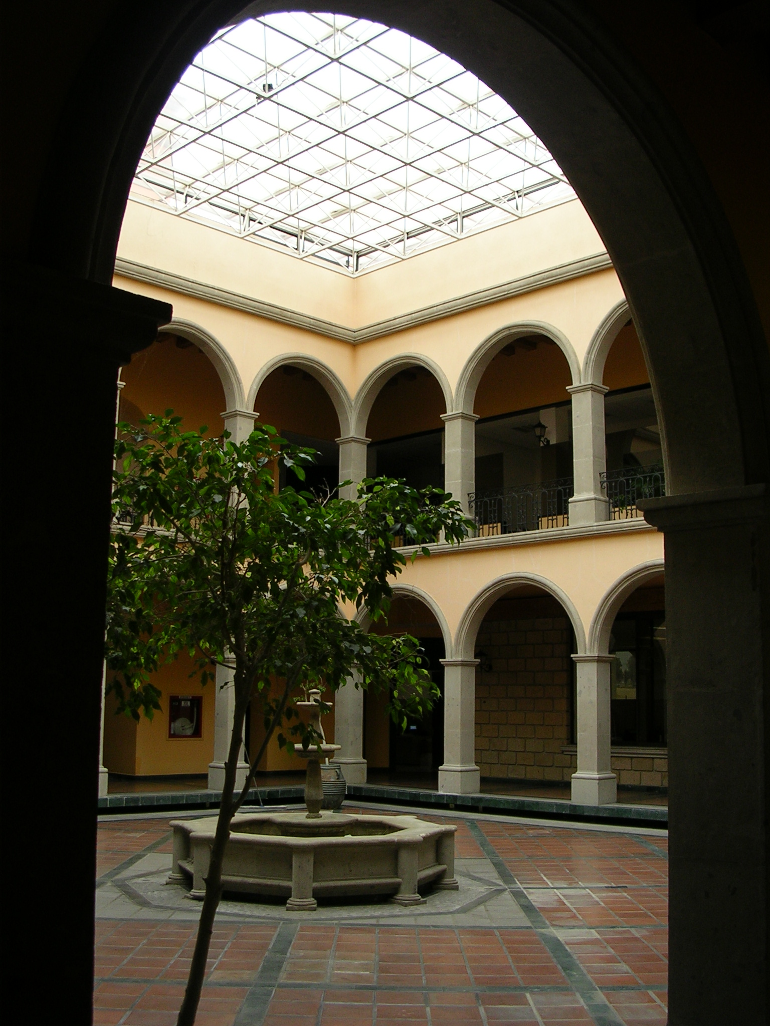

#79
Here is the look I'm going for inside. This photo came from Mexico on a biz trip. My open space is 30' by 30'. Not as big but I hope it will get the feel.
Patrick T

   / Concrete ICF home continues #80
Nice...I was wondering what your house's style was going to be. If you have any sketches or renderings of the intended result, I hope you'll post them here.
