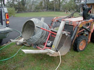

Hey Paul, You wouldn't have a make and model ID on that PTO mixer, would you? It sounds like it cures one of the major shortcomings mentioned in this thread.
   / Concrete mixer (PTO) #12
Here's the picture, Greg.
I had made a set of light duty "forks" out of 2 x 4's a couple of years ago following an idea someone else here on TBN posted. The vertical portion of the fork wedges up against an angle-iron lip I put on the top edge of the bucket. They're surprisingly strong and I've used them to move a pallet with a couple of concrete blocks on it (my loader capacity is only 550 lbs).
Anyway, being wood, they made a good and easy base to attach the cement mixer head to. They can't tilt out from the top because of the lip and I threw a chain and chain binder around the horizontal wooden cross member I attached to them and up around the back of the bucket to the top lip. This keeps the whole thing from sliding out at the bottom.
It worked quite well except that the length of the forks meant I had to dump the concrete from about 18". If I'd shortened the forks I could have laid the concrete down with much more accuracy.
By the way, the hose reel on the loader arm is there for when I put my sprayer tank in the FEL bucket and drive around the property to spray. It's just held on by a pair of "U" bolts so I take it off after spraying season.
