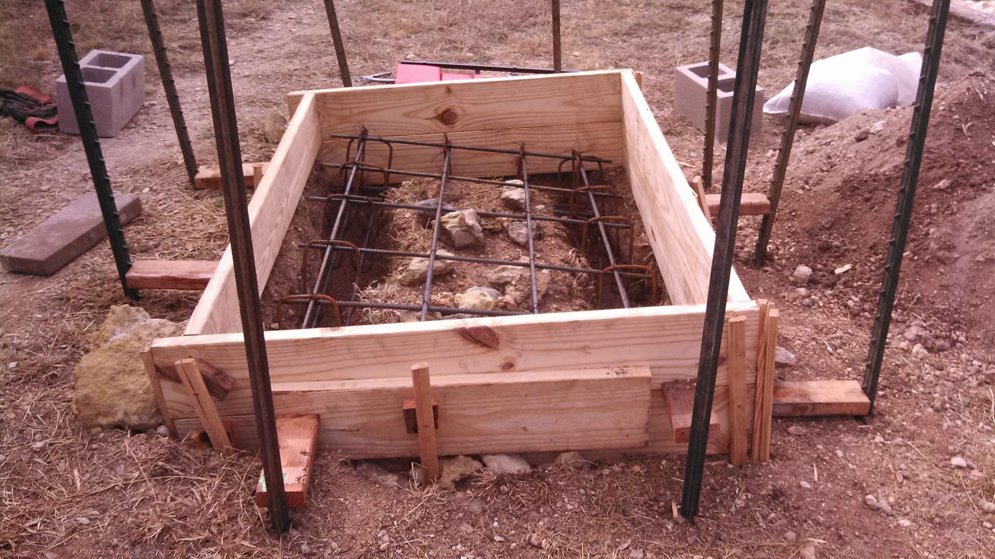

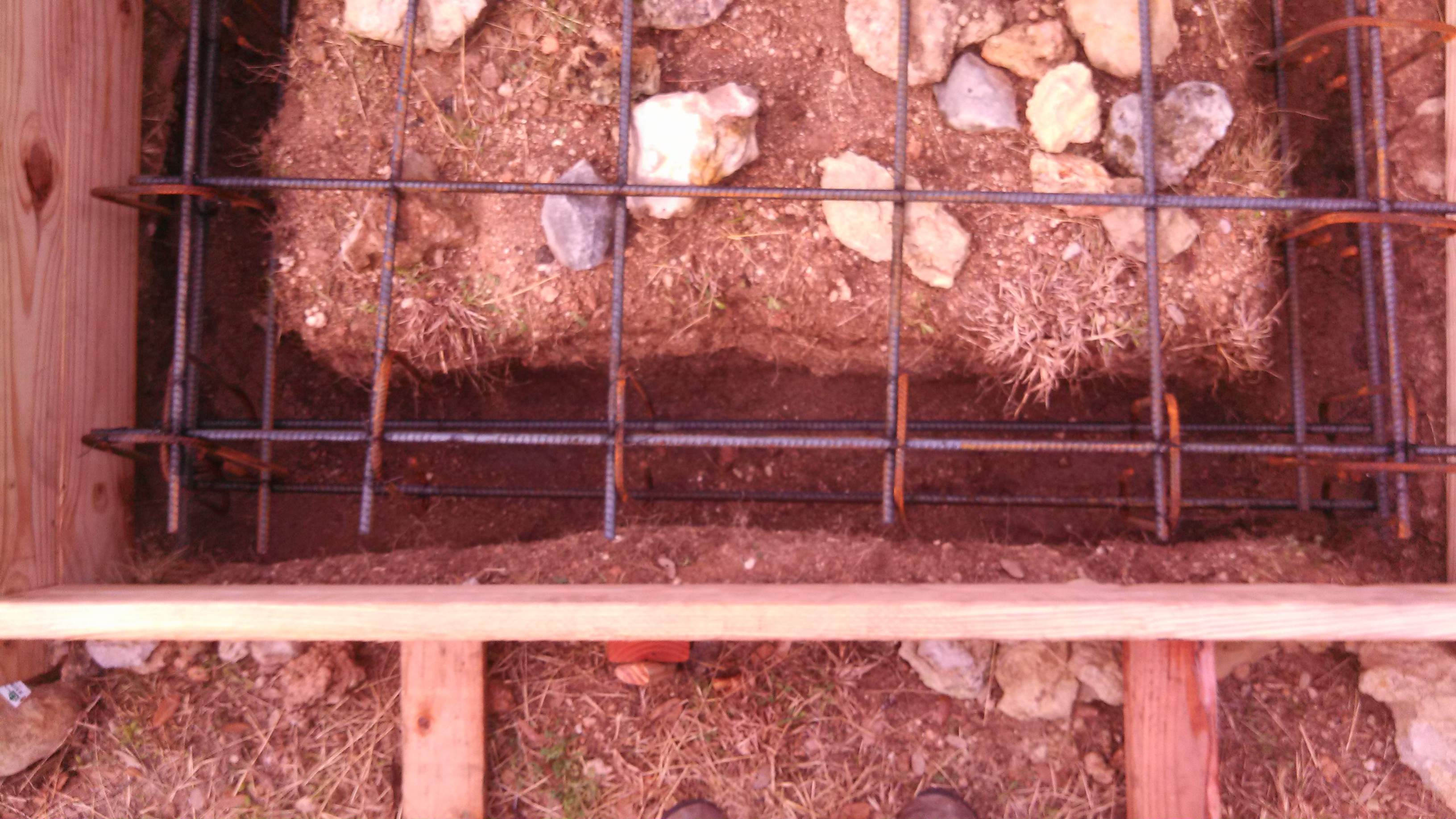

Thanks for the advice!
I'll be mixing the concrete with a mixer I picked up for my TC-30, so I should only have to deal with the weight twice - unloading it from the trailer and dumping it into the mixer. However, I'll definitely ask on the price of the 60 lb bags.
I had a bit of time to work on it this weekend and snapped a couple of pictures.
The ground is pretty hard and dry here with a lot of caliche, and driving in 2x4s is pretty much out of the question; on the plus side, the ground doesn't crack. The T-posts seem to hold well, although I'll have to cut them off at the top in order to get the mixer in there.
I finished the first level of rebar and am adding a partial second level no higher than 3" below the top of the form. I'll probably add a bit of gravel to the bottom of the footer, as I made it a few inches deeper than I needed to.
