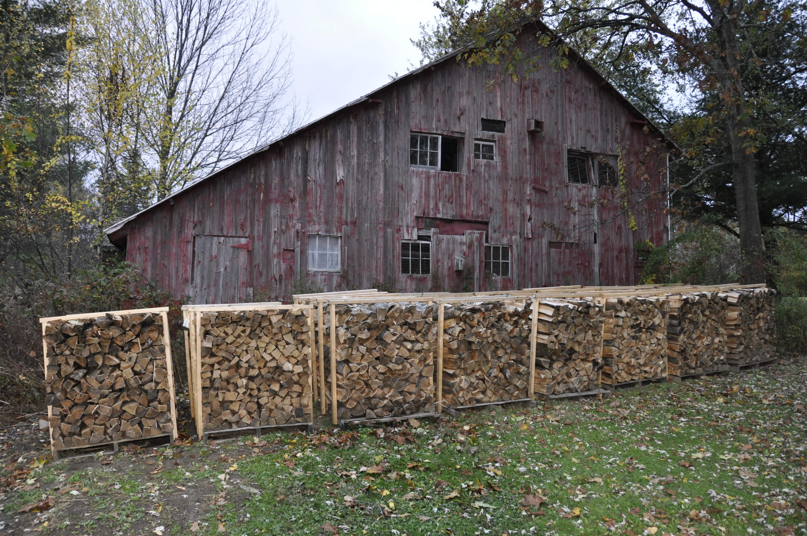

sounds like a pain in the rear to deal with moving pallets back and forth via pallet jack. a chunk falls, and snags up between pallet you want and another pallet. and you climbing over stuff and moving chunks here and there to get to the chunk that fell and jamming things up.
i think it would be easier... just to build a long "lean to" mini shed for pallets of firewood. were you could simply back up tractor adjust 3pt hitch and drop pallet. (double checking foot on brake pedals to get pallet up under the mini lean to.)
getting all the ants, and mice and critters that can come along with firewood... along with getting good air circulation through the stacked lumber to help it dry out... i am kinda scratching my head why you would want all that firewood up inside and against the shed.
other issue is moving pallets around. the further back pallet most likely end up going to be the dryest. but you will have a bunch of extra pallets in front of it you would need to move. to get back to the dry pallet of firewood.
goal of firewood it is suppose to be cheaper... but sounds like you are paying more for firewood vs some other fuel to heat with.

Boggen, as you know, the biggest hassle of heating with wood is how many time you handle it. Before using pallets, I would split and stack the wood on the sunny side of the barn, which is farthest from the house. Then before winter, I would throw it all in a 4x8 trailer, and make many trips to stack it in the woodshed in the barn. Last year I decided to stack it on pallets, and then moving the wood in bulk would be easy with the tractor. Last year once the wood was seasoned, I moved the pallets into the barn. All of them had to be put in via a 5' door, and dropped there since the tractor is too big to fit in woodshed area. So I use the pallet jack to move the pallet from the doorway into its final storage space. I can fit 16 pallets in the current woodshed. But the concrete floor is not the best, and moving the pallets around was difficult. So I figured I could build a new woodshed next to the garage, which is even closer to the house than the barn, and make this process as efficient as possible. Unfortunately the location of the barn and garage prevent me from getting easy access with the tractor, and my access to the new 10x22 woodshed is via one 10' end. I can't access it via the long side or the back.
Oh, and the main reason for building a new woodshed is not the woodshed! I am putting solar panels on my garage roof next year, and the current roof is not large enough to hold 28 panels. I need an additional 6' of roof. So if I add more roof, I might as well use the space under it for something useful!
