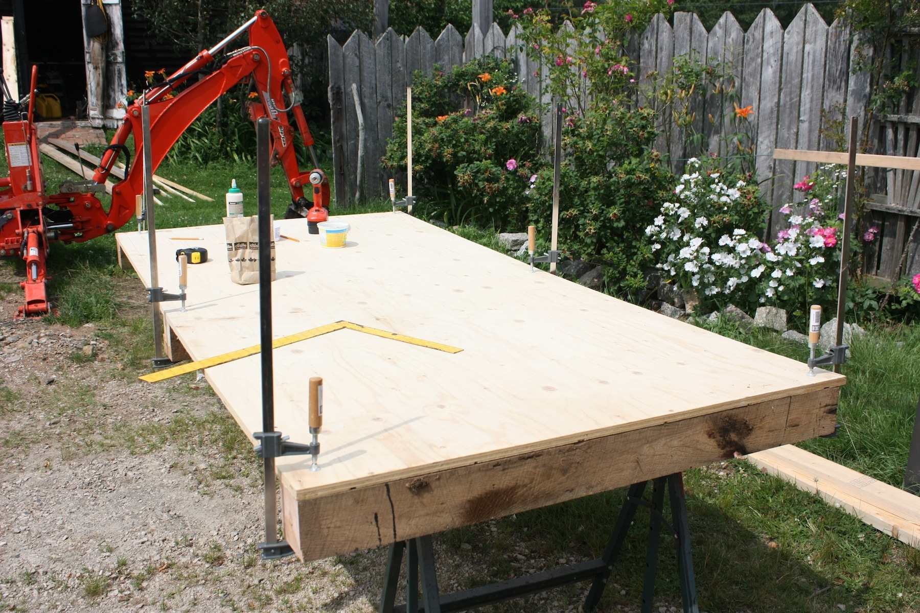

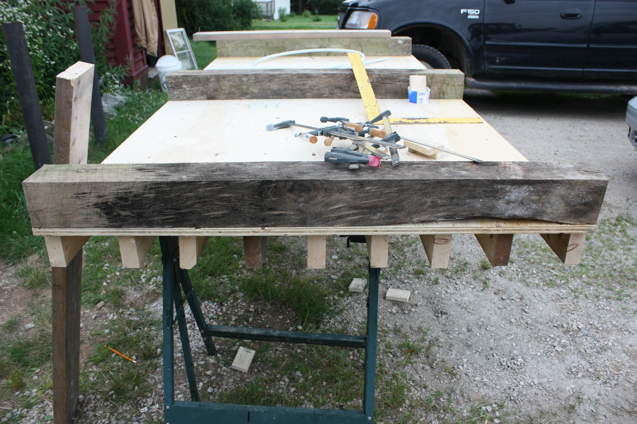

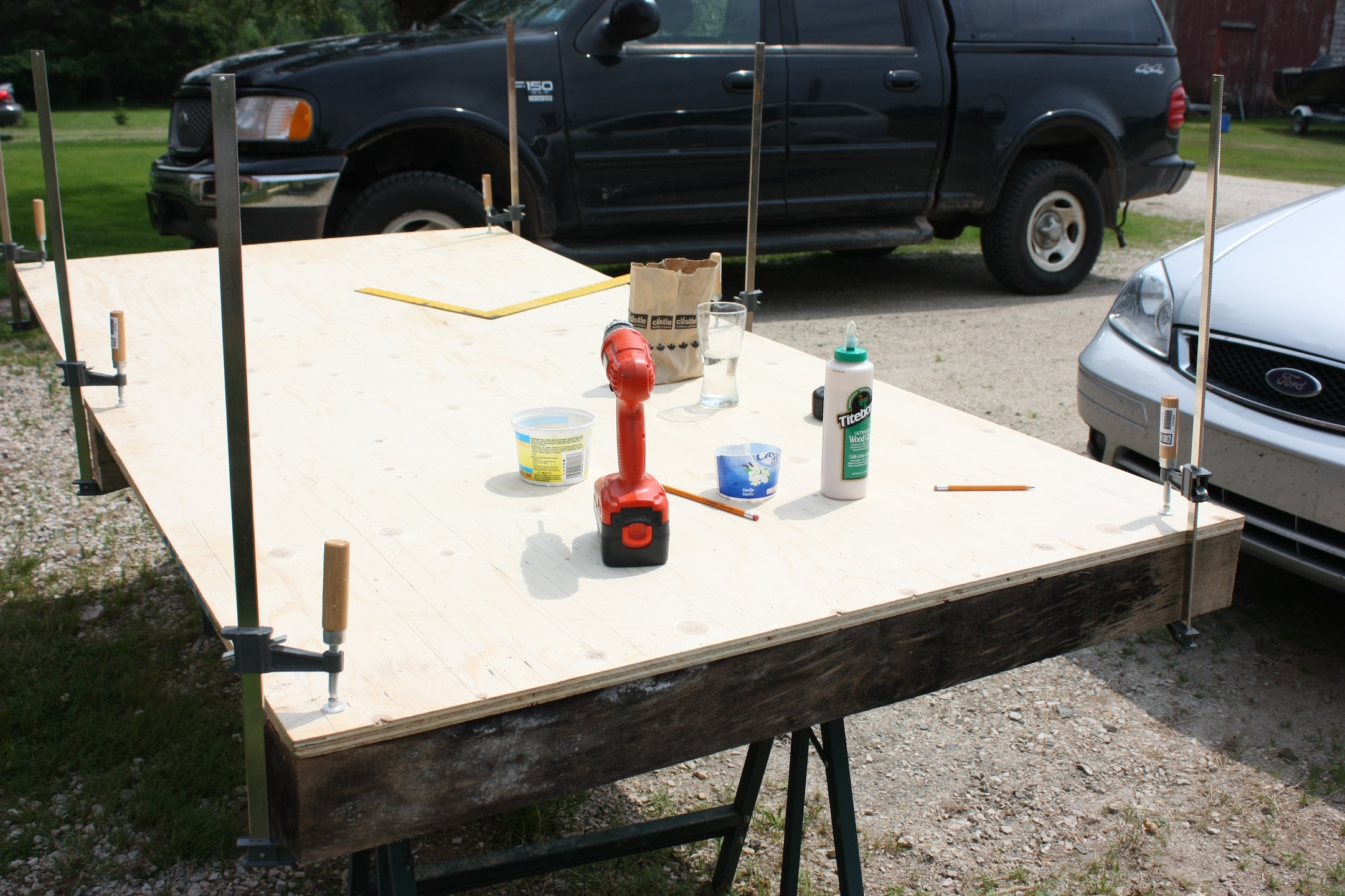

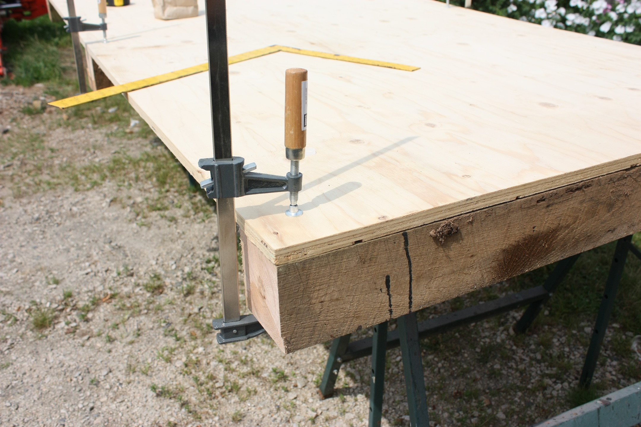

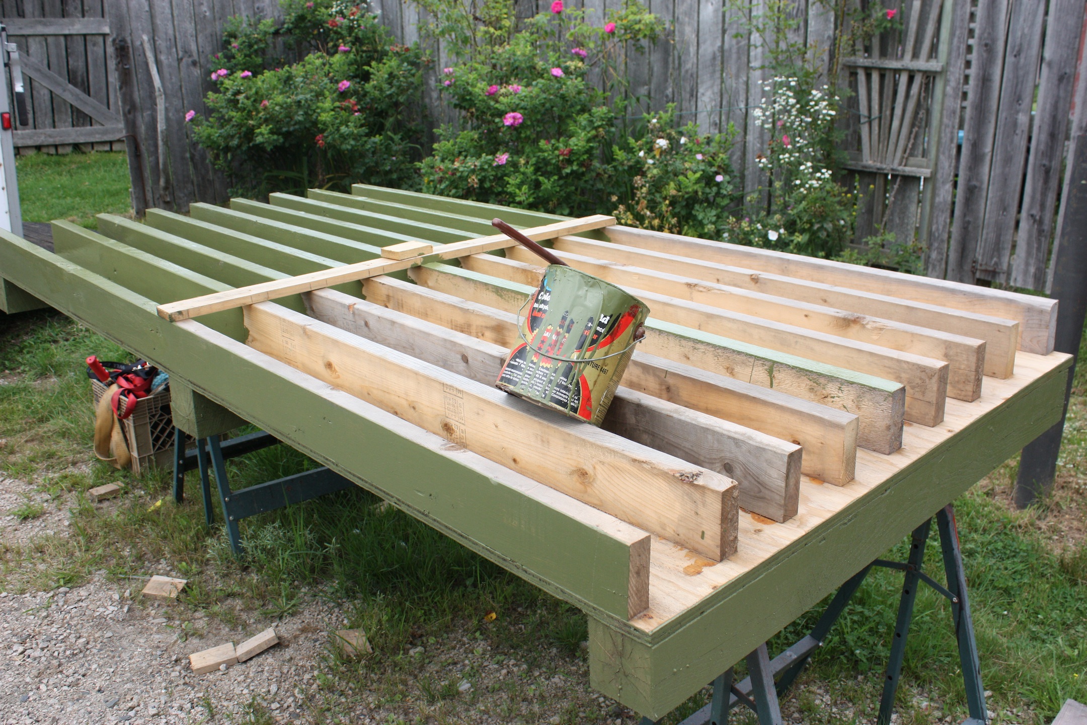

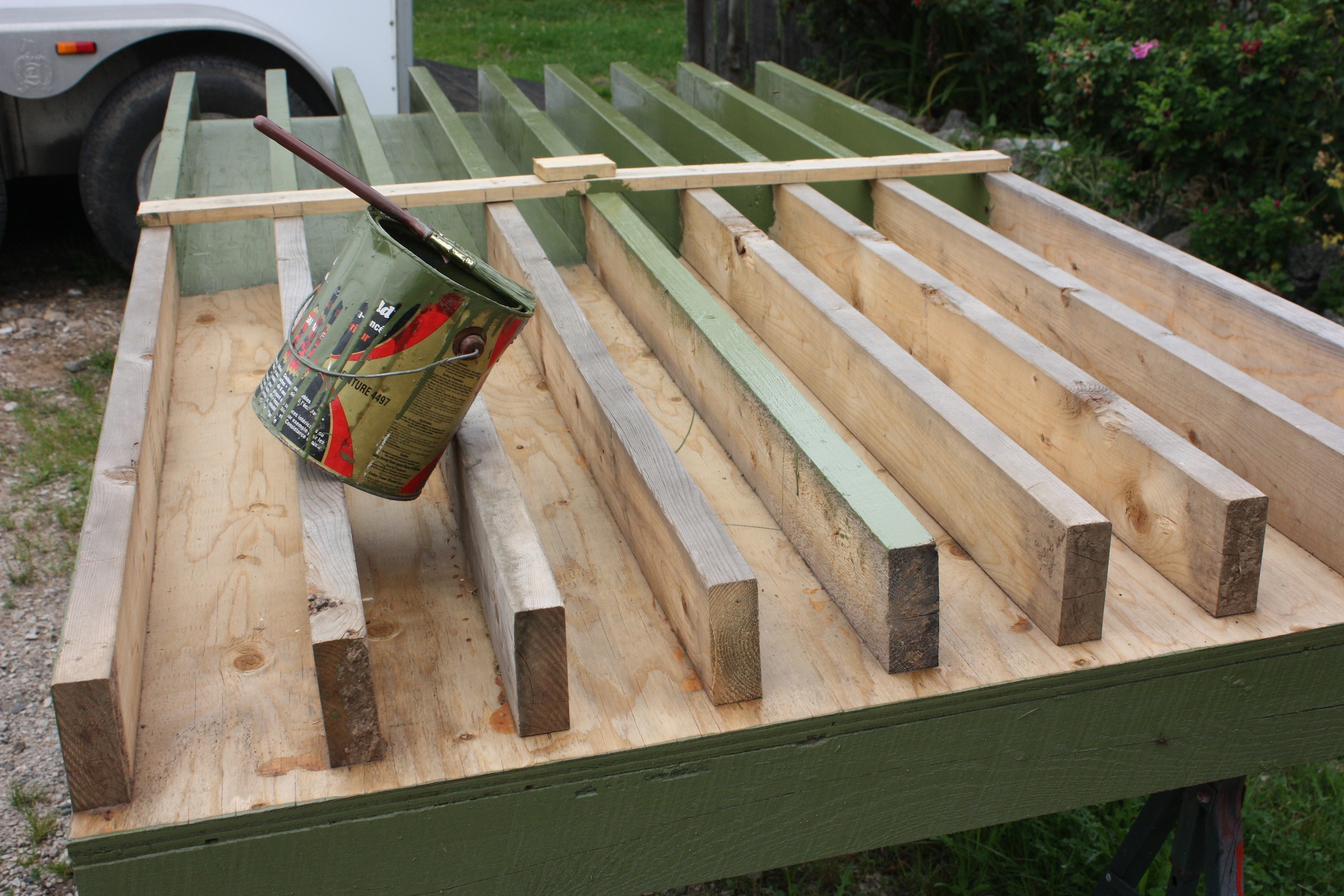

Ok... so the form is made.
We will be casting next week. We will get 6 4"x4"x8' posts plus 2 4"x5"x8' posts per cast.
I will mark 42" and 48" reference marks on concrete for hole depth. We are planning on placing 3/8"ID tube cut to 4" at intervals in the mould before pouring. The plan is to bolt a sacrificial vertical 2x6 to the concrete post. We can then nail the existing rails to the wood.
The 2x6 will be well above the ground as not to attract moisture.
We estimate post will be between 65 and 75 lbs each - I originally wanted 6"x6"x8'!!!!!
A 2x4x4" gets lag bolted on each end. These can be removed after the cast and set-up
and will hopefully assist removal. I gave the unit a quick coat of oil base paint and we will be using (trying) various release liquids.
Will keep you posted.
