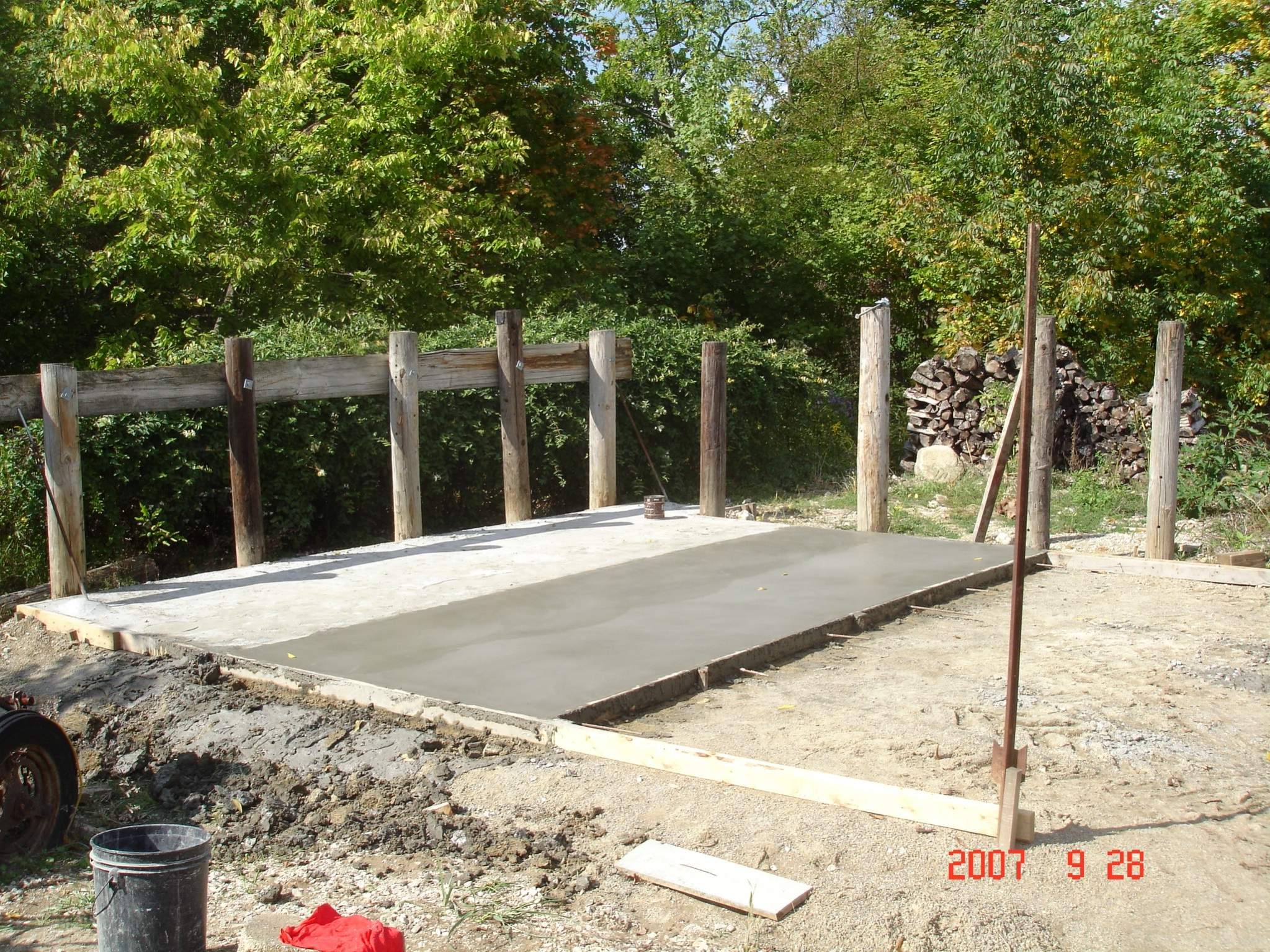

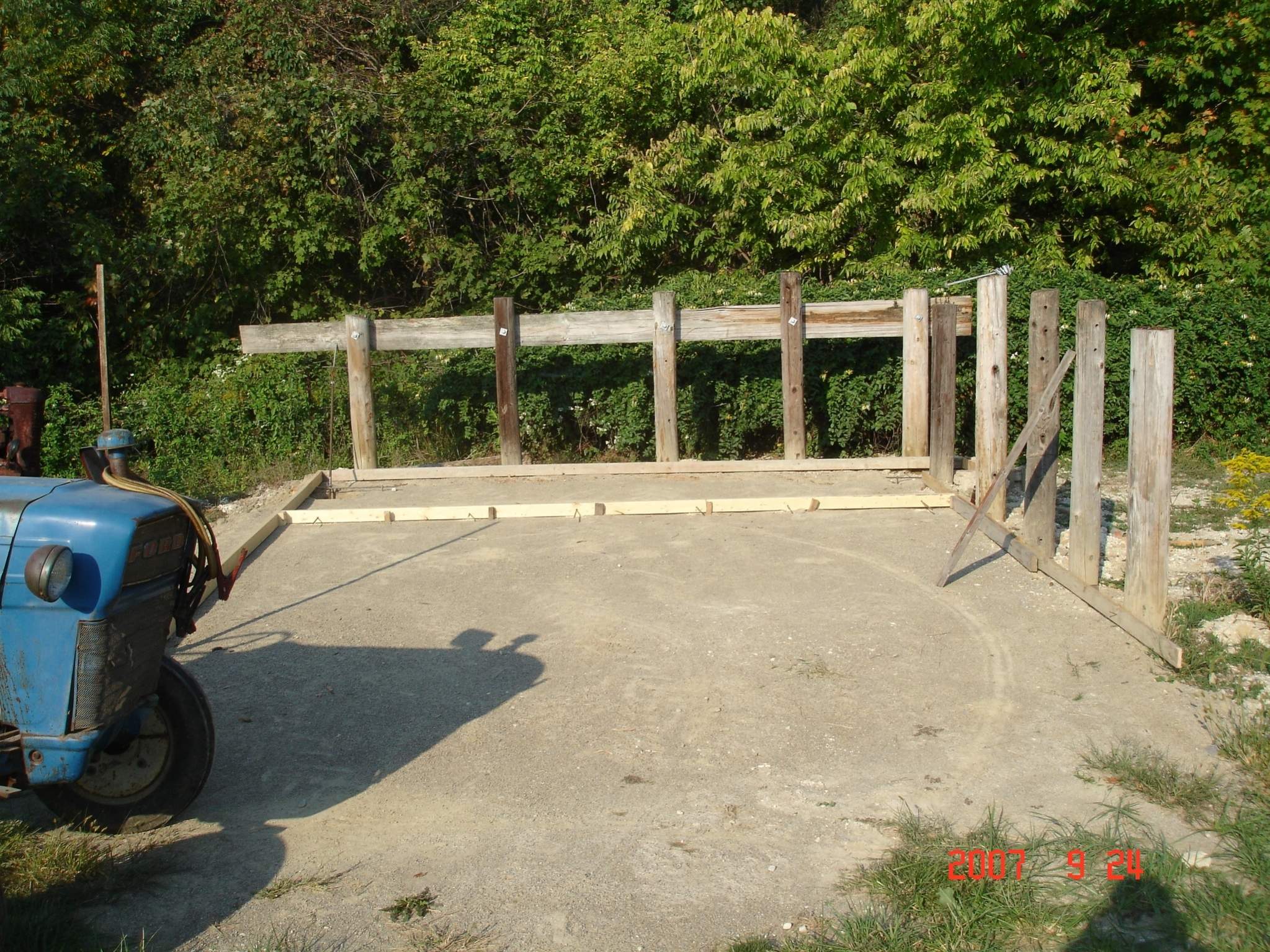

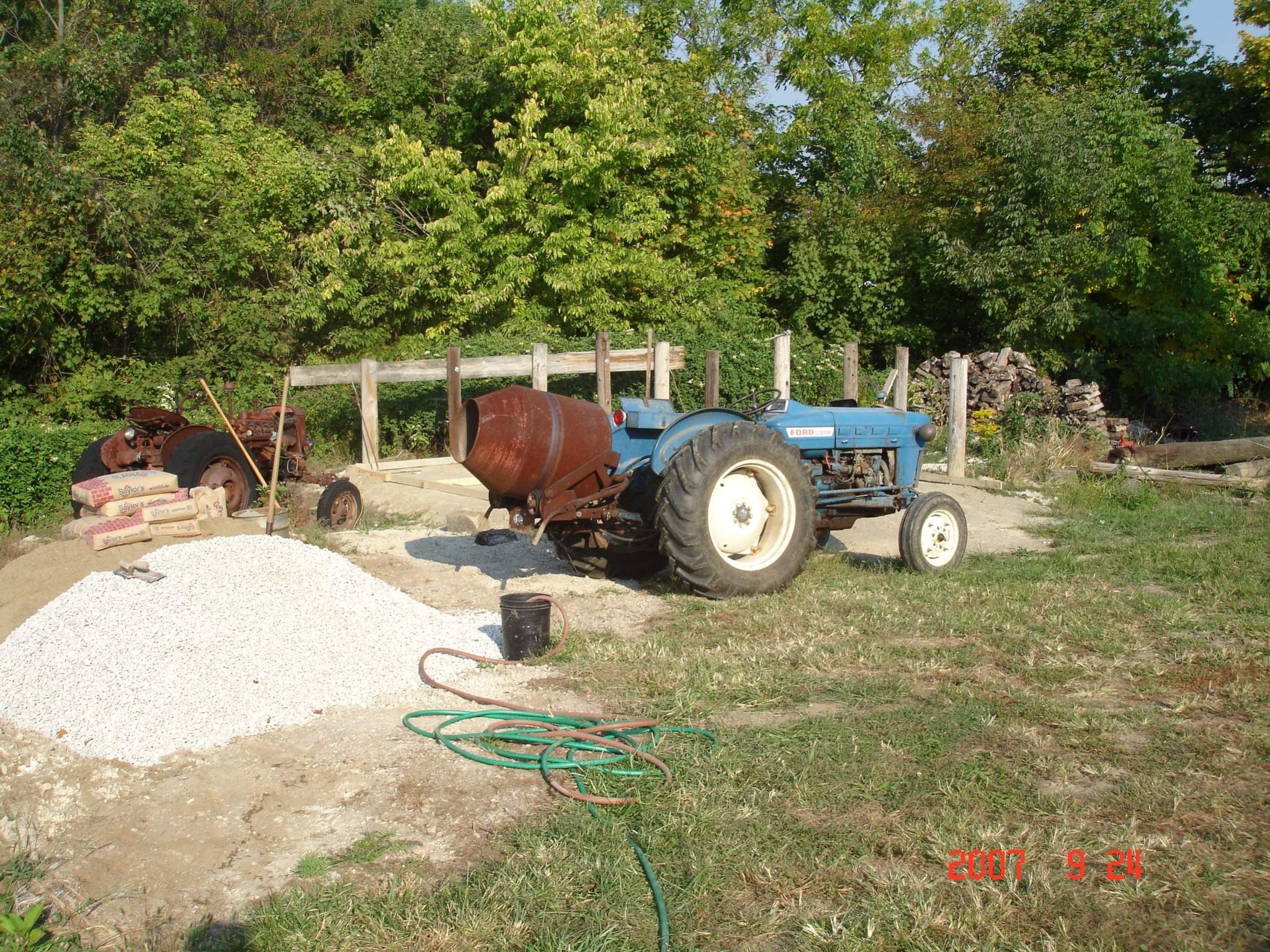

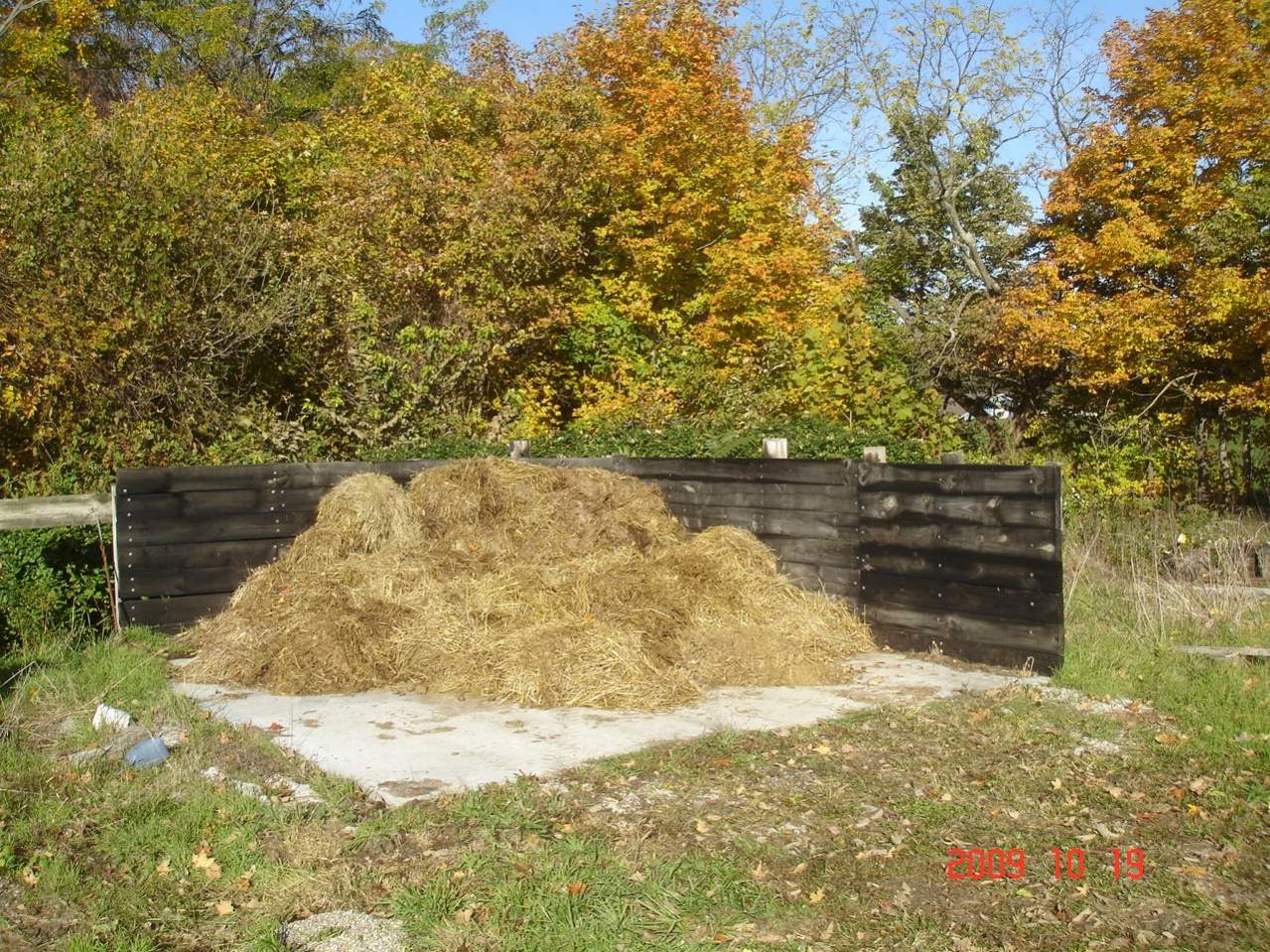

Here are some pictures of a manure storage bin I built, about 2 years ago. Got tired of boring in the mud loading out manure. Just tough to beat loading off a concrete slab..!!
I mixed the concrete myself, with my trusty old Chreokee mixer. Ended up being like a 9 bag mix. I used old fence for reinforcement, and placed 3/8" pins to tie the slabs together.
I used concrete wash out for fill. Great stuff if you have a concrete plant nearby. Ours here shoots remaining loads in a pit of water, then piles it when the pit gets full, for fill material. $10.00 for a single axle load, $20.00 for a tandem load. They gave me a break with my ton truck @ $5.00 per load.
I used old telephone pole butts my girfriends dad gave me, when we rebuilt her fence. The backer across the back to push against, is a telephone pole that Dad had halved for one of his projects. I got the other half for this... I overextended it on the ends, and tied it into the slab, with steel rod. I got new 18" bolts from our electric co-op for like 75 cents ea.
Sides are made of 2"X8" pine Dad had sawed out on his mill. I lagged it to the posts with5"X3/8" galvenized lag bolts. The bottom 2"X6" board is an old creosote treated bridge deck board. Hopefully it will last a good while... I left it about 3/8" up off the slab, to let the water out.
I put a 2% slope from front, and side, to drain to the back inside corner where the boards meet. On the outside, I mixed somewhat of a slurry mix, to keep the groundhogs from burrowing underneath. The sweet part is, in the corner where it drains, there is a large groudhog hole. I formed a trough with the slurry mix, right to the hole, killing two birds with one stone. Controls runoff, and the groundhog doesn't care for horse poo juice running in his hole..!!
2 years now, and no cracks, other than at the construction joint, between slabs.
I just took the picture of the bin holding manure this morning. That is about 2 months worth. I add about 10 of the large 2 wheeled wheelbarrows, per week, so the pile melts down pretty quick.
I bed with straw, as my neighbor lets me spread on his 110 acre field right across the road. A warning if you bed with sawdust... You may need to add amonium nitrate to the pile, as sawdust will deplete Nitrogen in the ground, until the sawdust is decomposed...
