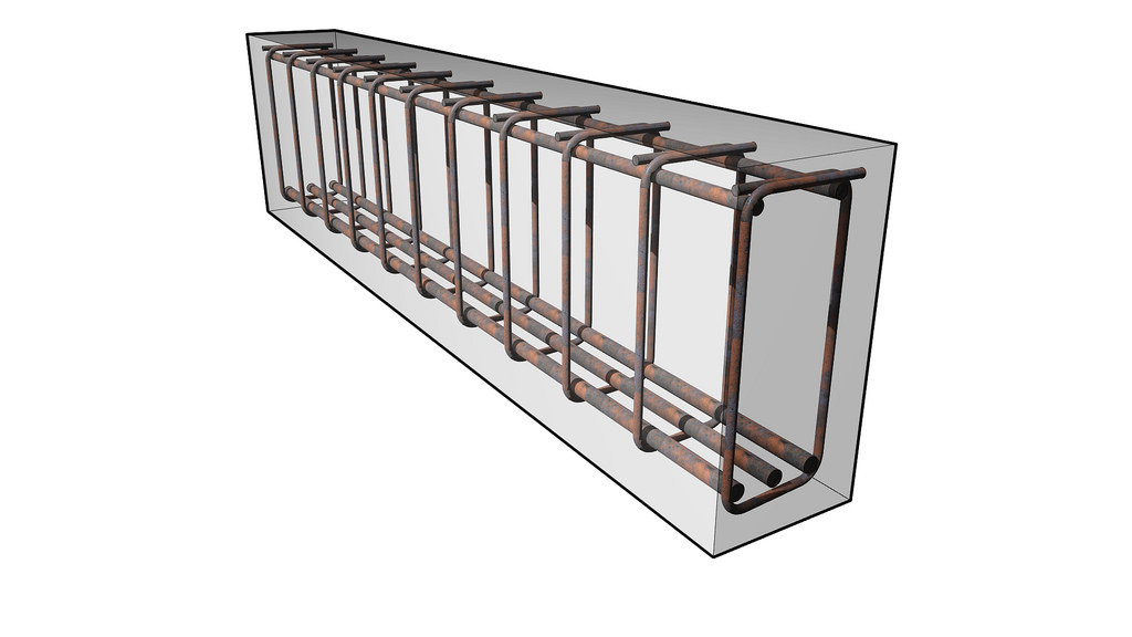

I would not use it for a beam without a lot more info. See picture of a concrete beam.
/ Concrete strength #12
I have a chance to get some concrete that is 1 foot square, with 4 pieces of 5/8 rebar in it. It would span 7 feet over a drive way to let water under. Any idea what those concrete pieces would carry in weight. There would be 9 of them but the tires would ride on just two of them.
NOPE, 4 pieces of longitudinal rebar do not a beam make. There needs to be stirrups to prevent shear cracks from causing a beam failure.
