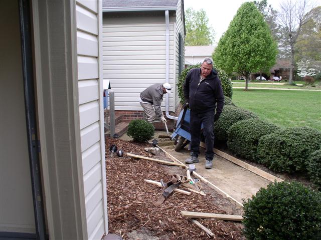

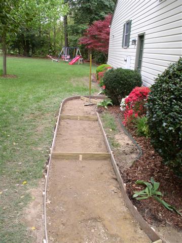

I am trying to build an exposed aggregate concrete walkway joined to an existing driveway. The driveway slopes on one angle, and the walkway will have to share that slope as well as slope(on another plane) away from the house. I am trying to figure out the best way to make this look great. I would love to find a site with directions, and especially pictures. Any suggestions on the whole project as well as websites?

To gain experience, I would buy or get a thin sheet of masonite at a building supply. It's inexpensive. Cut a 3.5" piece off the 4' or 8' length, unless you already have some. Bend it in a complete circle off the 4' end or 8' length, and fasten the ends together with nails or screws with adequate overlap. Get small bags of ready mix to test your skills! Pour the mixed ready mix into your circle form, on a hard surface, let it set up for a little while based on temperature. You also don't want "too loose" of concrete. Seed the aggregate, grade it level to your form. Don't trowel below the surface if you want to walk barefoot on it? Again, let it set up longer this time because you will be exposing the aggregate with a garden house! Go with very lightly spraying at surface level, barely exposing the aggregate! As it starts to dry harder, and you want more exposure, spray lightly again. It may take you several tries, but the knowledge builds fast. If you are doing it by yourself on the sidewalk, I would just try one section per expansion joint, until the confidence builds? Also those round practice slabs won't go to waste; they can be used in gardens, etc. You can practice with different amounts of seeding for your satisfaction. Hope this helps?

Not having a lot of luck looking for step by step directions online. From what I gather, I basically need to just keep working the forms until they are right and then go to town, right? One end is lower than the other, should I start the pour on the low end and go to the high end?
   / concrete walkway project #5
You may want to invest in a good masonary book from Home Depot or Lowes; the books include a lot of expert advice.
I would set the mixer up at a convenient location, and decide from there; the start and finish point to make it easy on yourself, the slope shouldn't be a factor. Are you mixing the concrete, or is this a redi-mix truck? Transporting concrete is a back breaking job with a wheelbarrow! Also I would recommend some 3/8" rebar for added strength!
How long and wide will the sidewalk be? Is the pour going to be done completely in one day? Slope on the side for rain runoff can be 1/4" per foot to prevent standing water.

I will be having a truck deliver around 3 yds, plus a little since you never get it all out of the truck. The dimensions are 50 ft long by 4 ft wide. There will be radiused turns on both ends with straight sides. I wasnt intending on reinforcing the crete as it is just for foot traffic. My current problem is trying to figure out just how level the bottom surface(under the crete) needs to be. I wanted to maintain 4" thickness throughout, but the lay of the land makes me want to consider allowing it to vary between 3" and 4" to minimize ground prep. Is this okay?

Reinfore it! Foot traffic won't break it the shifting of the ground will! Rebar won't stop it from breaking it'll keep it together. My opinion is 2 bars the entire length with some from side to side, about every 3' apart. make the rebar look like train tracks with crossties. Either way it's a must.

If you are having a redi-mix truck deliver 3 yds of concrete; they will not pour the concrete out of the truck at your convenience without holding financial costs! You will need experienced help for a nice job too; or the following week you will be renting a "jackhammer" and starting the project over!! The seeding, expansion joints, and finishing job requires extra time too, and doing the job solo will result in a disaster; this is my opinion only!
The thickness can vary, depending on the compaction of the soil. Rebar will help prevent cracking there, and how much future weight may go on the walkway?
