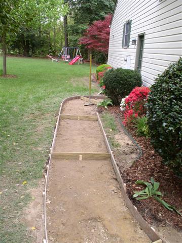

Thanks a LOT for that well articulated response. I appreciate it. I have done basically exactly what you described. I have the forms(2X4) set and staked every 1 to 2 feet. The stakes are below the tops of the forms. I used masonite for the radiused corners. The depth varies between 3 and 6-7 inches. I am waiting on weather to pour. Again, thanks alot for taking the time to reply as well as you did.

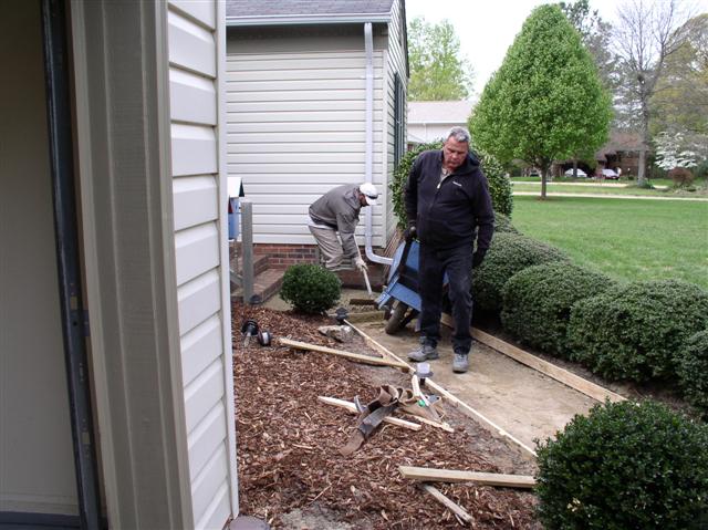

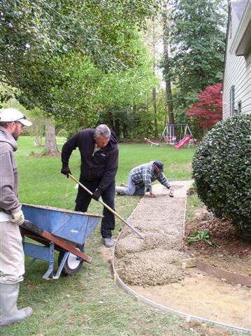

These guys don't even use a screed board they just fill the section and hand trowel. The key to cracking is the hydration rate or curing rate. I cover mine in plastic for 7 days and keep it wet. Very slow cure.

Glad I could help some. Sounds like you are off to a good start. On your areas that are too deep sand is much cheaper than concrete.
