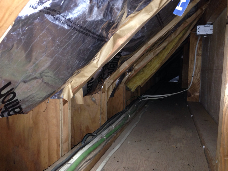

I got int the knee wall on the opposite end (east/right) today. All wood was dry. It appeared as though the insulation either never went down to the soffit or was trimmed back at some point after construction.

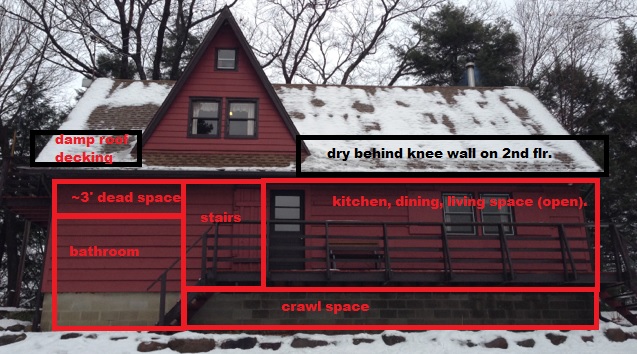

The bathroom is in fact under the damp area. The damp wood was on the front and back of the cabin although the bathroom is only on the front portion. The ~3' space above the ceiling of the bathroom extends to the room behind it. (Both rooms are on slab vs. the rest of the living space which is above a crawl space). I suppose moisture could have migrated through that ~3' space to affect both the front and back. The bathroom does have an exhaust fan that is vented through the west end wall of the building. Remember that in these two places the fiberglass insulation extended down to the wall below unlike the east end where it did not (and the wood wasn't damp). Here is a very rough layout sketch from the front:
   / Condensation in eaves with non-vented soffit #15
Well, best thing to do now, with the damp insulation out, is to monitor the situation and see what happens I think.
My best guess is it is either moisture from the bathroom migrating through the 3' ceiling area, or that side of the dormer leaks. Moisture will migrate through painted wallboard, wood, etc. Most bathroom fans eventually clear shower steam but are generally on the wimpy side in terms of cfm's.
You could lay plastic down on the 3' knee wall floor for a few days, check it for condensation on the underside.

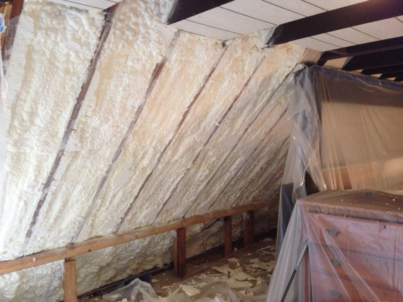

Well here we are in the spring. We decided to rip out all of the paneling and fiberglass insulation and have spray foam and drywall installed to address our issue. After monitoring and thinking all winter, I decided the issue wasn't a moisture leak but just inadequate insulation. Most all of the roof deck was frosty on the underside at times because the insulation was way weak to keep the hot air in and the cold air out, so the dew point was reached. Lots of ice dams on the shady side of the roof. So after quite a bit of research, we went with open cell foam from the soffit to the peak, including the gable end walls, dormers etc. essentially everything above the first floor. We will also be replacing all windows with Andersen 400 series. And then some work in the bathroom including foam on the outside walls, drywall, tile floor with heat below it. Definitely some $, but it's time.
