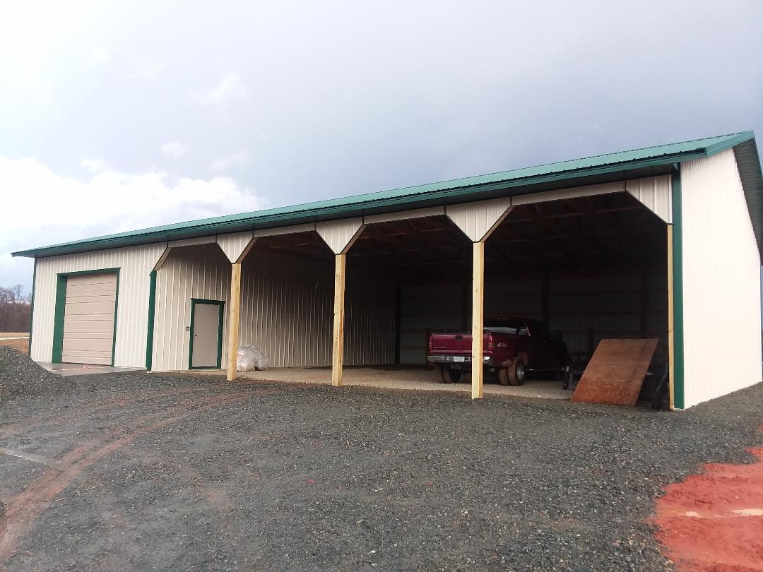

I know there have been several threads on condensation with metal skinned buildings. I just framed a 42x72. Should start roof end of week. The first 24' is an insulated shop. R19 walls and R30 in ceiling. Metal ceiling, bottom 8' of walls will be 3/4" plywood and upper 5' metal. Exterior of walls I'm going to use Tyvek under the metal. What should I do about the roof? Use Tyvek or roll insulation to prevent water dripping on the ceiling insulation? Should I use a plastic vapor barrier on the interior? The shop will have a mini split.
I have 2 more lines up after this one. I want to provide a good building for my customers so they don't have future issues.

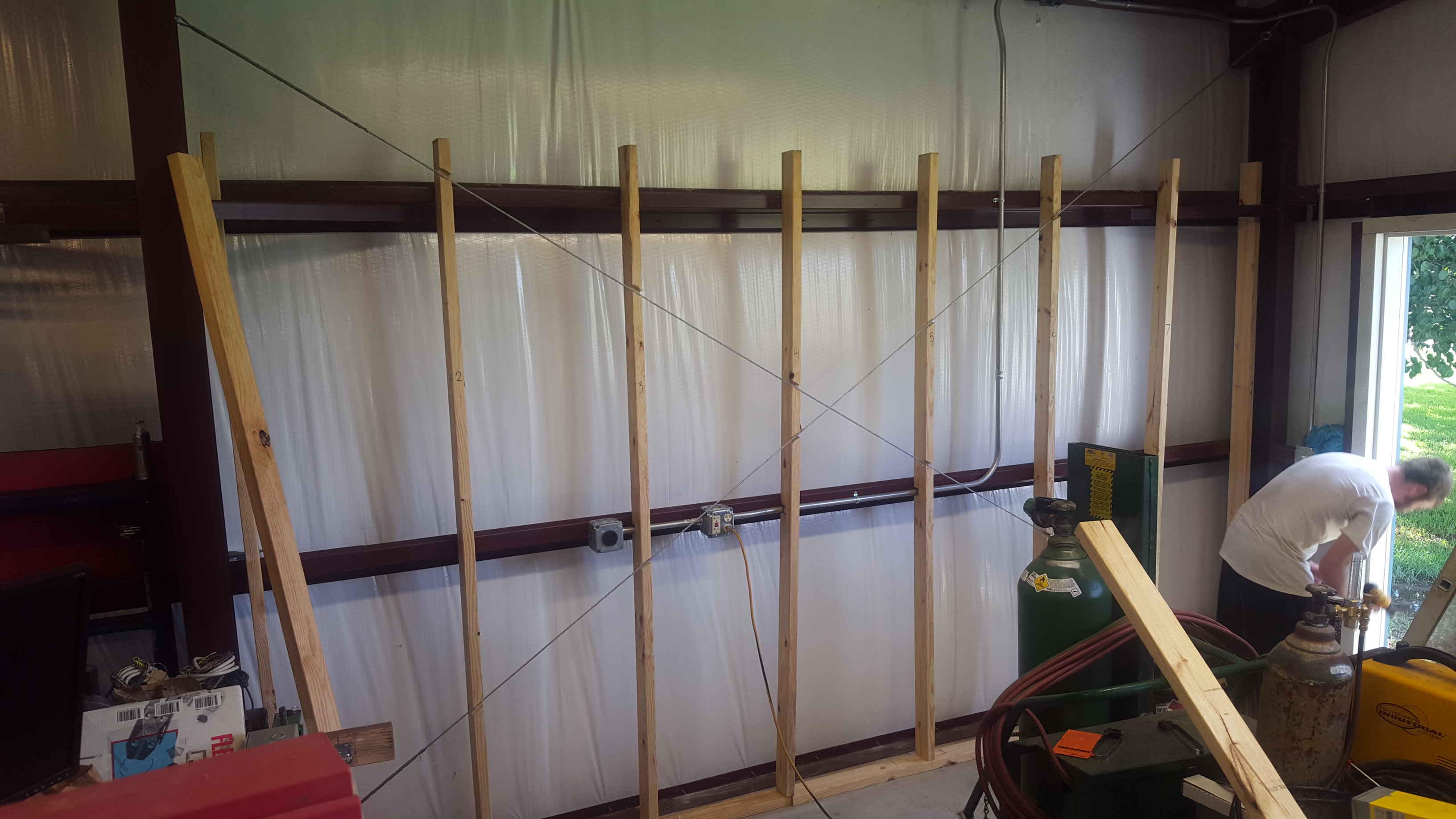

I accept that your statements are rooted in a science that I don't understand, and I'm not being contrary; I'm being inquisitive. I want to understand why my experiences do not match what you've described.
I had my shop built by a contractor and I just told him generally how big I wanted it and what I planned to do with it (build insulated interior walls and air condition the whole thing) I let him specify the particulars of the building. I did not do much research about condensation or anything. He asked if I wanted him to put the typical insulation that metal buildings have, and I said yes. I figured double insulation down the road couldn't hurt (see attachments). What he built is a 30x30 metal building with 11ft eaves and 14ft peak. It has roll insulation between the purlins and the exterior metal R-panel. There are no ridge vents or soffitts. The R-panels are sealed with foam strips at the ends.
It has zero ventilation that I know of and it does not condense. I live south of Houston TX, about 15mi from the ocean, and it stays ultra humid here year round; usually hot, sticky, and gross. I have never once seen a single droplet of condensation inside. My tools and metal stuff have been sitting inside for 3 years with no climate control (have not yet gotten around to installing A/C) and I have no surface rust. How is it that in the absence of ventilation I have no condensation problem?
Is the answer maybe that the condensation is occurring between the R-panel and the roll insulation? If so, is that bad? Does that water have anywhere to go? Or does it just sit there slowly rusting my panels away from the inside where I can't see it? Also, will building my insulated interior walls mitigate or exaggerate any unseen condensation problems?
P.s. the attached pictures show the first interior wall which I built last week. For 3 years it has been insulated solely by the roll insulation between purlin and R-panel.

You have a situation where the inside of your shop never falls below the dewpoint. Probably stays warm in there all night with extremely small air exchange. Surfaces stay warmer than the air than night air. You are lucky in this. Hard to know the safety margin you have, but Id guess youd go beyond it if you had a cold day - cooling everything in the shop - followed by a warm rainy night.

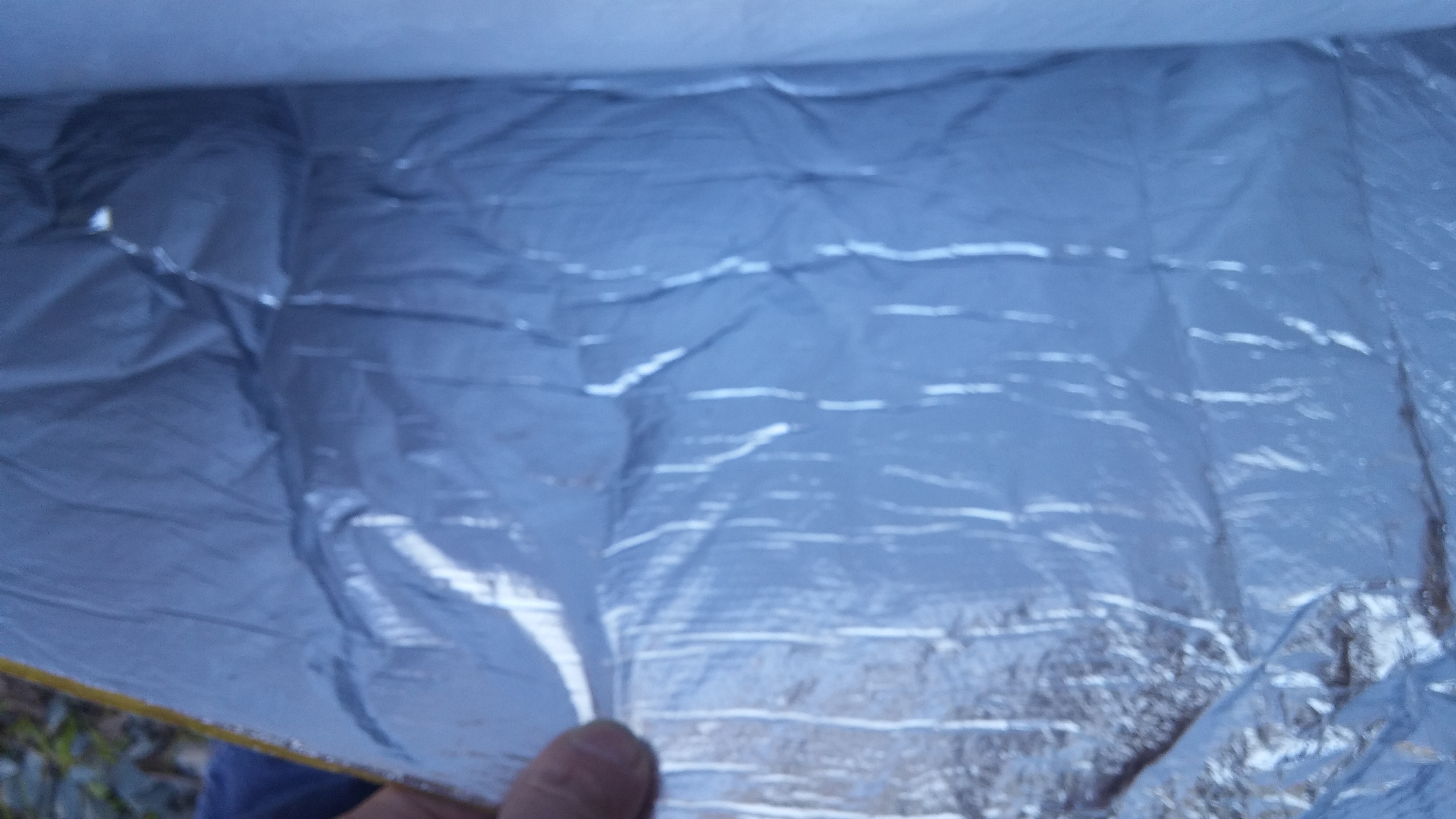

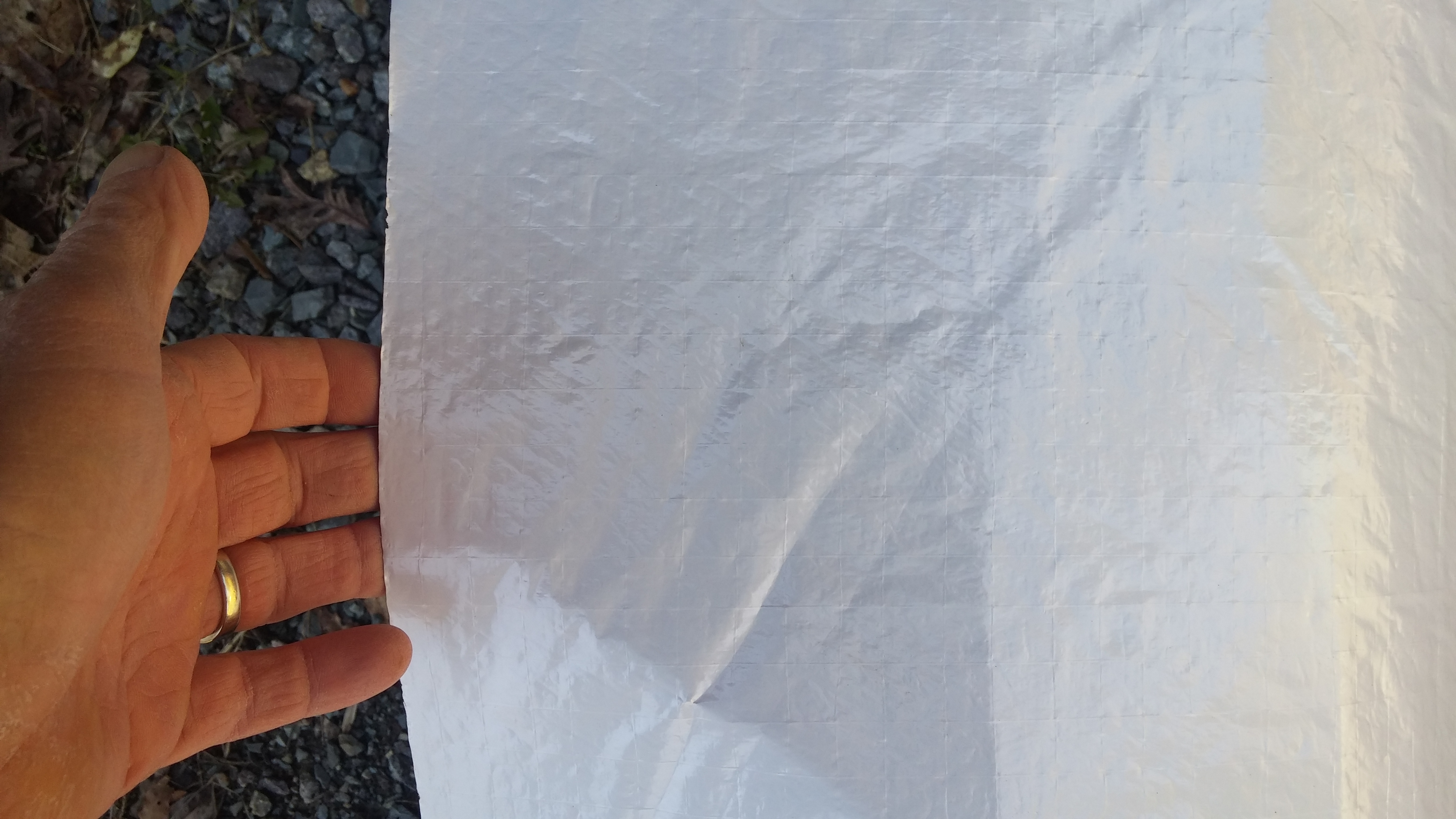

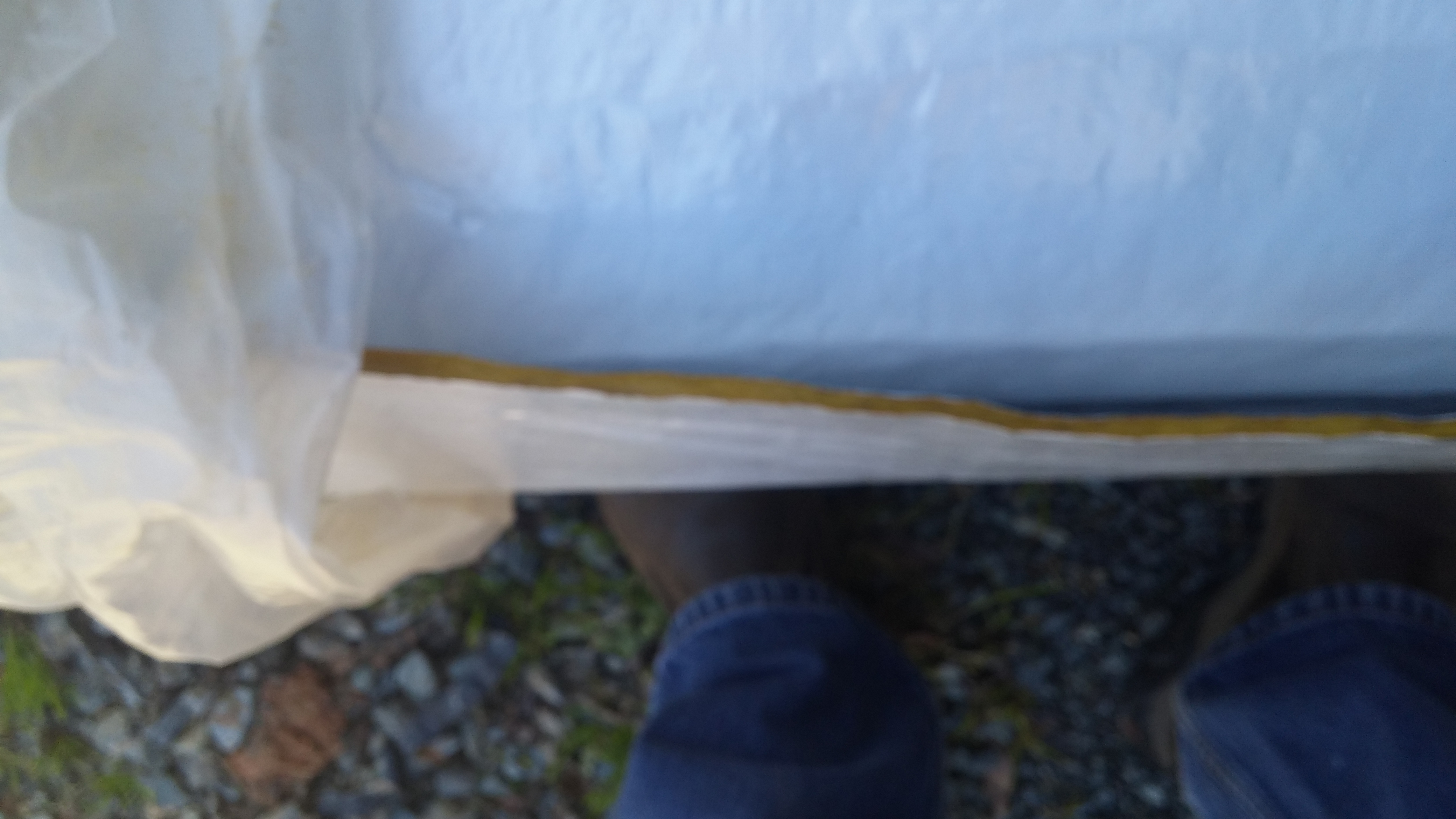

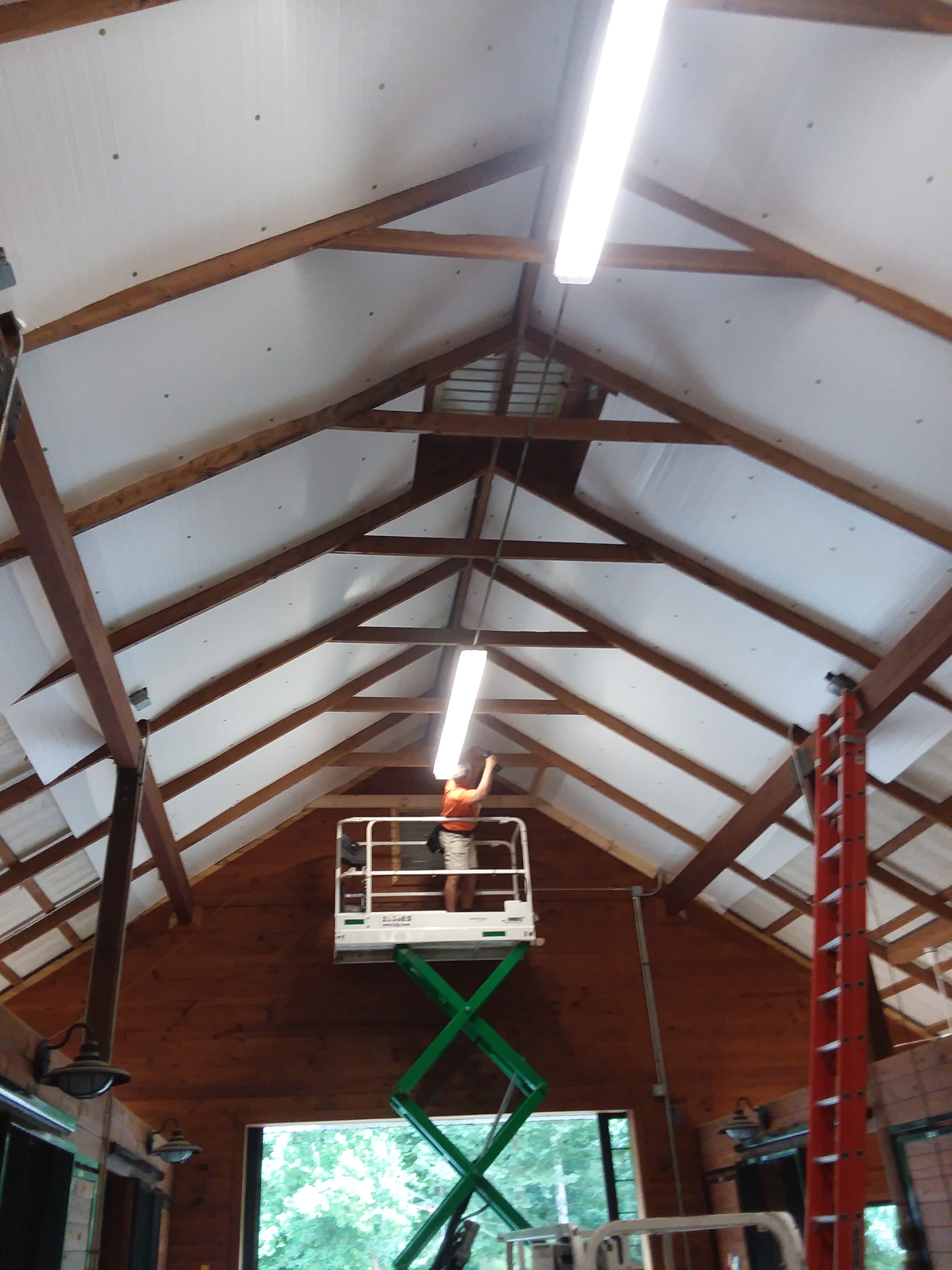

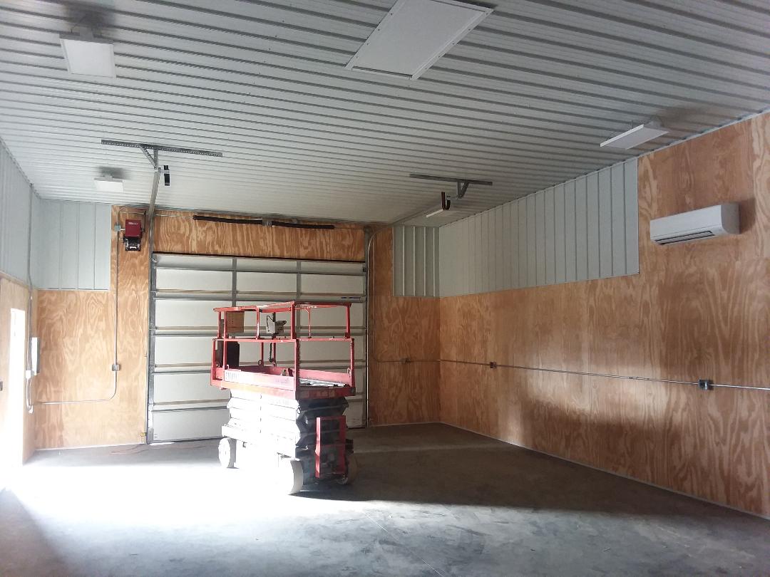

Only issue I have with spray foam, if you have to remove the building material or have a leak you're screwed. It will have a ridge vent. I think I might add the roll insulation in shop roof area to be safe. I stopped using the bubble wrap because it deteriorates over time. I was at a customers last weekend where I used the both sides foil bubble wrap and it was still good after 14 years. The other barns where I used the plastic/bubble/foil has all deteriorated.
Picture of the current insulation I'm using. Its 6'x125' and its $350/roll.

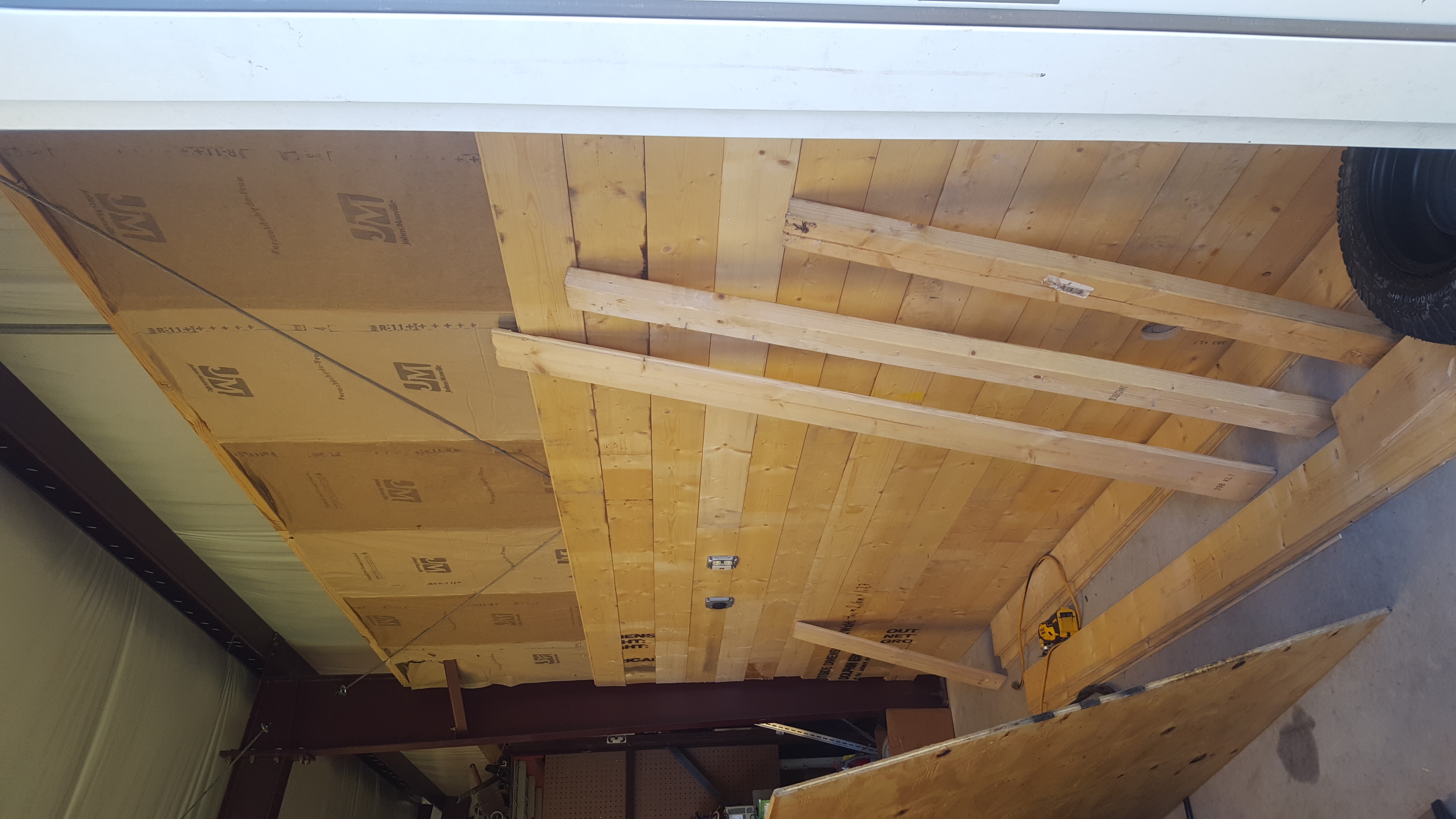

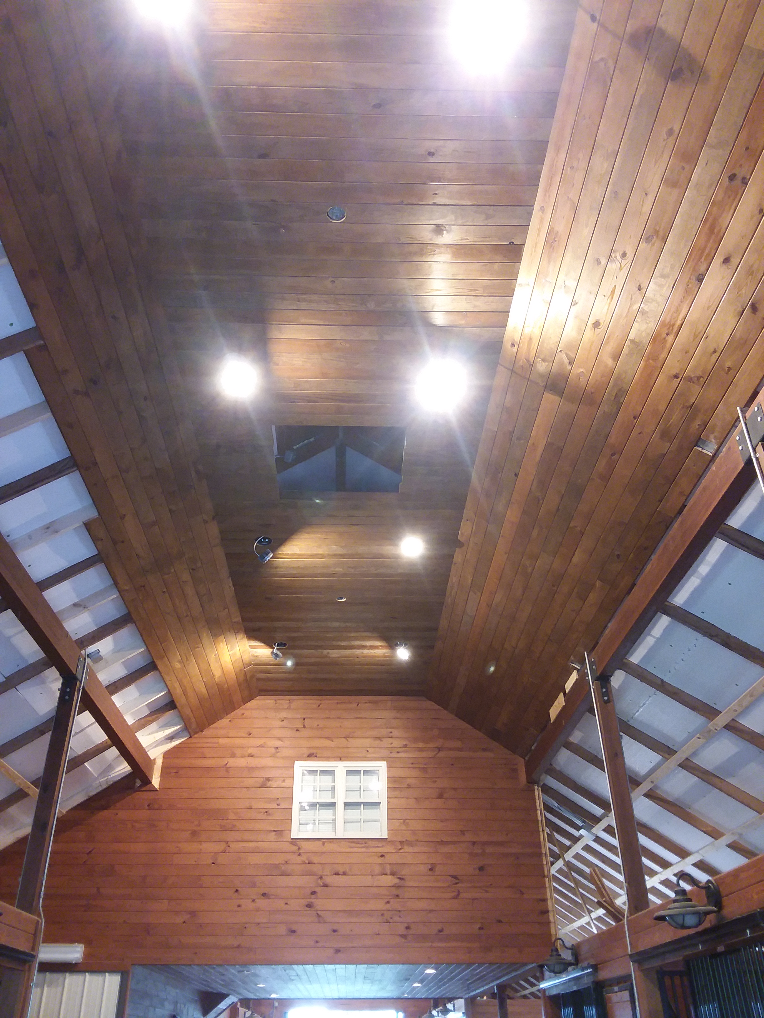

This is one where we just put in a ceiling to cover the old.
