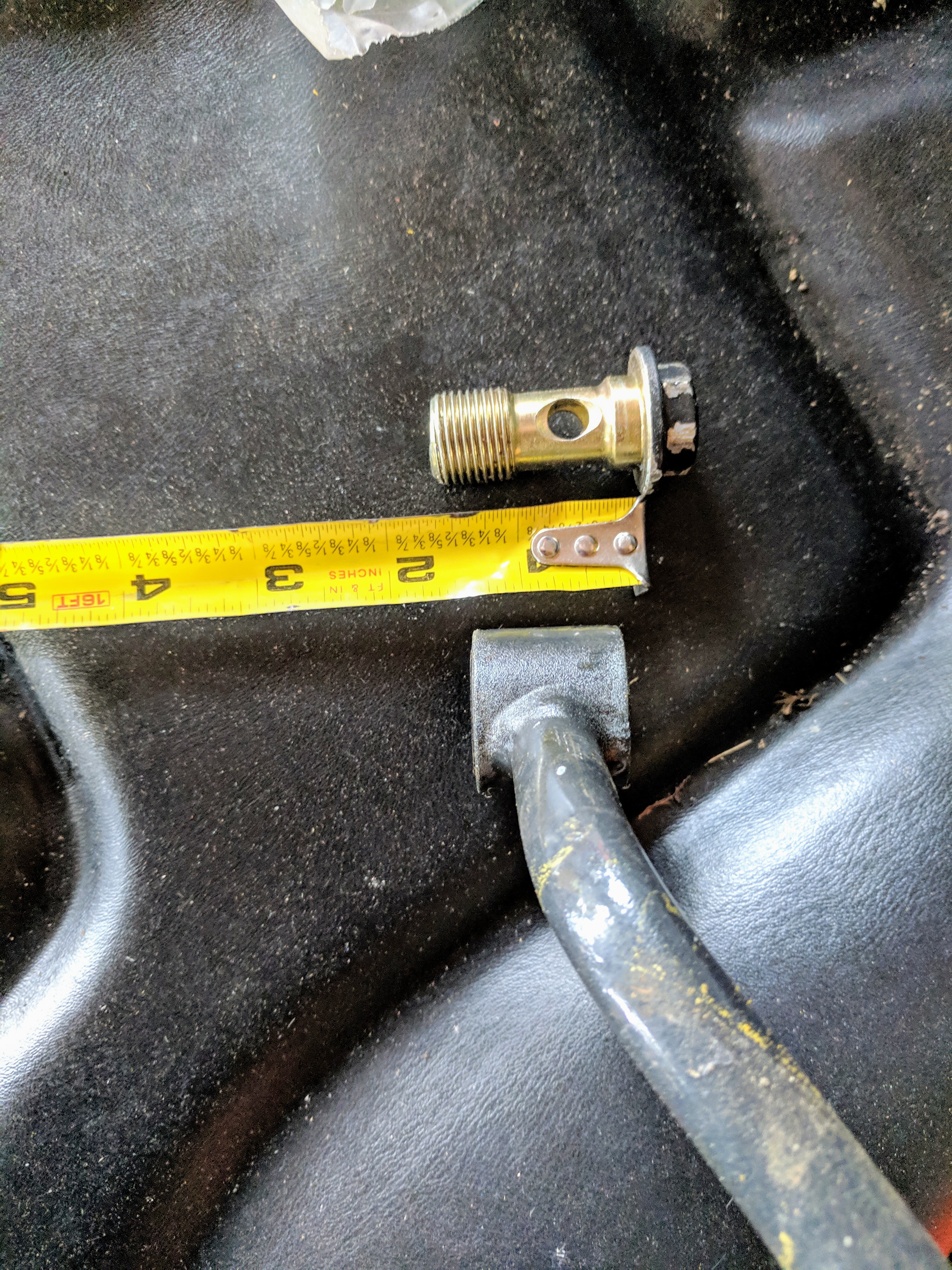

Confirm I'm doing it right. Adding 3 spool for remotes
   / Confirm I'm doing it right. Adding 3 spool for remotes
#21

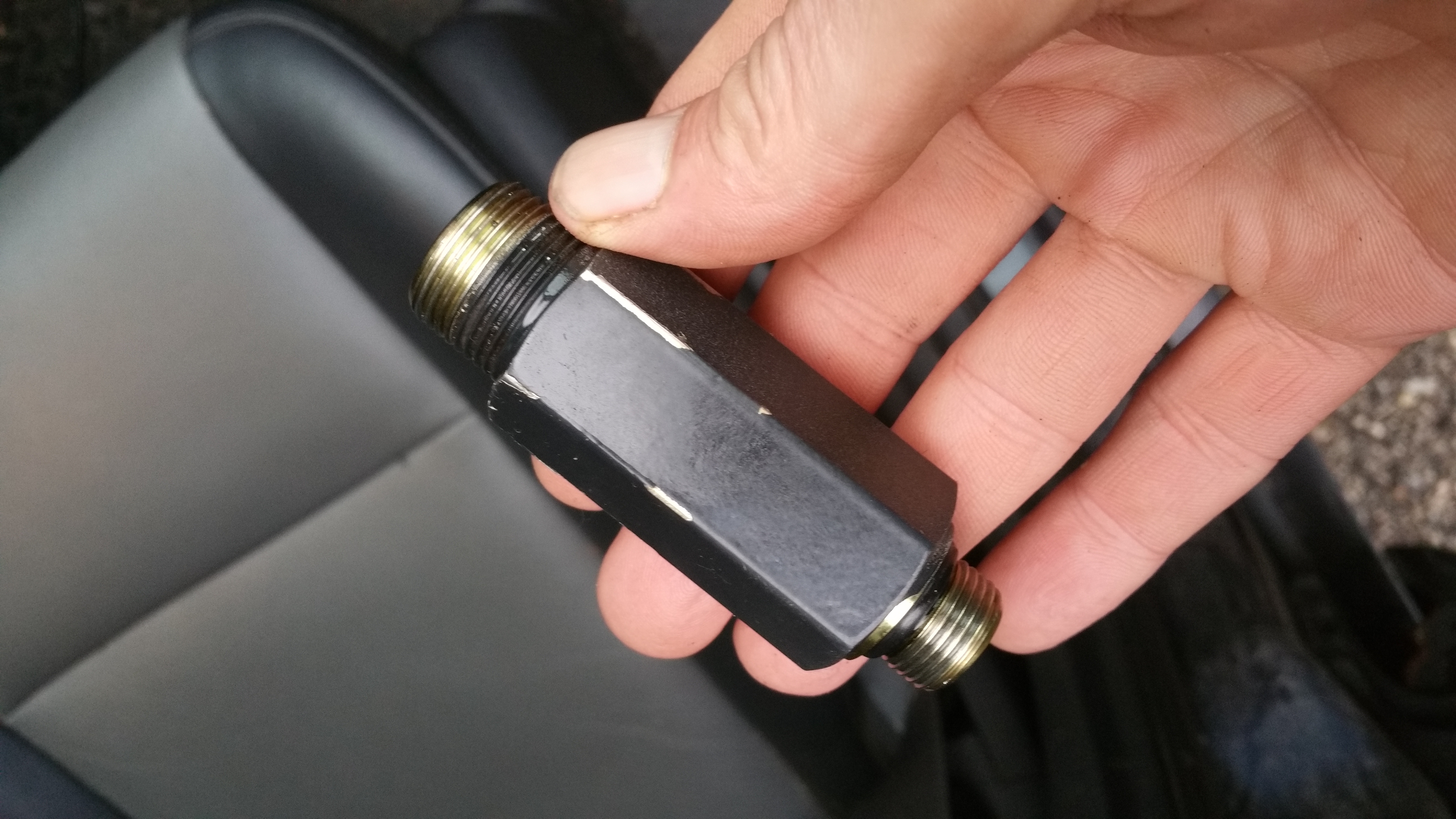

As tomorrow doesn't look like a good day for working I pulled out the connector that is between the hardline at the back and the 3pt. Going to take it to a hydraulic shop and see what they can do to marry it up. I agree that trying to match up something to the end of the hardline could be tough but if I can leave that connector in the hardline and then add a line onto the other end of the connector that would take care of that little challenge. Here's a pic of the connector:
If the shop can match up the end by my little finger then that's that problem solved, the return line I want to T into is a 12.5mm inside diameter so hopefully that's something they can find a T for. Then the fun part begins trying to size up hydraulic lines... Lol.
E.

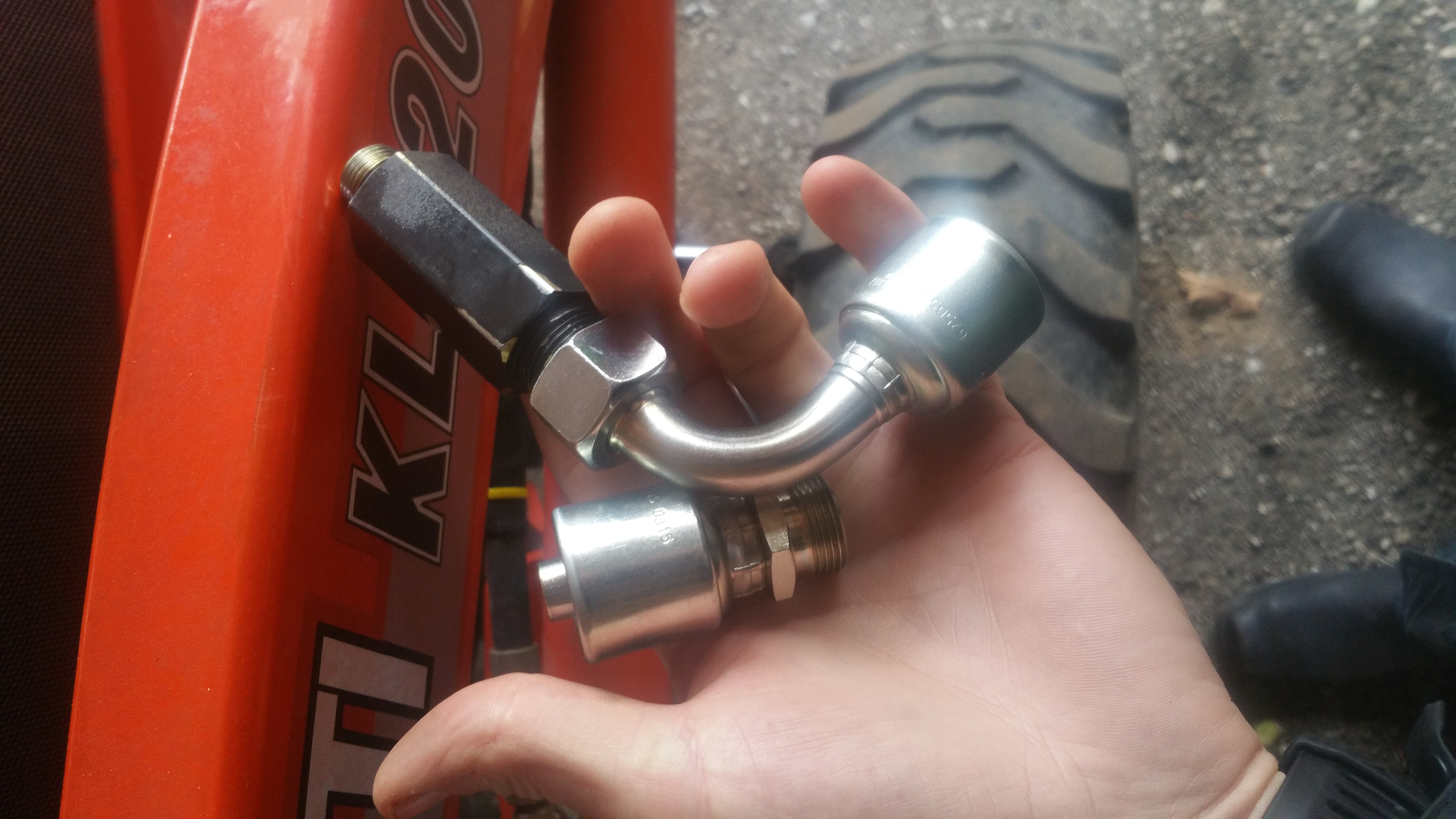

Here's another vote for finding a good hydraulic shop when doing this kind of project!!! I took the connector pictured in my previous post and much to my surprise and pleasure they had adapters to hook onto my hardline end!! So I've now got a 90 to go from the above pictured connector back to the new 3 spool, and an adapter to go from my hardline to a hose to the 3 spool.
The adapter near my thumb will connect to the hardline.
I really thought connecting to that hardline would be impossible to figure out but that turned out to be easy, which is a big bonus as that means the connector that was between the hardline and the 3pt can stay in it's original location - anything else would have been very difficult to try and attach because it's tight in there, that connector being long allows for a socket to get on it easily.
So onto the next step - build the bracket to hold the 3spool and the remotes. Then I'll go back and with measurements for the hoses. Oh and getting a T for the return line to tank was a no brainer as well.
Once again thanks all for your help, when I originally started this project I didn't think doing it this way was going to be as easy as it's shaping up to be.
E.
Man did you ever get lucky. Both ends of the hard line on the CK35 have these Banjo style fittings.
Glad your project is coming together well. Nothing beats having a good hydraulic shop locally, you might spend a little more over internet prices, but the knowledge you have access to is priceless.
