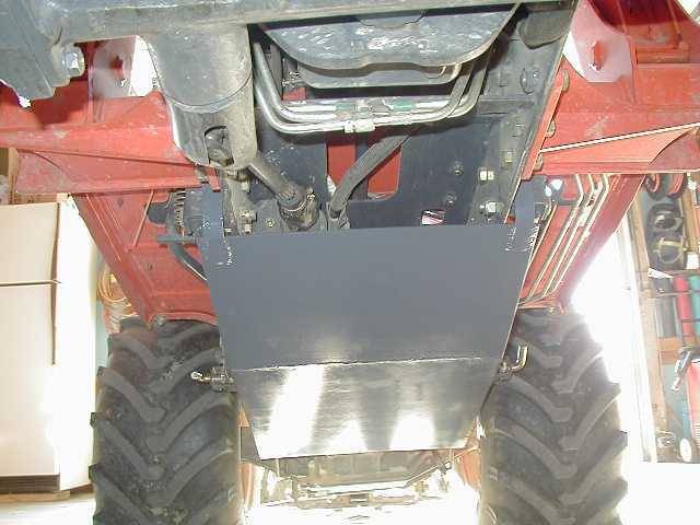

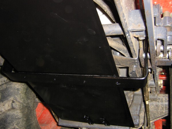

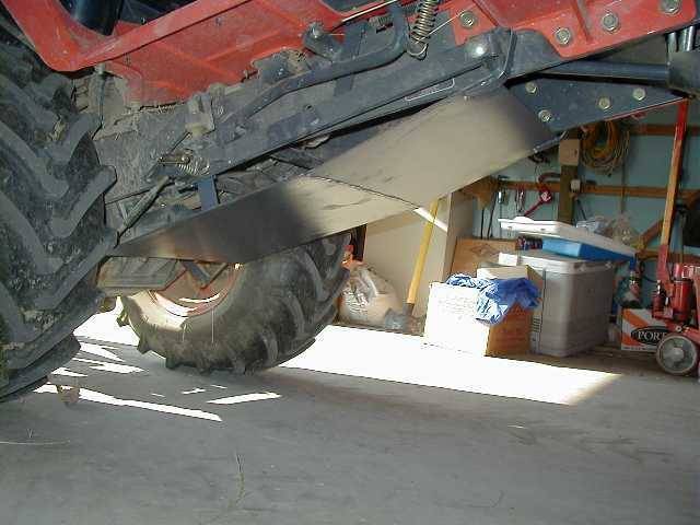

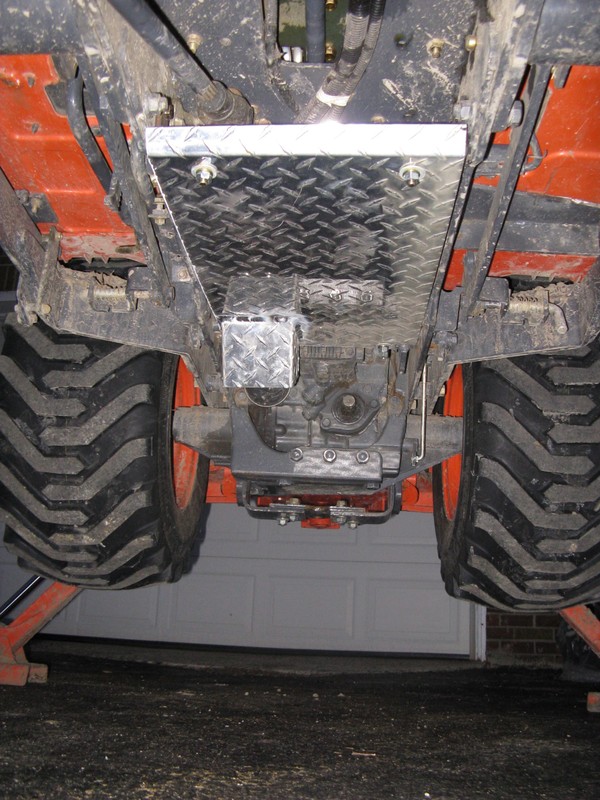

   / Confused About HST Fan Protection #17
   / Confused About HST Fan Protection #18
with the exception of the pic posted by bp fick it looks like the majority of the skid plates are directly blocking the air flow to the fan

bp fick- you said it appears to be welded on? are you sure ? From the pictures it looks like you gonna have a bear of a time trying to replace the HST filter. the picture looks like there is only half inch or so to pull filter out and put in?
BotaBX24er- The first pic of skid plate with diamond plate looks really good. I like that one the best, however , I would have made a door of some sort for the filter so I wouldn't have to remove the skid plate to replace the filter.
shownuff- I believe adding the skidplates would create a tunnel effect airflow with air coming from the front driveshaft area. I could be wrong , but i can envision that happening.
