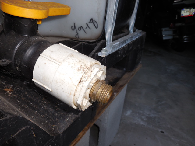

   / connect a hose to an IBC tote #18
I also found an adapter for my tote. Volume through a water hose is no problem; you'll have plenty of pressure. Here's a picture of my adapter. DSCN0225.JPG

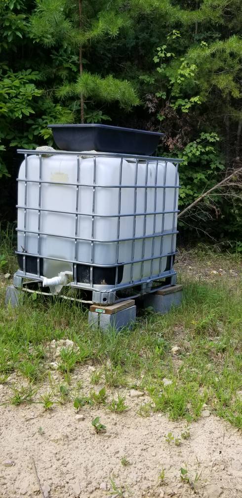

   / connect a hose to an IBC tote #19
This is what I have for water supply in the back 40. Bought a rubber tub and put a kitchen sink strainer drain in it. So when it rains it goes straight to the tote. 5 gal. bucket fits under the spigot.20180827_170752.jpeg
