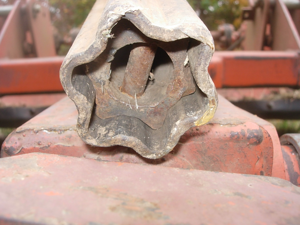

I need to unplug the dirt, pull the shaft out, hammer out the now broken pin and replace it.
It looks like the pin itself has sheared. There are two tips visible on the yoke side and when I look inside the compressed shaft, I see the middle of the pin.

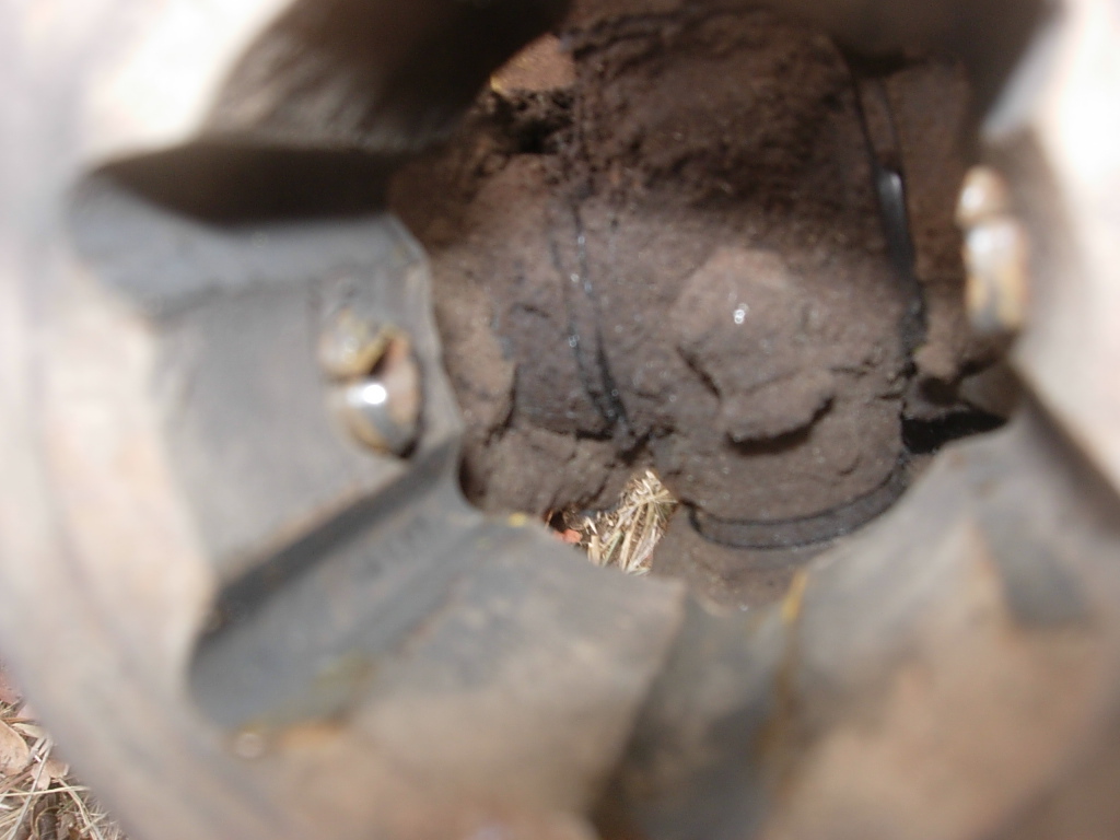

I'll try to get a picture of the roll pin. I looked inside the yoke and ....how to describe this...
The yoke is let's say, a 2" hole. The outer part that the shaft inserts into is let's say, 1/4" thick. On the glance I took last night with a flashlight in hand, it looked more like the roll pin was cleanly cut inside the yoke. It should be VERY easy to punch out the little 1/4" pieces that are stuck in the holes of the yoke. I really expected to see more...how to say... strech marks? Meaning, where the shaft might have been pushed or pulled and bent the roll pin as it broke.
I've got my digital in my coat pocket here at work. When I get home I'll try to post a pic of it if I can (before we go out for a family dinner)
