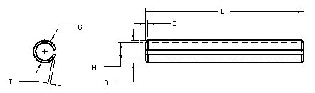

I just hung up with Rhino technical help. He says that their term for a coiled piece of steel as a pin is a "spiral pin". A rolled pin is more like a letter "C". A tube with a slit in it.
Ok.. now we can at least get some semantics down while talking.
He says a rolled pin and not a spiral pin is indeed, the right part for this attachment point.
He also said the likely culprit was lack of grease on the shafts....(kudos to Soundguy!!)

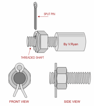

OK i dont know where the guy in rhino learned his stuff but the correct name for that pin according to the US Navy and the US Air Force is a roll pin.(the one that looks like you took a piece of steel and rolled it up to the correct diameter and it has layers) The correct name for the one with the cut is a split pin. Either way you are going to be sure to get the correct part. If it is a split pin you can get those at any hardware store if you need one before rhino sends you one. the cost pennies to buy.
   / Connect PTO shaft using pin or bolt? #24
Interestingly enough a split pin is what holds the yoke on my star shaft direct from john deer. I'd check the length of the shaft.. and then get it cleaned..
soundguy
