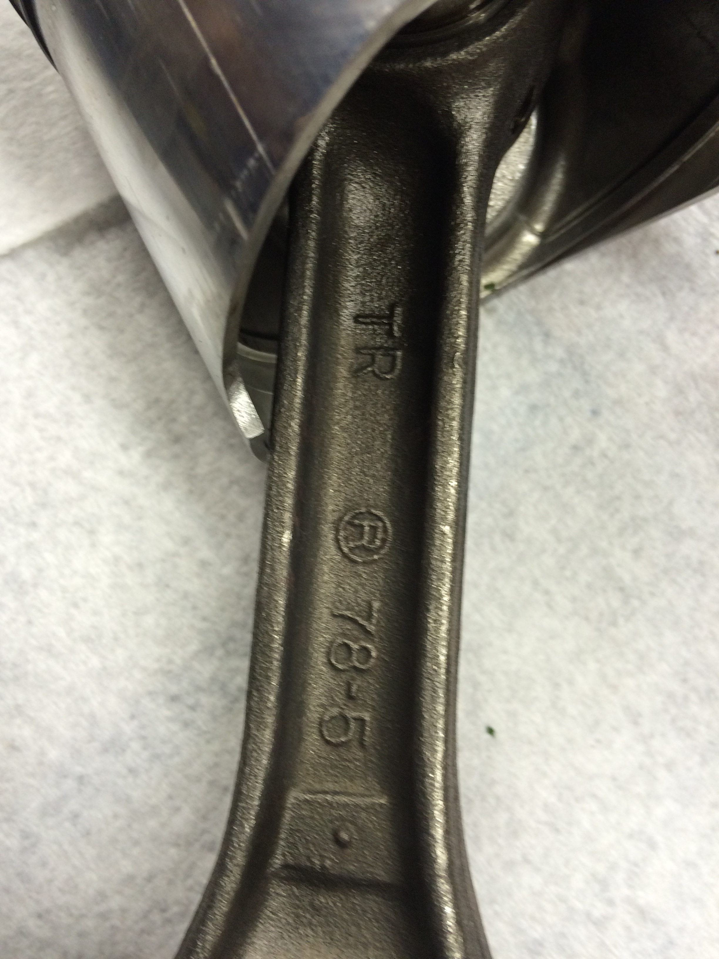

The rod part number is CH10683. Beyond the part number each rod has a casting number on the rod. I believe only rods from the same casting number were installed on each engine. Was this to introduce some very basic, crude balance to the assembly? I'm not sure.
Here is a pic of an original rod. I believe the casting number 78-5 indicates this rod was manufactured in 1978 and was the 5th batch.

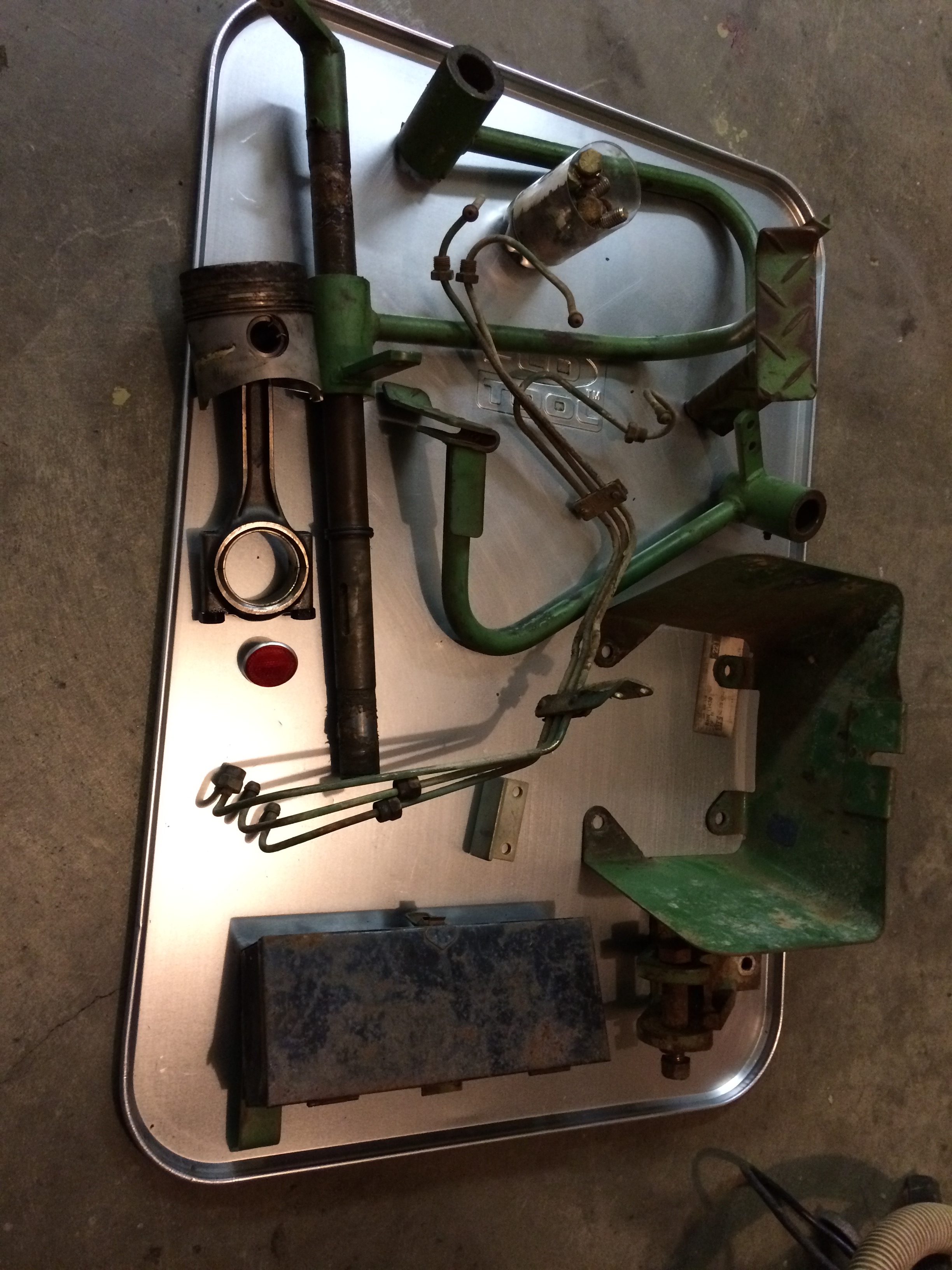

This is the best image I have with me of the replacement rod. It came out of a 950 and is dimensionally correct. The casting number is different. I'll have to look at it tonight but it has a boss with 94 stamped on it. I'm assuming this is a much later rod.
As far as overthinking this..........I've been accused of that before but I don't think that is the case here. Understand that I'm not trying to build a "balanced" engine, just wanting to make sure I'm not using components that are far beyond a reasonable out of balance condition. I will try to reweigh the rods tonight and report back the results.

Weighed the rods tonight. The 78-5 rods are original and the 47-2 is from the salvage yard.
Total Crank end Piston end
No. 1 (78-5) 2# 137.5g 1# 207g 445g
No. 2 (47-2) 2# 154.5g 1# 215.4g 455g
No. 3 (78-5) 2# 131.8g 1# 205.5g 439.4g
Total difference 22.7 grams
Crank end difference 9.9 grams
Piston end difference 15.6 grams
I am surprised the larger difference was at the small end of the rod. Should be able to help that by weighing the pistons. If I do that I think it looks ok. What do you guys think?

An interesting development in my quest for rods which are reasonably close in balance. I’ve been studying the parts diagrams to see if the 1050 uses the same rod because the salvage yard has a 1050. It appears the early 850, 950 and 1050 all use a CH10683 rod and the later machines all use a CH10682 rod. I need a CH10683 but am starting to wonder if my salvage rod is a CH10682. It is dimensionally correct but a touch heavier. Hmmmmm. I don’t suppose anyone knows the difference in the early/late rods or engines?

The 682 Rod was used on the early 850 and all late models. Still don't know what the difference in the rods is. Went back to the salvage yard today and found a Rod that is very close in weight but a different casting number. I'll have to inspect it but I'm pretty sure it is my solution. After all, even if I buy a new Rod the casting number isn't going to match.
